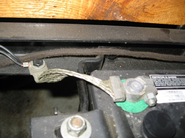

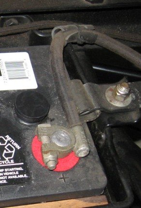

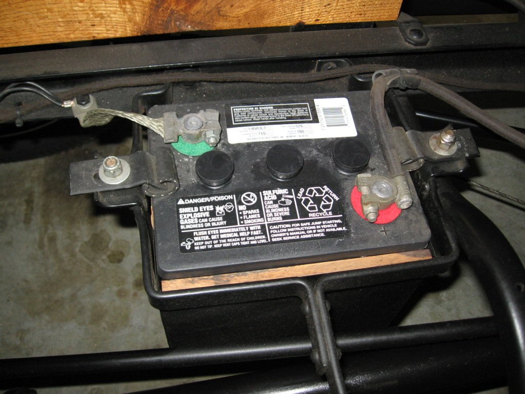

Pat .... It would be physically better to remove the battery and then reinstall with the negative terminal closest to the frame rail, reconnect cables to battery, install battery, hold downs and enjoy your ride.
