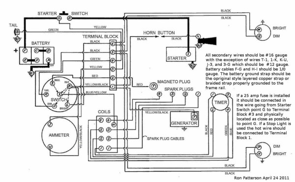

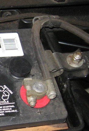

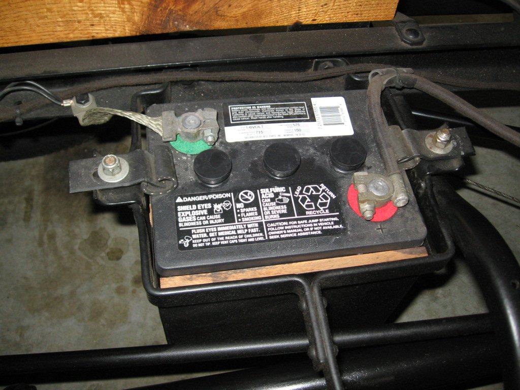

Hope these online pictures are helpful.

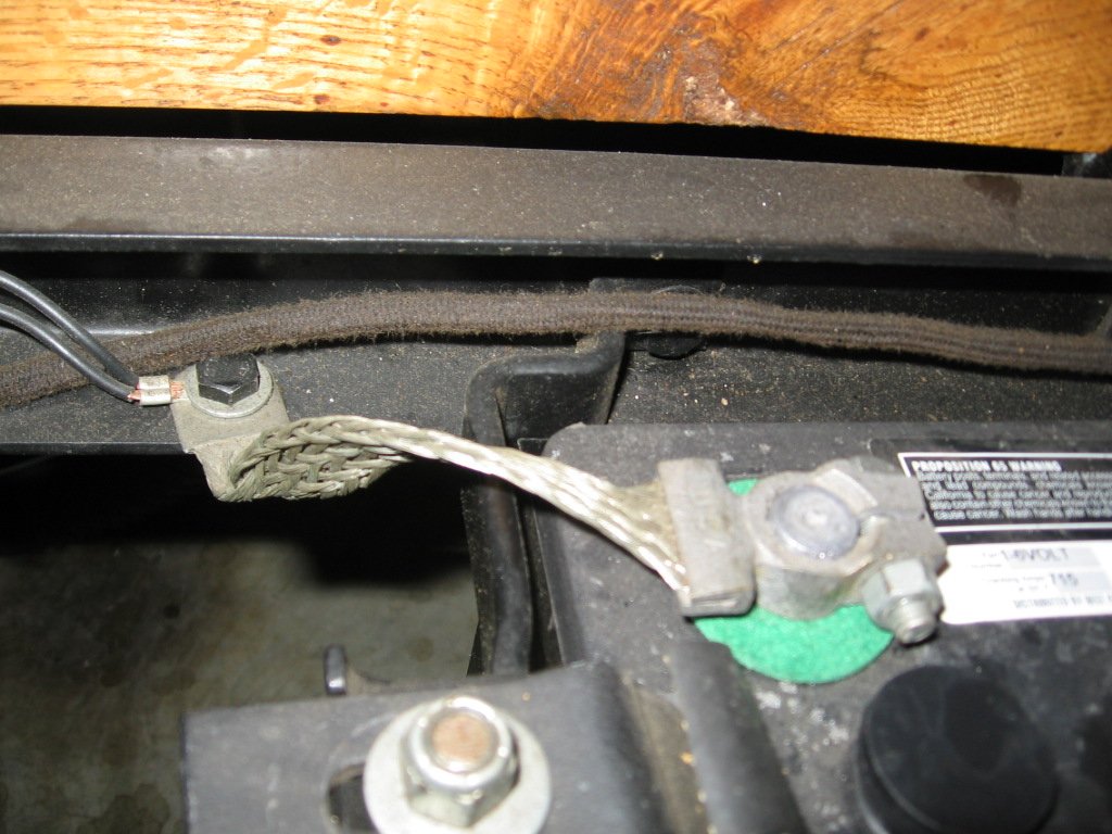

Post by Moxie26 » Wed May 14, 2025 5:35 pm
Close-up on positive terminal starter switch cable

I do not have any questions about wiring the connections in the car and have no disagreement with Ron's diagram. The connections I am referring to are on the internal high voltage secondary windings inside the coil boxes which are not shown on the diagram.
