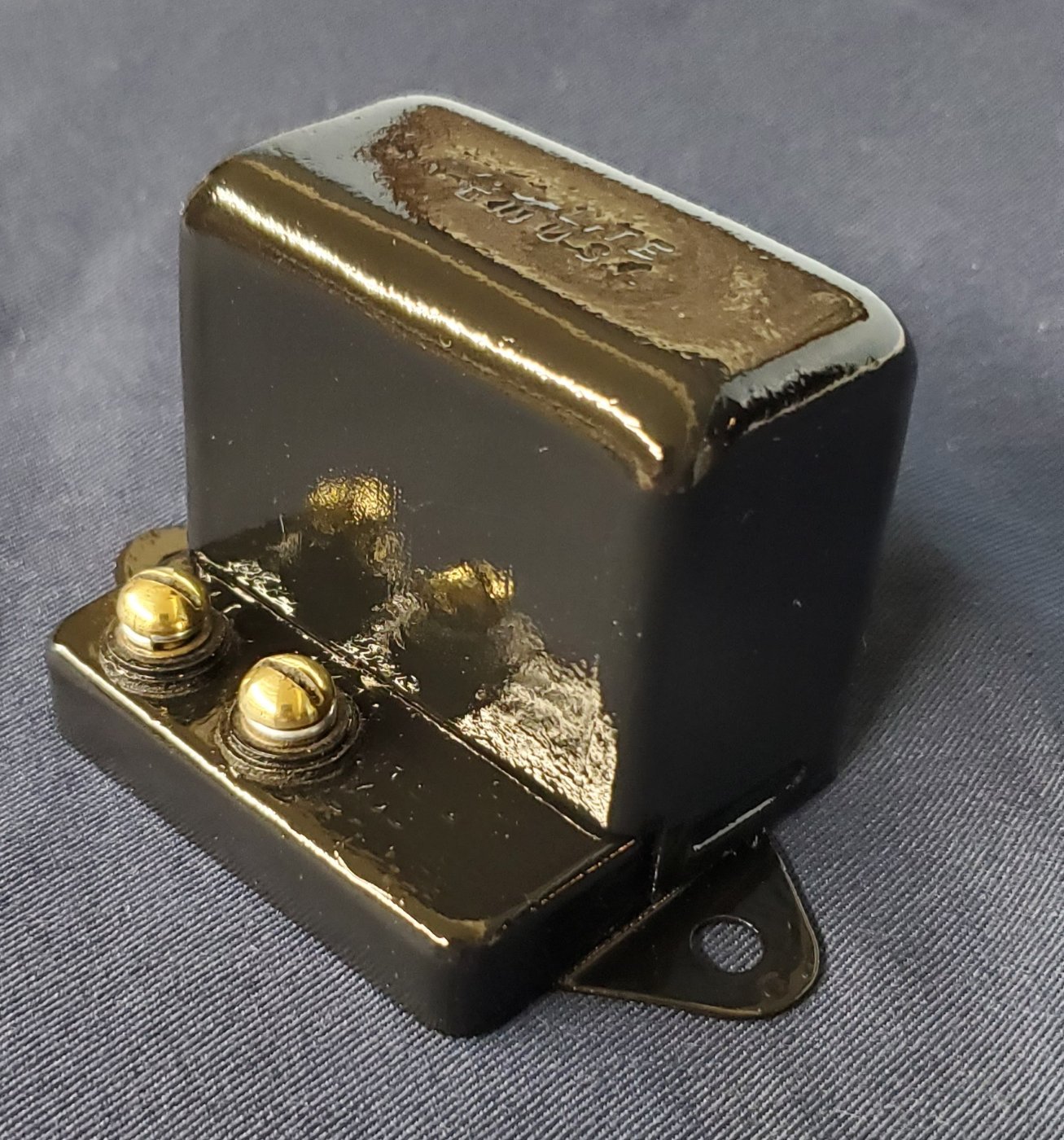

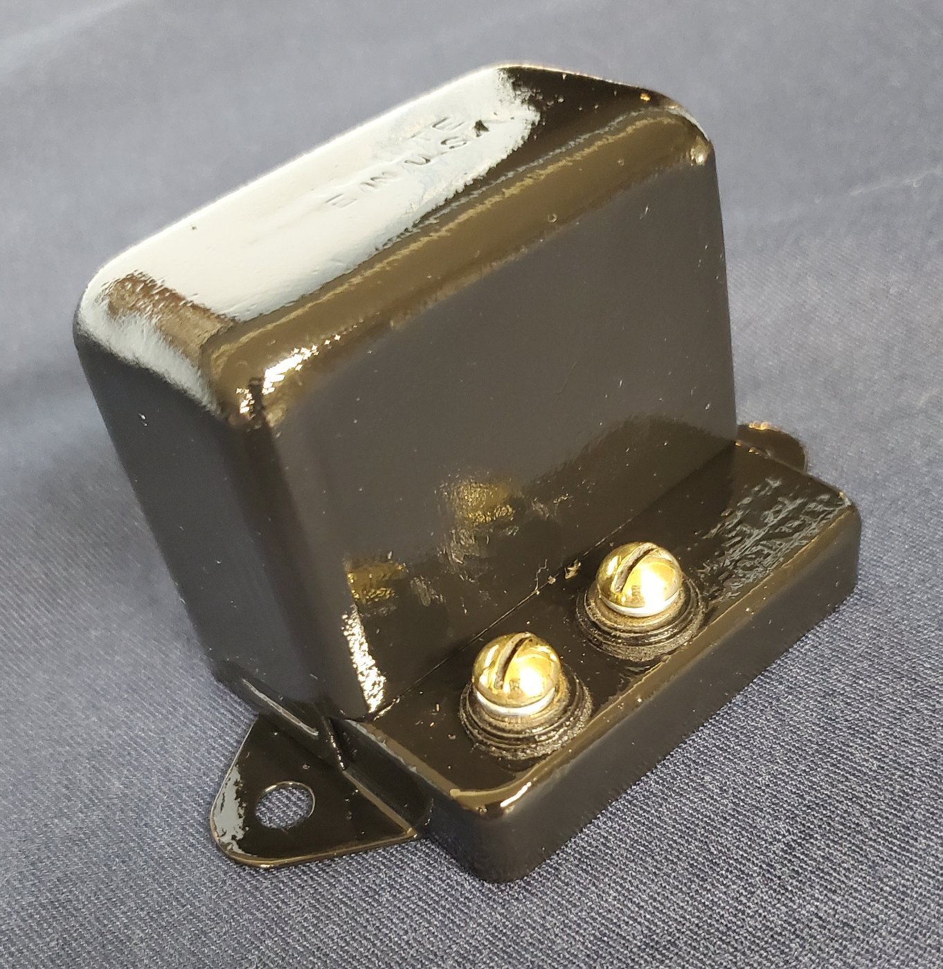

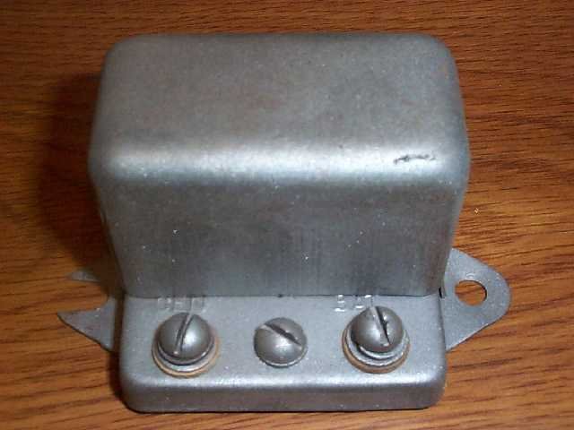

As some of you know, I restore Ford 6v generators (model T. A and flathead V8), and I refurbish original Ford generator cutouts. Occasionally I'll refurbish other brand cutouts too. Last weekend at the Luray pre-war swap meet I picked up this unusual Auto-Lite cutout with side mounted terminals.
It was dirty and missing some hardware on the underside, and the point tension spring was missing. Fortunately, I was able to replace the missing hardware and make a new tension spring. With this done, the points were dressed and closure voltage was adjusted to 6.5 volts. It was then painted and the original brass terminal screws polished. It now works like new.
My question is - what is the application? I'm pretty sure its not model T. But with the tremendous knowledge base here, maybe someone knows. What car is this appropriate for?

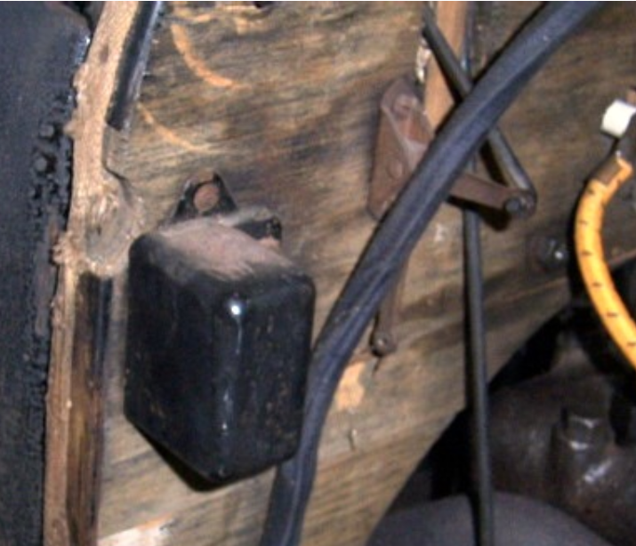

The first of the 1919 had the cut out mounted on the firewall, could be the same or a replacement?

Very close to an original early cut out, but the early firewall mounted cut out had 3 screws and this one has 2. The middle screw is for the ground.
https://www.mtfca.com/discus/messages/7 ... 1495407992

Re: Unusual generator cutout

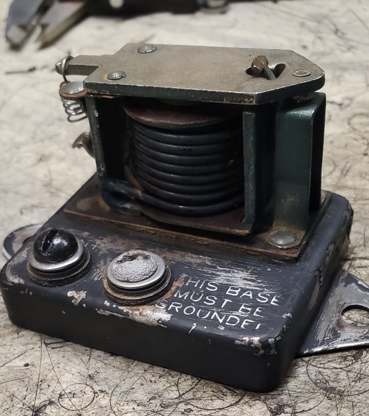

That one certainly is similar. Mine has "This base must be grounded" embossed on the base. Knowing the importance of a good ground, perhaps a latter version added the ground screw ?
An observation - on this cutout the feet are flat. That indicates it was mounted on a flat surface like a firewall. If it were mounted on a generator, they would be curved to match the generator's contour.

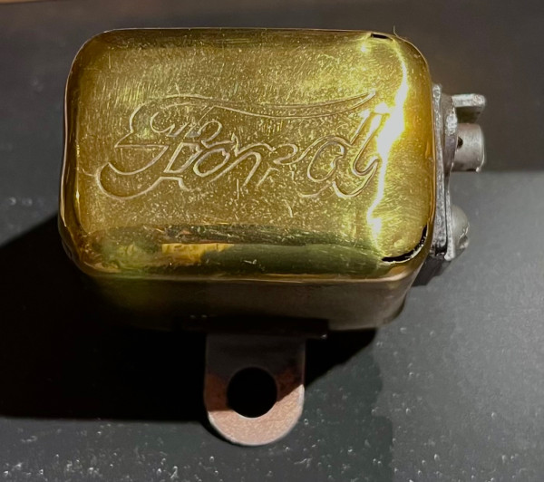

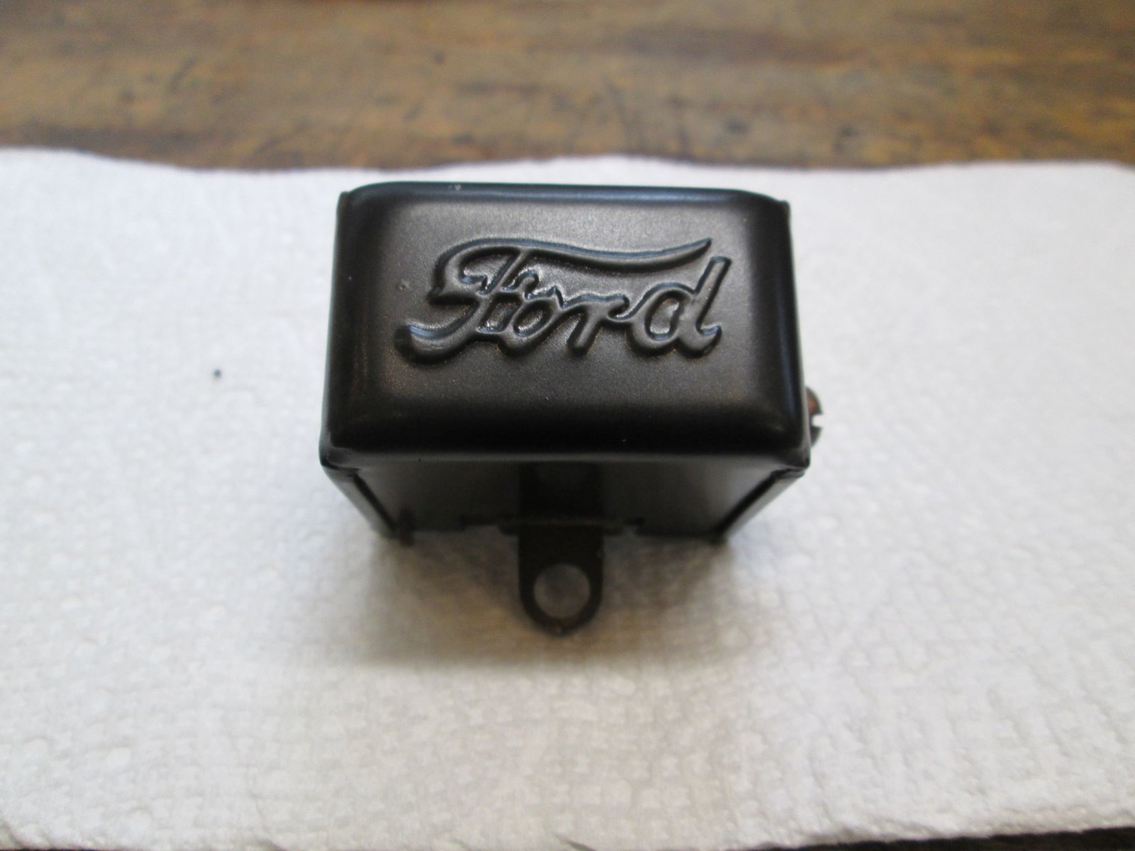

Here's an original early generator mounted cut-out. Ron Patterson was kind enough to "diode" this for me many, many years ago. I've been playing with these T's for over 50 years and have not seen nor got my hands on another !

Unobtainium.

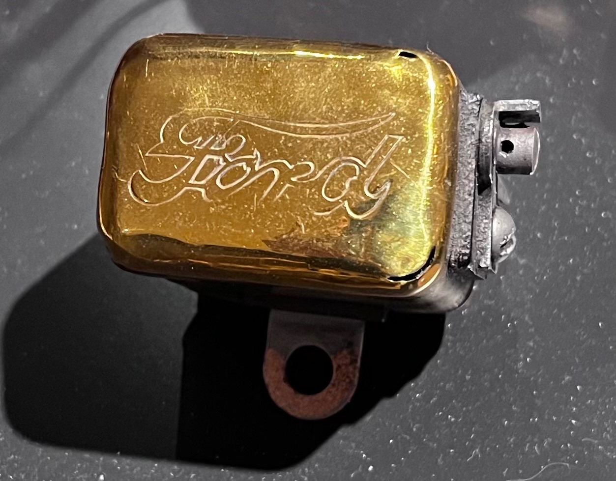

Steve, I have a couple of rectangular black script units.
Very hard to find. I love the Ford script.
I use one on both of my Allen generator spin testers.
They definitely bring good money when you can find one.

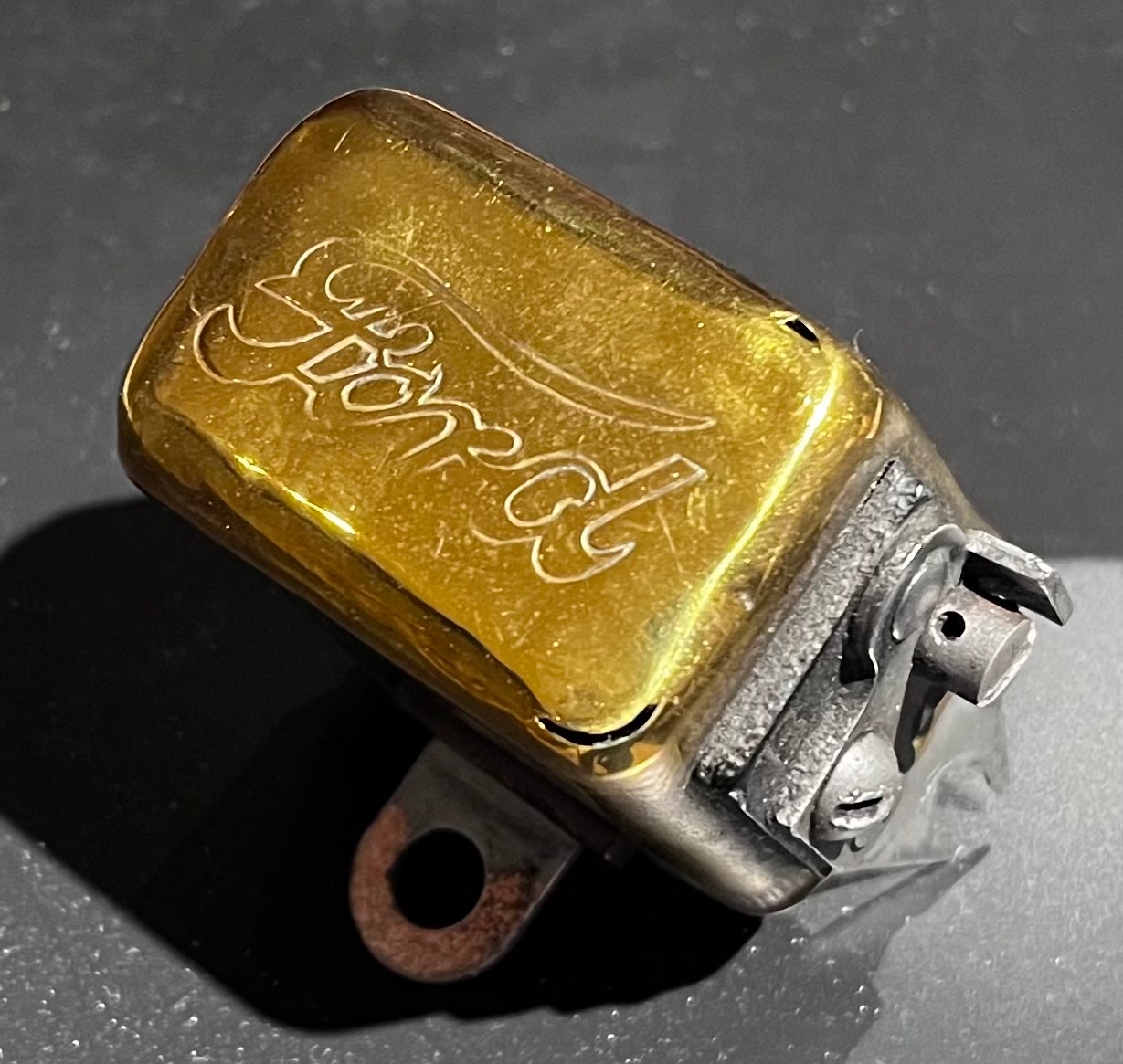

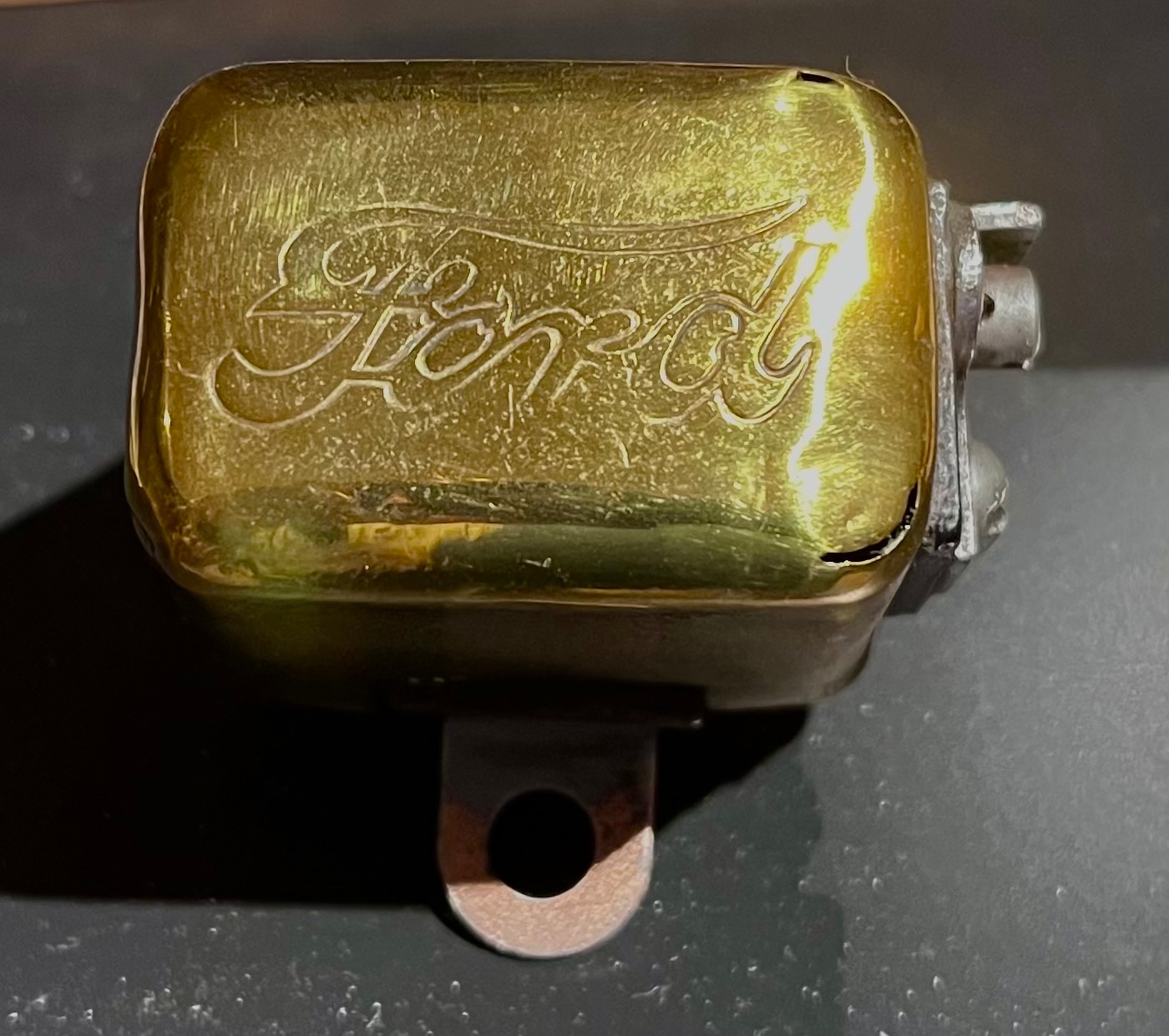

Here’s a brass unit that I got in a bucket of junk.
I’m not sure of the age, but being brass, I think it’s early.
Brent

ndnchf

- Posts: 5486
Great find, Brent ! Appears to have been a firewall mount - first one I've seen of that type.
