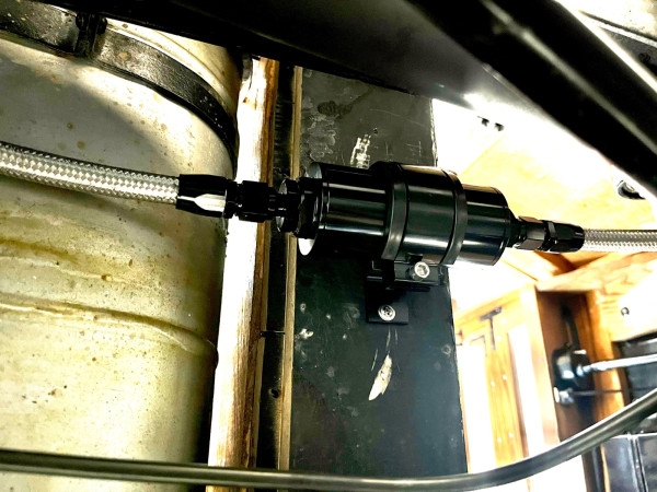

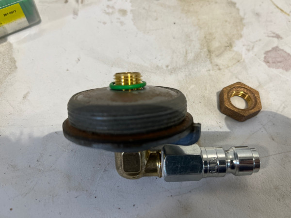

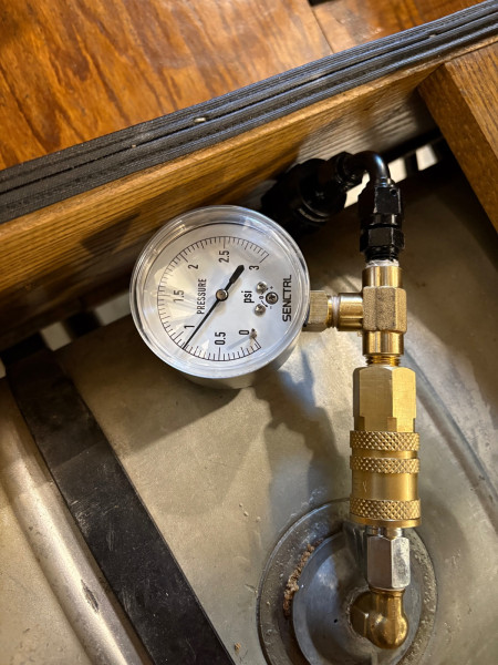

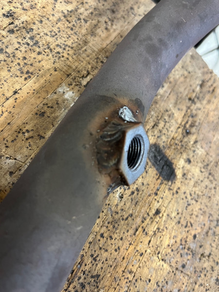

I finally took George Akins advice and pressured my fuel tank using the exhaust on my 1924 Depot Hack. For years I have had trouble climbing hills unless my tank was completely topped off.
To the neigh sayers, there is no risk of explosion. Any oxygen in the tank is displaced by carbon monoxide. There is an aticle in the MTFCA Carburetor book which explains how to do this work, taken from Model Airplanes which use the exhaust gas to pressurize the fuel.

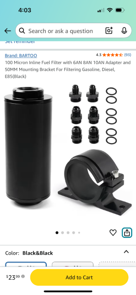

I bought these things from Amazon
SENCTRL 0-3 Psi Low Pressure... https://www.amazon.com/dp/B0C624GLKD?re ... b_ap_share
HEROFFIX 1 Pcs AN6 Fuel Line Hose... https://www.amazon.com/dp/B0DN1XWBRJ?re ... b_ap_share
Shineyoo 6AN Straight End Fitting... https://www.amazon.com/dp/B095H8WFMJ?re ... b_ap_share

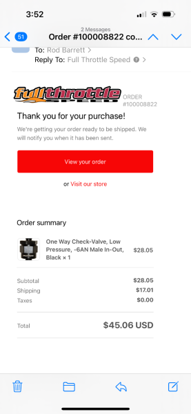

By adding a one way valve, I now have steady pressure in the tank. I also added the stainless fuel filter to act as a spark arrestor.
Look me up at Homecoming in June and I can show you the setup. Here are some pictures.

Negative pressure doesn’t exist. The one way valve is designed for low vacuum or pressure. Anytime the pressure in the tank goes negative, the valve opens thereby eliminating the condition you are describing of the tank collapsing.
The valve was added because the pressure gauge was bouncing quite a bit with each pulse of the exhaust. Now the pressure stays steady. The tank even holds pressure after the engine is turned off.

Your installation is very neat, and appears practical. Using the check valve (or one way valve) is a good idea, especially on such a short fuel line. Ambient temperature variations otherwise could push some amount of gasoline or fumes forward in the pressure line and spill into the exhaust pipe. Even IF that were to occur (actually unlikely?), it most likely would not be hazardous since the pressure line is plumbed into the top of the gasoline tank. The only gasoline that could push back in the line would be a very small amount of splash that might enter the line when the engine is being shut off (unlikely scenario). The small amount of fumes that could be blown back through the line would never be enough to become explosive in the exhaust line, and would naturally dissipate quickly. Regardless, a check valve adds a layer of security, peace of mind if nothing else.
Some era systems had a vertical loop of tubing in the pressurizing line. This acted as both a fluid and vapor trap as well as additional cooling for the hot exhaust gasses. It also added a layer of security as a sort of spark arrester. A lot of those considerations become moot points under normal use. Once the tank becomes pressurized, providing that the tank or lines are not leaking much, the actual flow of "hot" exhaust gasses is slow enough that more than a few feet of tubing will be cooled quickly enough such that the pressurized exhaust reaching the tank will not be hot enough to cause any harm, and any "sparks" that did manage to enter the line will be practically cold before it can reach the tank as nothing more than a piece of dust.
I have actually wanted to do this to one of my model T speedsters for many years, just never got around to it. I have built/restored and driven five speedsters so far. Three of them were pressurized by hand pumps, which I loved using! One, had a Stewart Vacuum Tank, which I also liked. The other was a simple vented gasoline tank and gravity.

It's also an essential item in order for the exhaust pressure system to function. Model N's used an exhaust pressure oiler, complete with check valves. They hold pressure so well, that if you don't purge the pressure after a run, it will continue to flow oil to the fourth main for some time afterwards and make a neat puddle on the driveway.Wayne Sheldon wrote: ↑Tue May 20, 2025 6:59 am
... a check valve adds a layer of security, peace of mind if nothing else.
