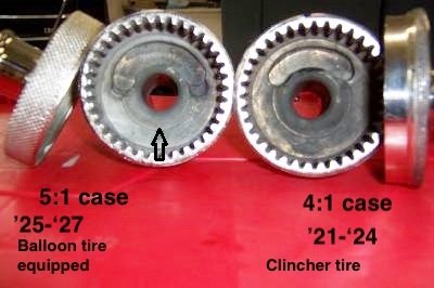

The 3 gears need to match the pinion (5:1 or 4:1) as well as the pins and case

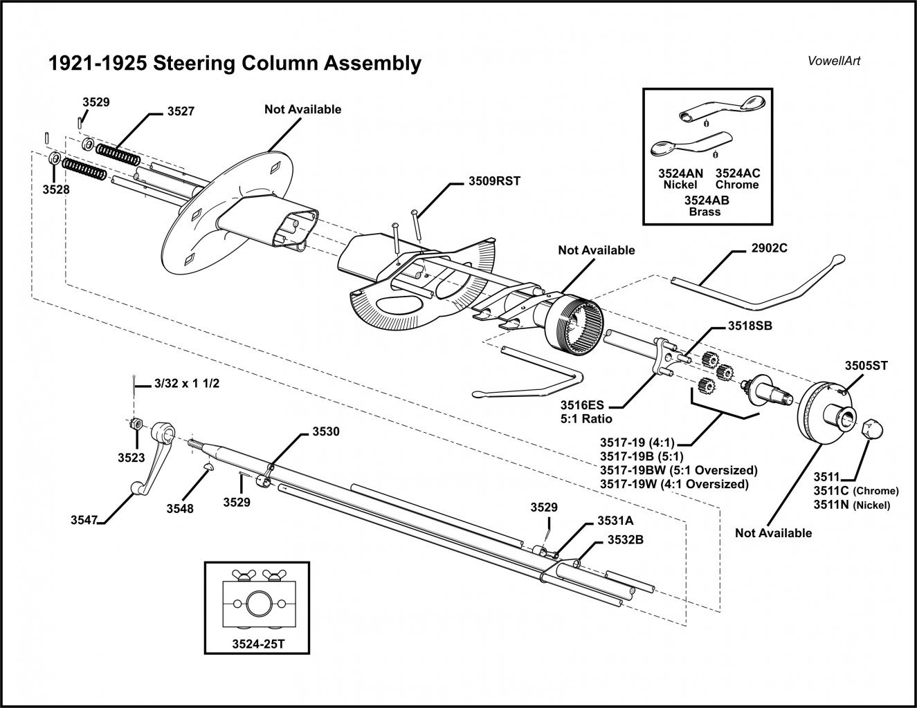

Not sure what steering combo you have. No assumptions. There isn't a diagram for '26 so just use this as a guide, not part numbers

Two places for slop often overlooked are between the steering case and the column tube. Then there can be wear in the bush in the bracket on the chassis. That said, with all the points for wear in the system, and the need for at least some backlash between the gears in the gearcase, 2" at the steering wheel is not excessive. Others may disagree.

This is a good point. My Fordor had too much play, turned out that god awful bushing down at the frame was the culprit. Got rid of a lot of play, still a little left but not horrible. Also, when he mentions the column tube, what I believe he's referring to is the two 3509RST rivets. Yep, they work loose and you wouldn't believe how much slop that'll produce. I know, my former '20 gave me fits running down EVERY point of wear to create slop, and it ended up being these two "half hidden" overlooked items. Replacing (I cheated and used bolts ha ha) cured it 100%. Just sayin!Allan wrote: ↑Tue May 20, 2025 2:42 amTwo places for slop often overlooked are between the steering case and the column tube. Then there can be wear in the bush in the bracket on the chassis. That said, with all the points for wear in the system, and the need for at least some backlash between the gears in the gearcase, 2" at the steering wheel is not excessive. Others may disagree.
