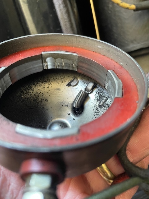

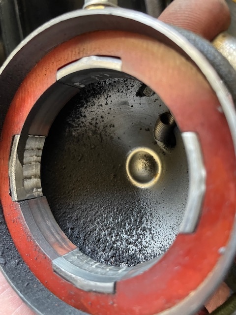

I got into the car today. I have spark on all plugs. I pulled the plugs and they were fuzzy with soot. I cleaned the plugs and adjusted the carb. The packing nut was too loose and was allowing the needle to thread out and get richer. I pulled the timer and found it was quite worn. The roller was also pitted (see the pictures). I have some spare timers, including some roller ones and an Anderson. I think I will try the Anderson.

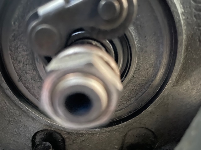

Before you put a new timer on, double check to see if cam cover plate was installed being centered on the camshaft.

- Posts: 5602
Re: New problem with my 22, looking for some advice
Something was sure causing a whole lot of bouncing around !!! That appears to be a more modern Tiger timer - not known for longevity !
- Posts: 4485
When you switch to the Anderson, you'll need to readjust your timing.
I had a bit of an issue fitting the Anderson, so I fitted a cast iron one that used a roller. I need to check the timing, but it runs better than it did already.
Every time you change a timer, the initial timing has to be reset... Which means the pull rod either has to be lengthened or shortened according to basic timer position....... Also every timer needs a little lubrication,.. looks like the one you pictured was running dry and had flaky metal drop into area of terminals two and four.
