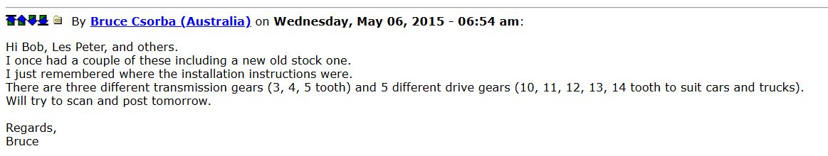

In one of the threads that Shannon posted, the Patterson version of the transmission drive speedometer had various combinations of gearing to suit different Ford configurations as noted here:
In the same thread, the original Patterson documentation shows what speedometer gears match up to which Ford tires and rear-end gear ratios:
The Nash speedometer set-ups might have similar parts. So, I think that you need to figure out which speedometer gears (drive and pinion) that you have compared to what tires and rear-end gear ratio that you are using. From that, you can start backing into what different speedometer drive or pinion gear that you might need based on how far off your odometer reads.
