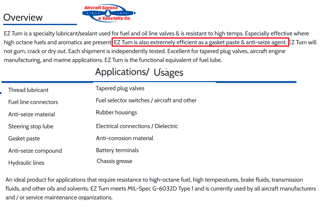

Does this help?Bill Robinson wrote: ↑Fri May 23, 2025 5:03 pmI know that some folks apply a gasket- (example: Crankcase pan lower cover gasket) by applying RTV sealant between the engine block and the gasket (apply to one side of the gasket), and then applying a real heavy grease to the cover rather that use RTV, then bolt the cover to the block. To be clear one side of the gasket gets RTV and the other side gets heavy grease. The goal is easy removal and re-use of the gasket. My question is- has anyone ever used the aviation product called EZ TURN? It's not effected by water, oil, gas and it is used on many aviation applications to this day.
