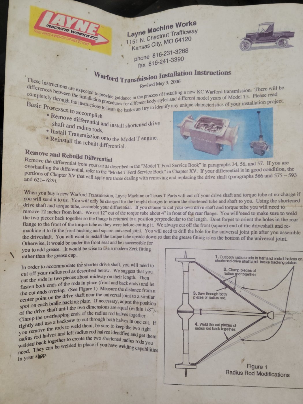

Here are installation copies from about 20 years ago. I've installed 2 in my own cars, 1 about 3 months ago. If you have questions call Steve 701 212 5009

As the above posted Layne instructions show and state, the drive shaft and tube must be shortened and rewelded to remove 12 inches, if I'm not mistaken, and the rear radius rods must be shortened and rewelded the appropriate, stated amount. I'm not sure if the Layne instructions specify that a crossmember support for the Warford must be installed, but it is always a good idea. I think Layne used to offer a service of shortening the driveshaft and tube and, maybe, the radius rods, too. I don't know if they still do.

Yes, The drive shaft and tube must be shortened. IF you purchase new, you can send the tube & shaft to the factory, and they will shorten for free.
BUT, you're on your own for the radius rods.
At least that was the way things were a few years ago.
