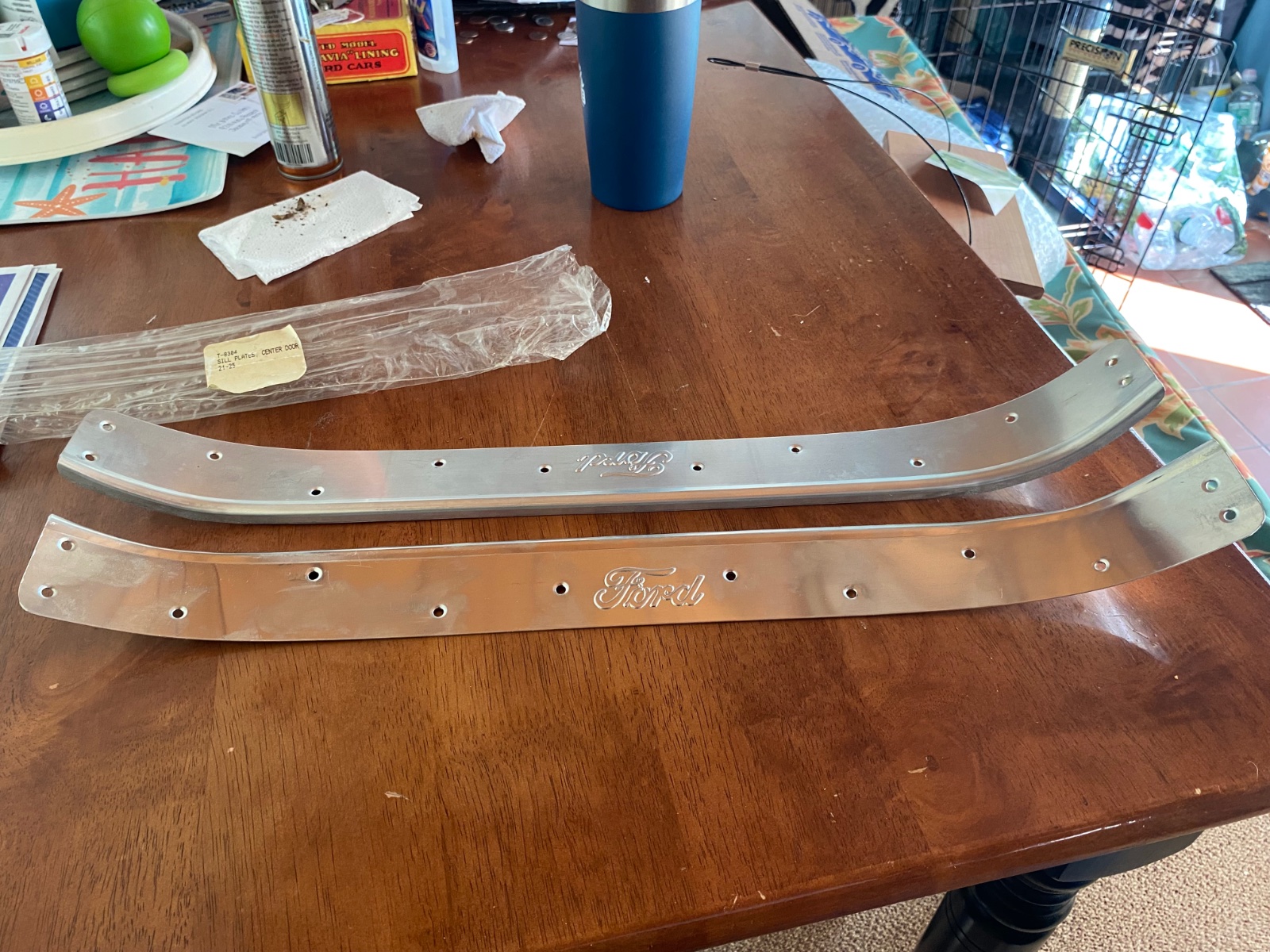

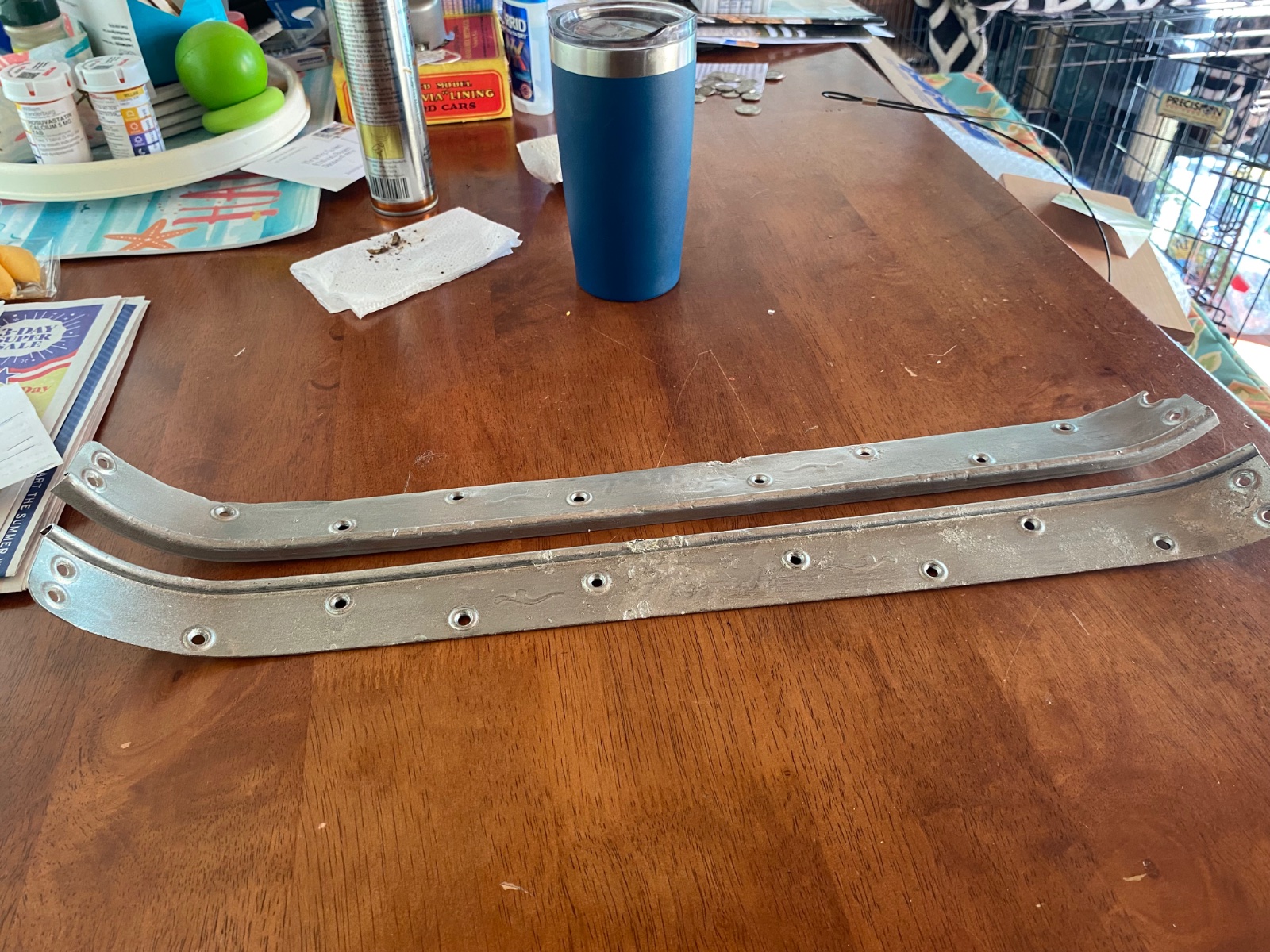

Take a look at the original door sill plates and compare to the reproduction ones.
The originals have a raised shoulder that the screw head sits in. The repros do not.
How would I go about forming them? Also, the new sill plates are too wide, so they will need to be trimmed

Do you have the ability to make a simple set of dies to form the ridge? You're also missing the fancy little flourish at each end of the Ford logo.
Frankly, I'd use the original ones...

No die making capabilities here. The originals are gouged.

Where did you buy the sill plates?

I bought them from a private seller in California. They are the same ones that Snyder’s sellsShannon_in_Texas wrote: ↑Fri May 30, 2025 9:59 pmJust some ideas…
