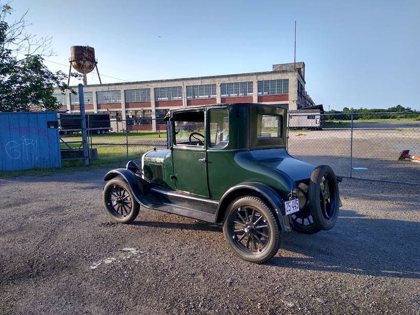

Post by varmint » Thu Jun 05, 2025 1:17 pm
We drove it outside the garage for the first time.
Went to the Ford factory where it was born and then it died.
Replaced the blown 20amp fuse with a 30amp but could not get it started again.
Towed it back with a chain to the garage and got it started.

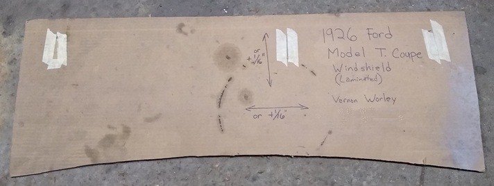

On June 3rd, we installed the windshield. It was the last thing, in my mind, keeping us from taking it out on the road for a shakedown.
Shout out to Haro Glass (local only). They asked that I provide a pattern and pick it up. It was same day service.

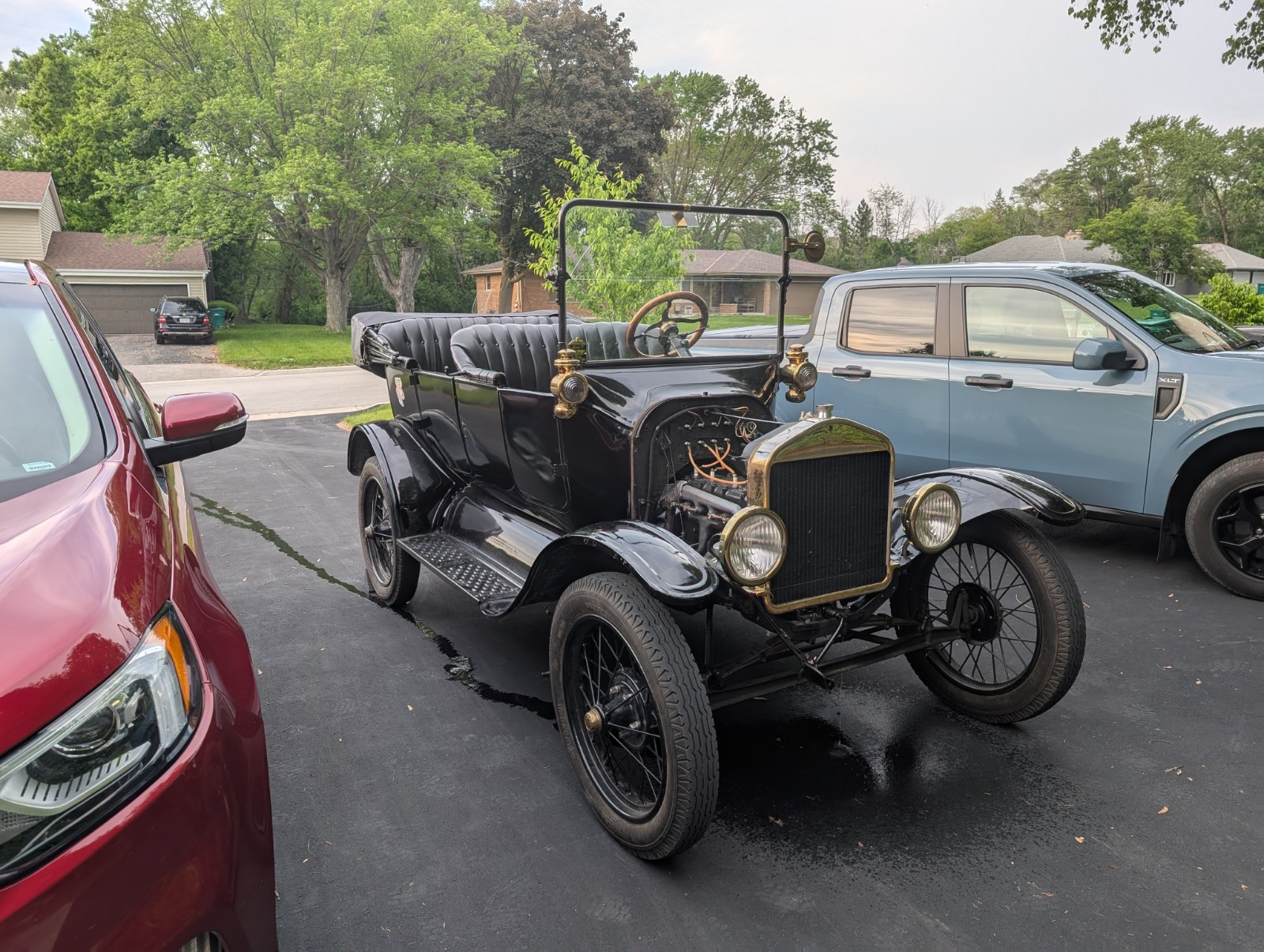

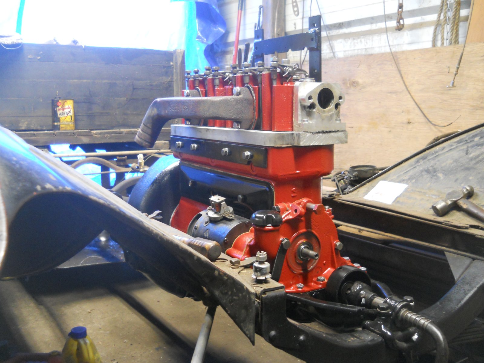

One of my triple gears lost a tooth. Adam Doleshal rebuilt the transmission for me.
Mike Zahorik and others in the Milwaukee club helped me reinstall the transmission.
Yesterday I finally finished all the little parts and took it for a trial run. It sounds better than it did before.
I filled her with water and here she is pissing that out so I can change to anti-freeze.

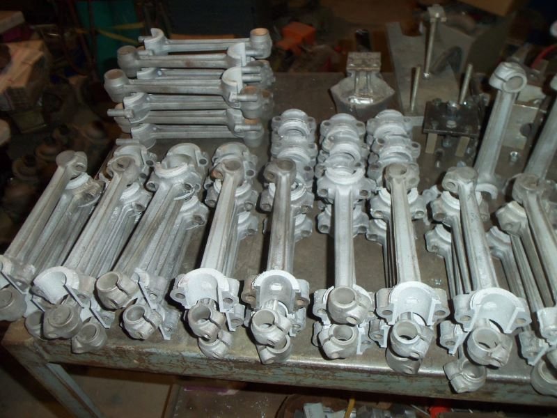

Post by Gene_French » Sun Jun 08, 2025 12:21 pm

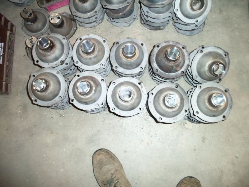

my projects so far for June have been mostly replenishing inventory ... have been re-babbitting connecting rods and ball caps for re-sale and have also started on my 1925 Dodge Brothers touring car restoration project ... i will post the pictures of the Dodge Brothers inserts when i get to that point ... i have been able to re-babbitt these on past projects , hopefully the inserts fit tightly in the rod bores ... lots of work to do on this car , some panel work on the ALL STEEL body and much work on the well used mechanical components ... like most of the non-Ford cars , parts can be difficult to locate and are often as worn or damaged as what you already have or are mis-identified and incorrect for your application ... some photos of my Ford projects for this month ...Gene French

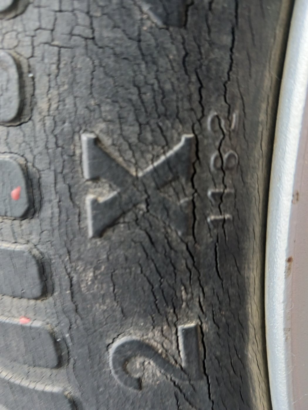

Replacing all four tires on the 1923 TT. The two rears date back to 1962.
New Lucas rubber sitting in the shed.

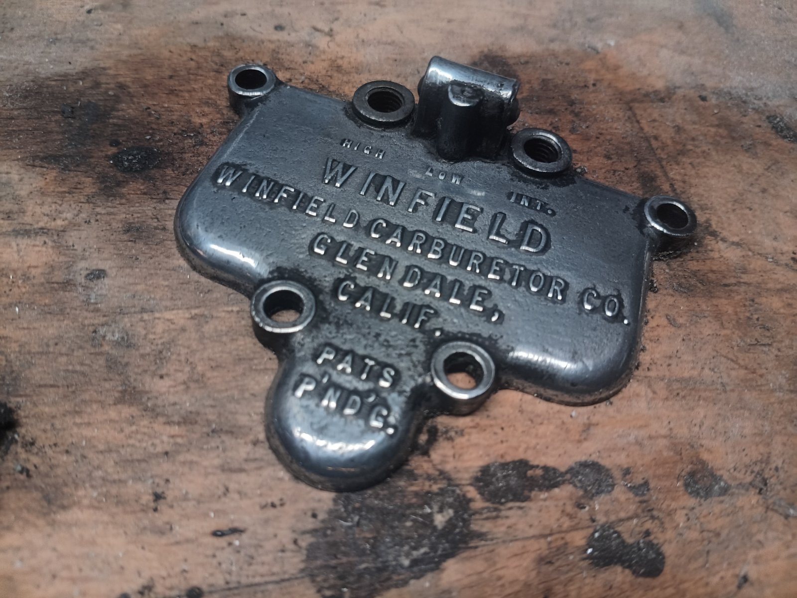

Post by babychadwick » Wed Jun 11, 2025 8:43 am

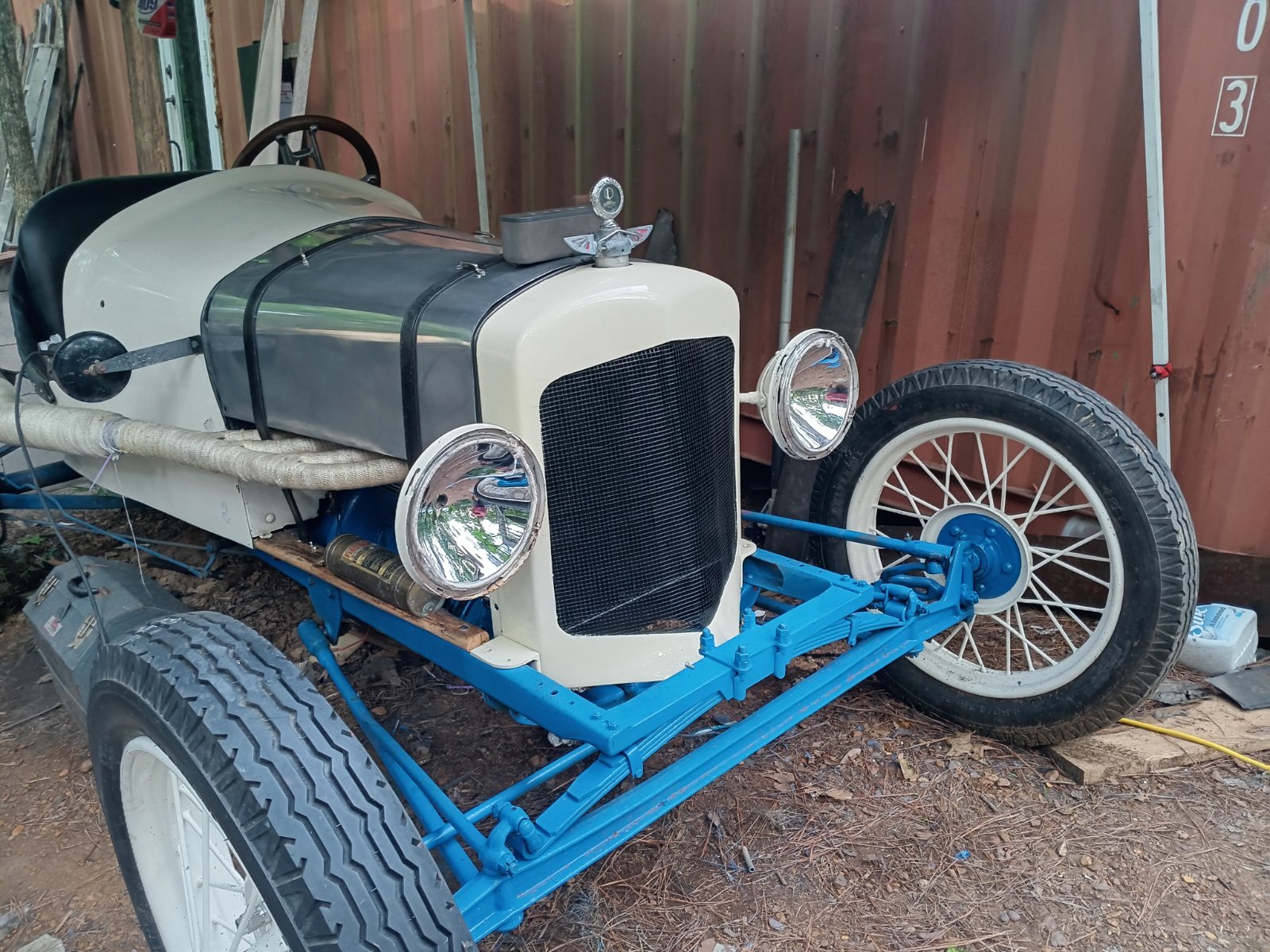

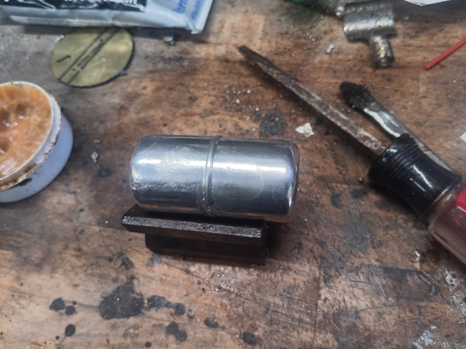

New radiator custom fit to shell, carb gone thru as best I can. The float was loaded with micro cracks so it was repaired ect.
The waterproof was also rebuilt, sealed bearing with NOS asbestos/graphite packing.
Hopefully I'll be getting her started today.

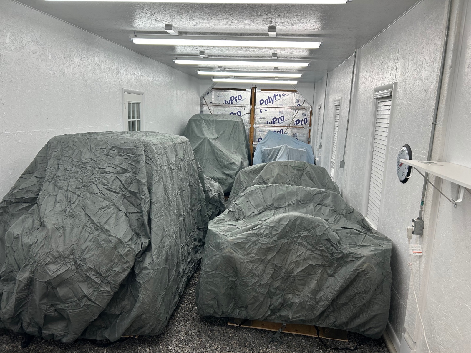

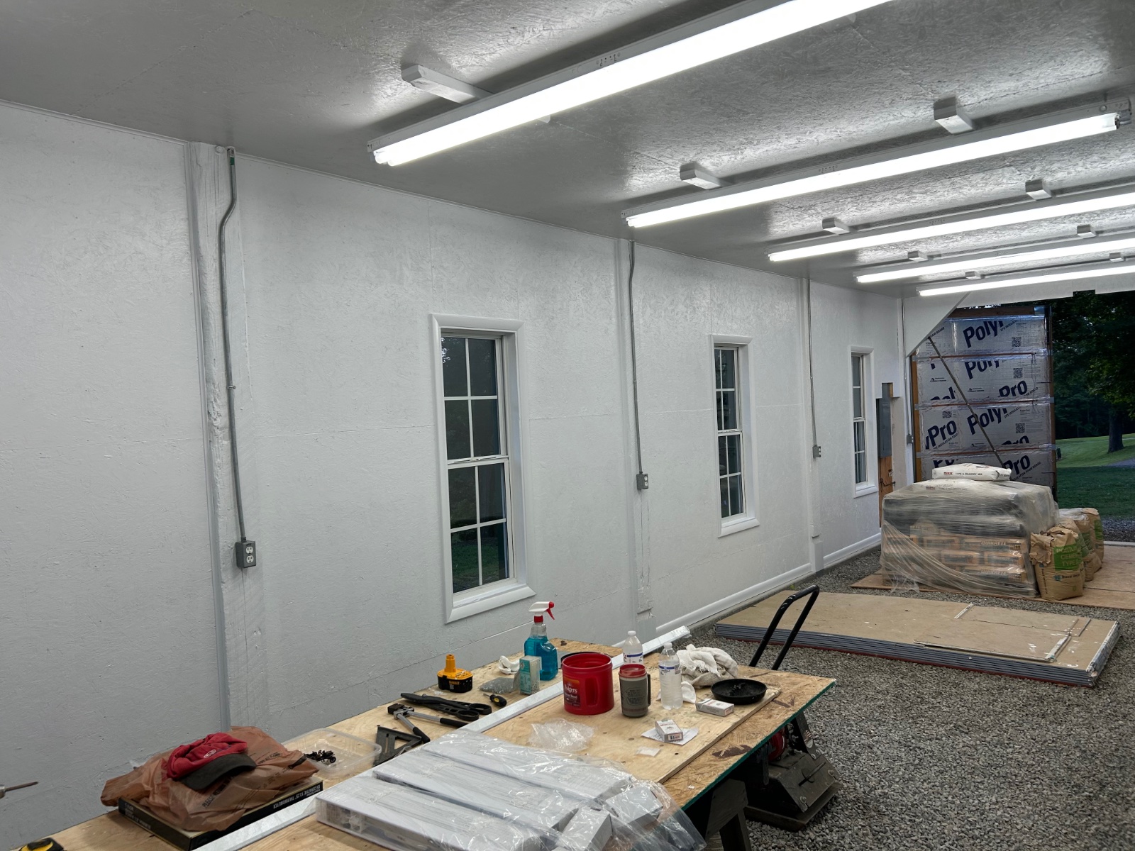

6 weeks later and the climate controlled room is built! Wheels off the ground, tire pressure lowered to 15 psi, fuel drained and purged..., let the coma begin. Better things to do in life!

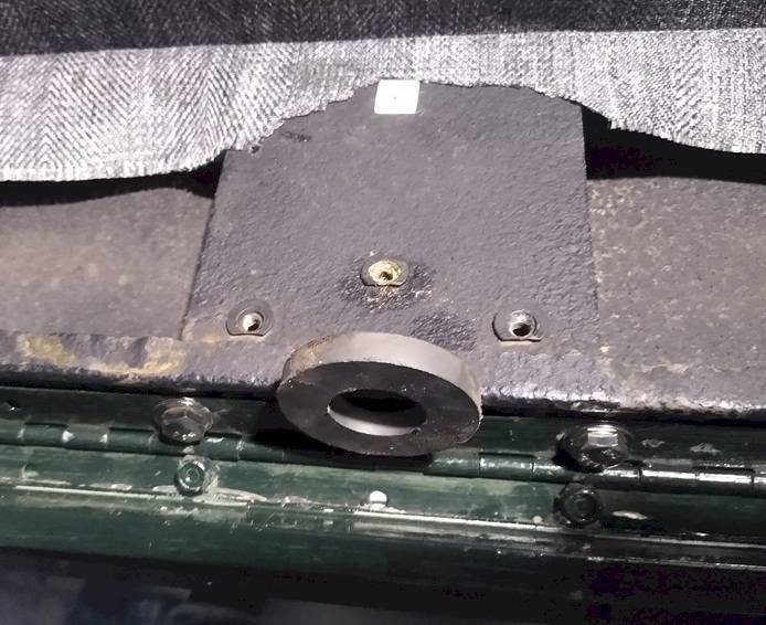

Vernon is smart. Nice front seat bottom removed to preserve it. He's attaching a magnet under the rear view mirror mount where there is a dark broken off screw in the center hole so that he can drill it out while all the filings are caught. Alas, the remnant is brass!

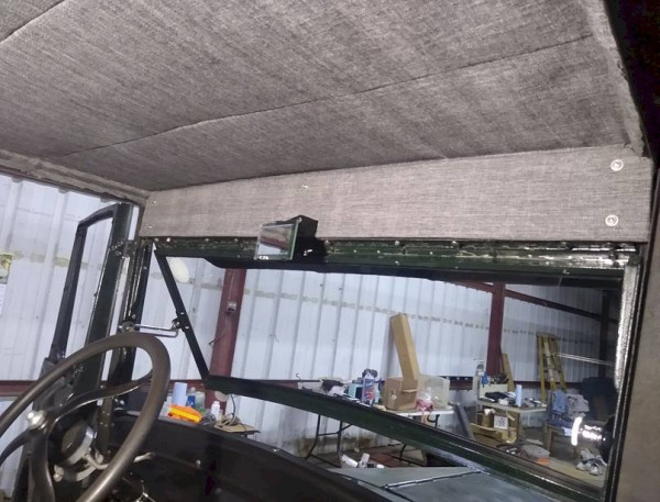

Post by varmint » Fri Jun 13, 2025 8:00 am

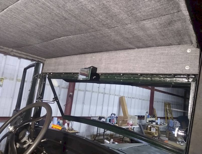

Did not mean to leave on a sad note. The brass screw remnant did unscrew out the back side and the mirror is installed.

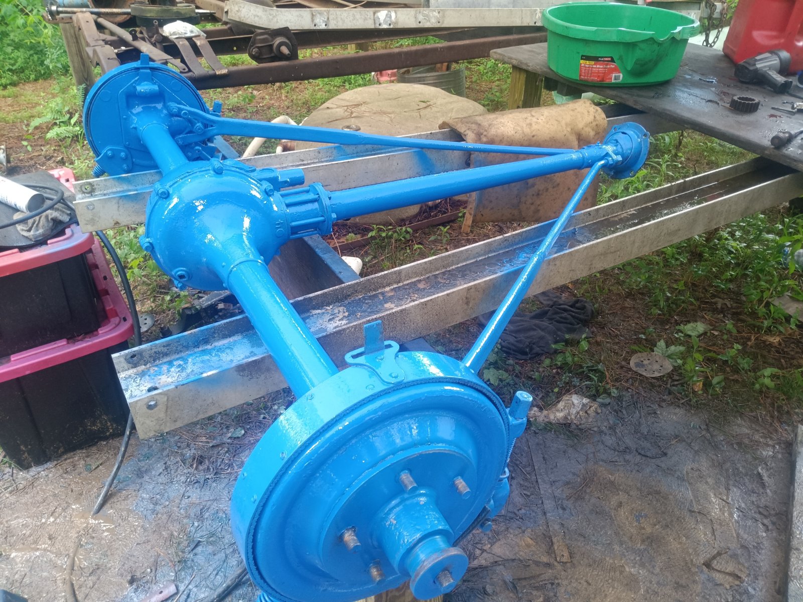

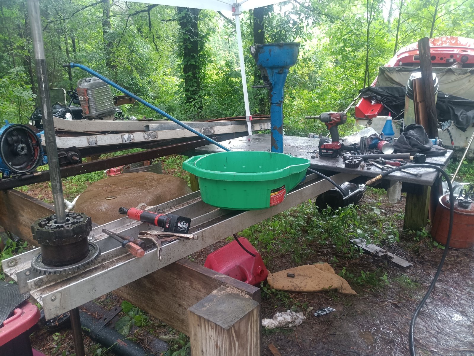

Tore apart the ruxtel. I replaced the bronze geared plate, 1 axle, half the carrier, thrust bearing, ect. It's miserable working outside in the rain. Still trying to get things ready for the reunion.
I still need to get it into the car but it's back together.

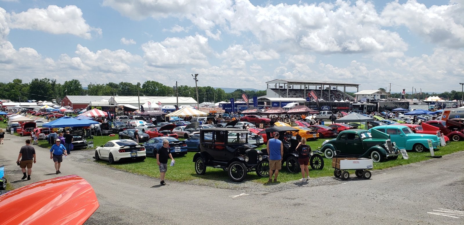

Took it to Carlisle Ford Nationals for its 100th birthday. 8-)

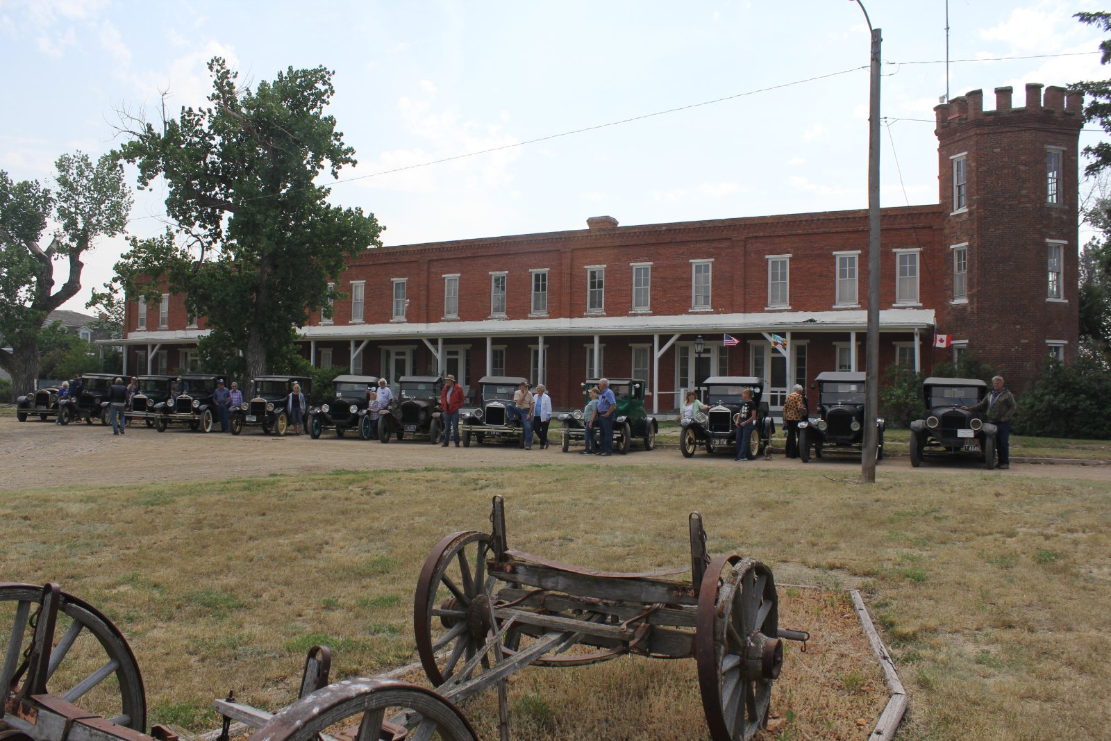

Our cub, the Rocky Mountain Model T Club, Went to Havre Montana for our spring tour. It was a good mix of dirt and pavement in some beautiful country. The history of this area was the focus and we we were not disappointed. The Bear Paw Battleground is where Chief Joseph surrendered.
Cruising in the Bear Paw Mountains
At the Bear Paw Battleground
Heading for the Bear Paws
At Fort Assinniboine

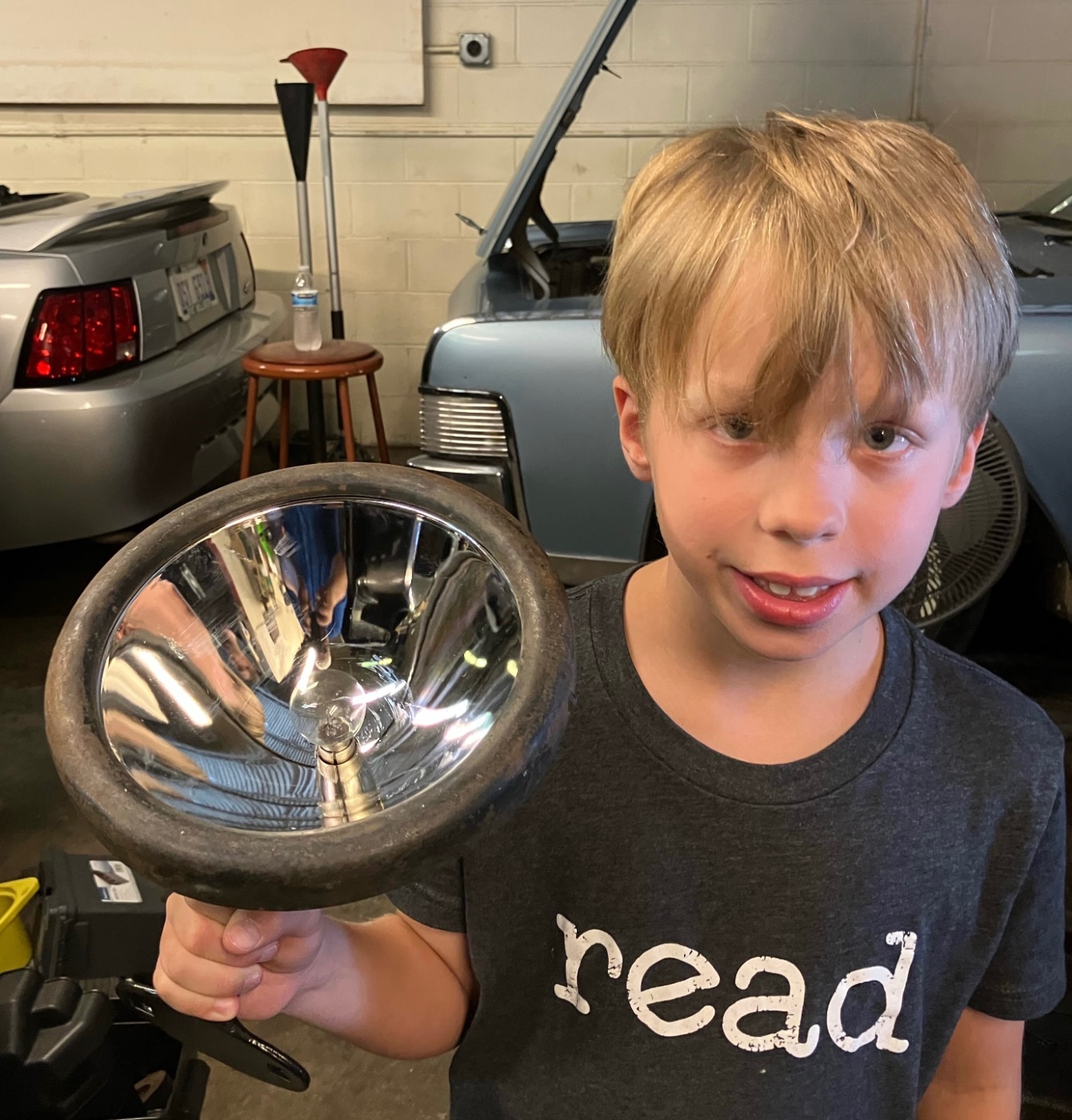

I’m still trying to figure out my headlight on the right side. My grandson has it here. The single drain hole is on the bottom and is aligned with the mounting bracket. The rim rivets line up with the bracket so the lens is aligned wrong for 1926.

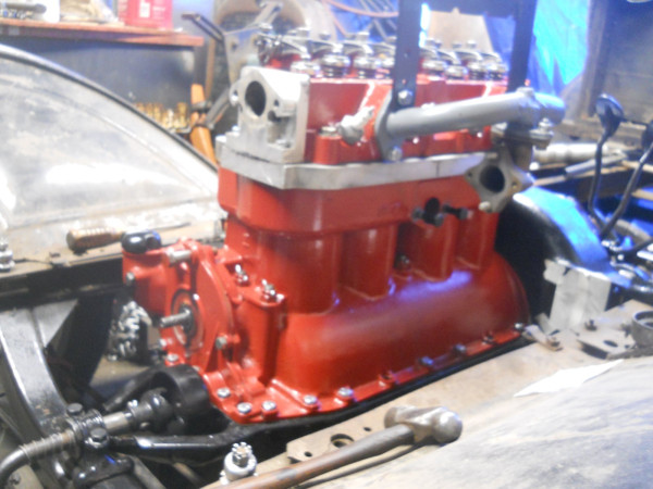

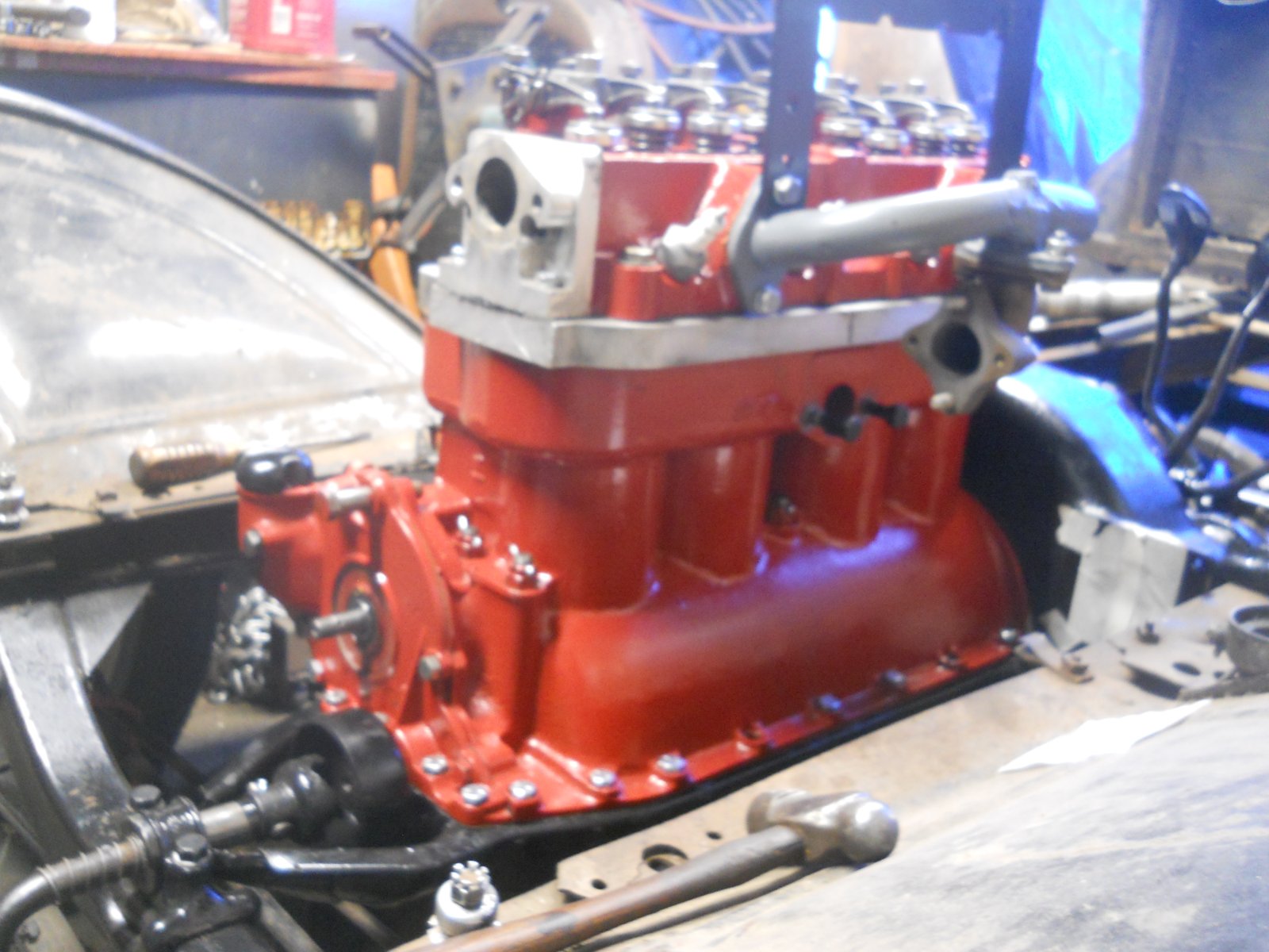

Got my rebuilt engine and transmission back in thanks to good friends.

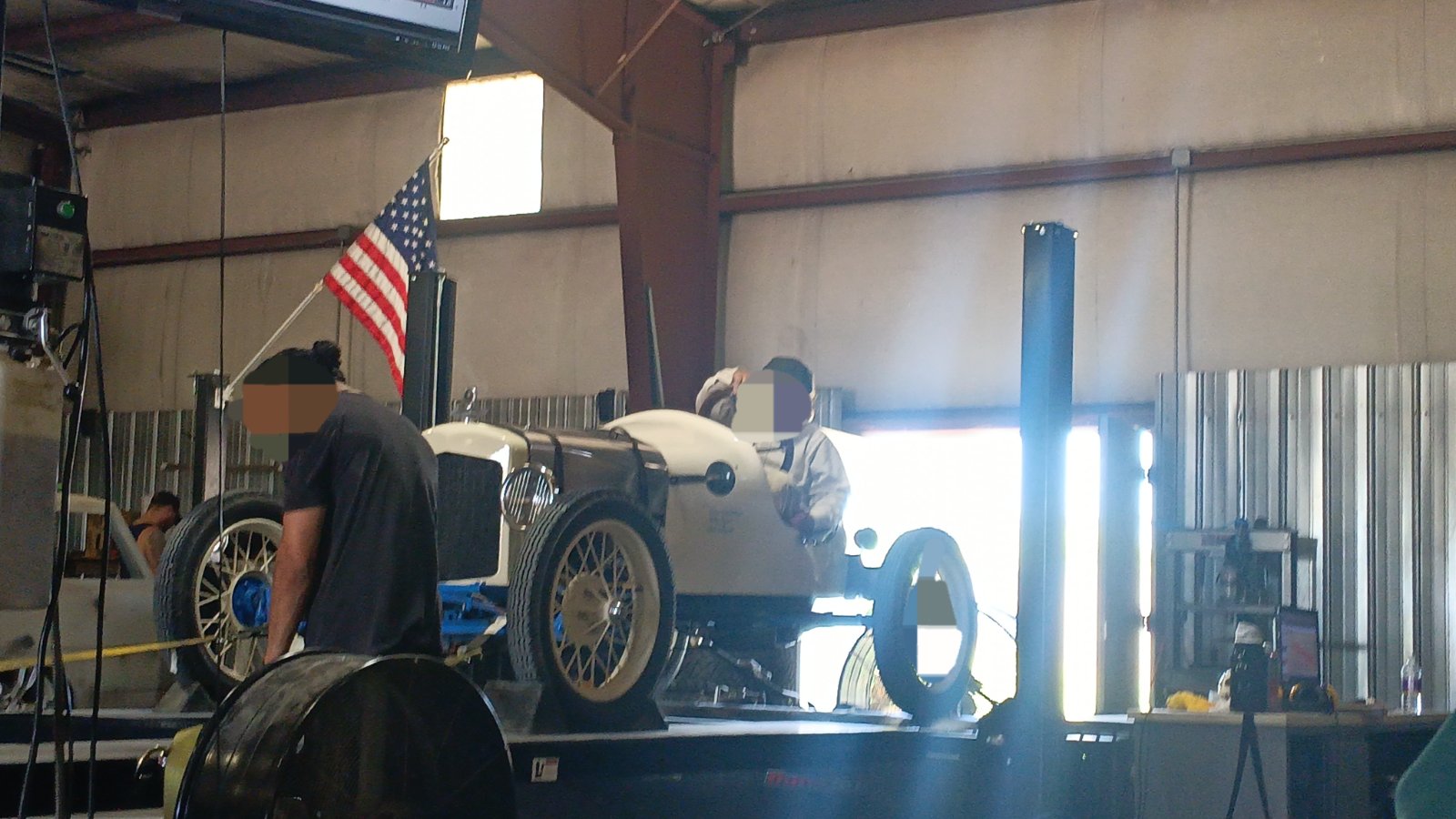

Made it to the reunion and had the car together and running "just" in time to dyno it.
To get to this point was an ordeal that has included far too much to list. Running rough horsepower increase was 10 more than 2 years ago and torque showed a 40 increase. The distributor is a definite problem but finding parts is proving difficult as it is an original bosch front plate and I would like to keep it original rather than drop a new one in.

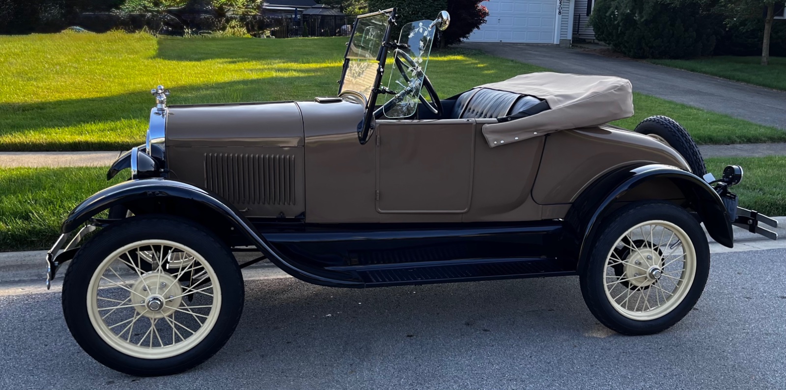

After several months of bad luck, our little 27 Sport Runabout is on the road!
So far she’s running like a champ!

Brent, just what I would expect from you. Looks fantastic.
