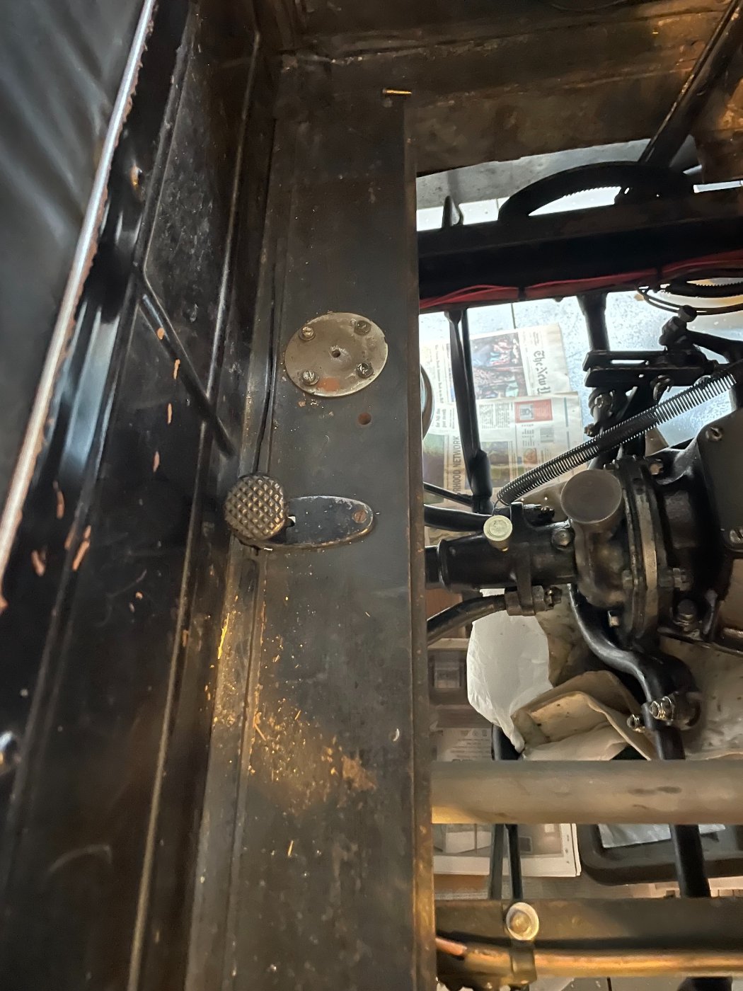

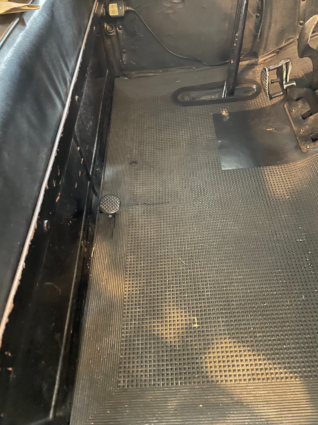

aDave
- Posts: 354
- Joined: Fri Jan 04, 2019 10:21 am
- First Name: David
- Last Name: Dufault
- * REQUIRED* Type and Year of Model Ts owned: 1915
- Location: Concord New Hampshire
Re: Aermore exhaust whistle pedal mounting
Small Pedal is for the Whistle; large disc is the top half of the Bermuda Bell (plunger hole) ....either operated with right heel.
WillyR
- Posts: 359
- Joined: Wed Aug 21, 2024 5:24 pm
- First Name: Vilhelm
- Last Name: VonRaschke
- * REQUIRED* Type and Year of Model Ts owned: 1924 coupe
- Location: ABQ
awesome thanks so much!
I have my bermuda, about where the white plastic bag is in your first pic so my passenger can actuate it.
I think I'll mount either a pedal or a choke cable about the same vicinity as your pedal.
I think I'm leaning more toward a choke cable mounted to the seat riser...
