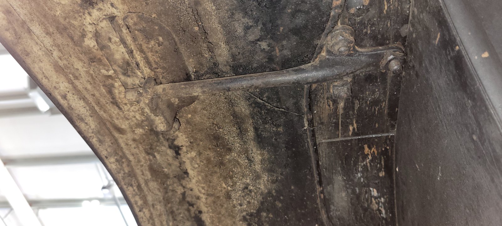

1911 Touring Rear Fender Bracket
Can someone please post a photo of the rear Fender Brackets and how they attach to the Body on a 1911 Touring. I am confused with the part I bought from a Vendor and how it attaches to the body.

Re: 1911 Touring Rear Fender Bracket
Post a picture of what you got.
Photos on old post at this link.
http://www.mtfca.com/discus/messages/41 ... 1407306205
Phil's 1911.
Note at the mounting end of the bracket, the "shaft" comes to a rather distinct "point."
