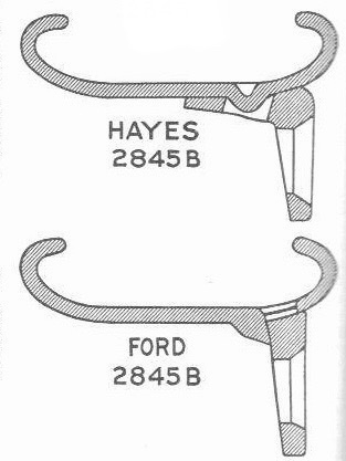

Searched through previous posts and was cornfused, so here we go again.
The straight sided felloe will take both Hayes 2845B and Ford 2845B rims? And the rolled side felloe will only take the Ford 2845B?
Posts: 7306
Re: 23” Demountable Felloe Question
Post by Allan » Fri Jun 13, 2025 8:42 am

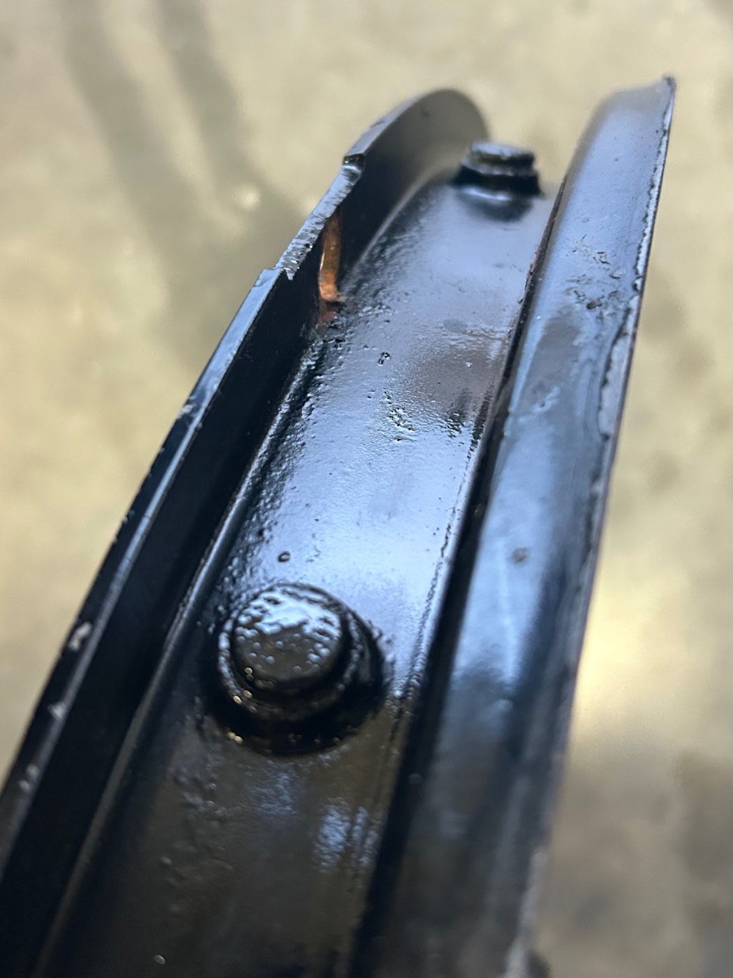

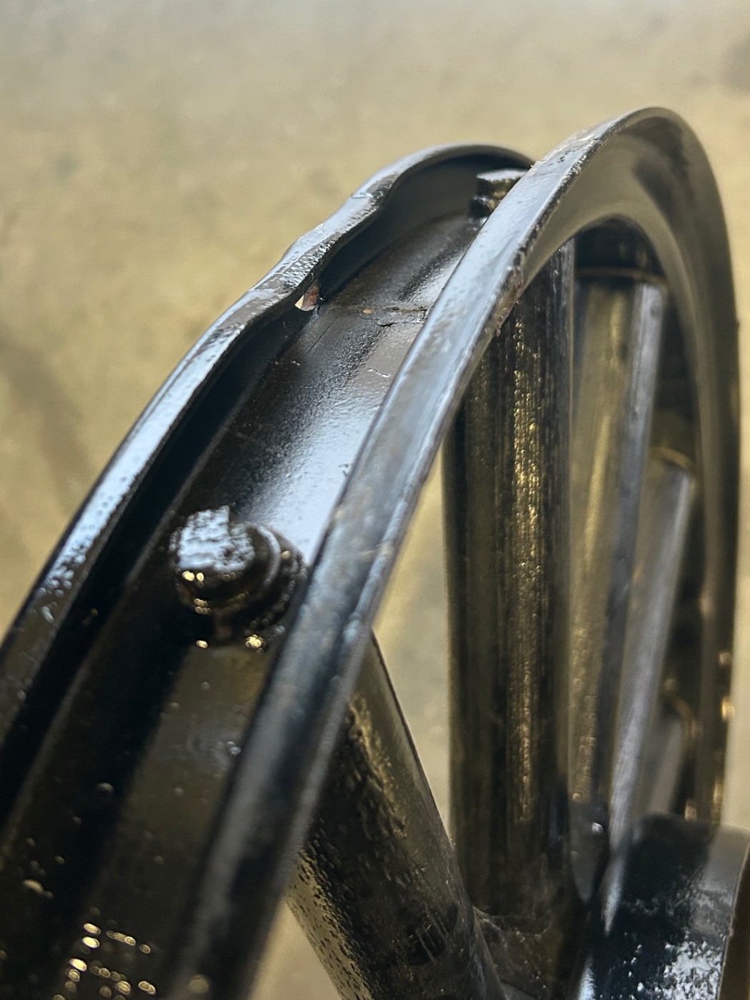

The rolled side felloe also has a depression in the rolled edge to accommodate the lug foot on a Hayes rim. Hayes felloes have that depression, and will take Hayes rims and other fixed lug rims. A Hayes rim will not fit if there is no depression.
