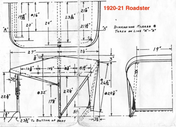

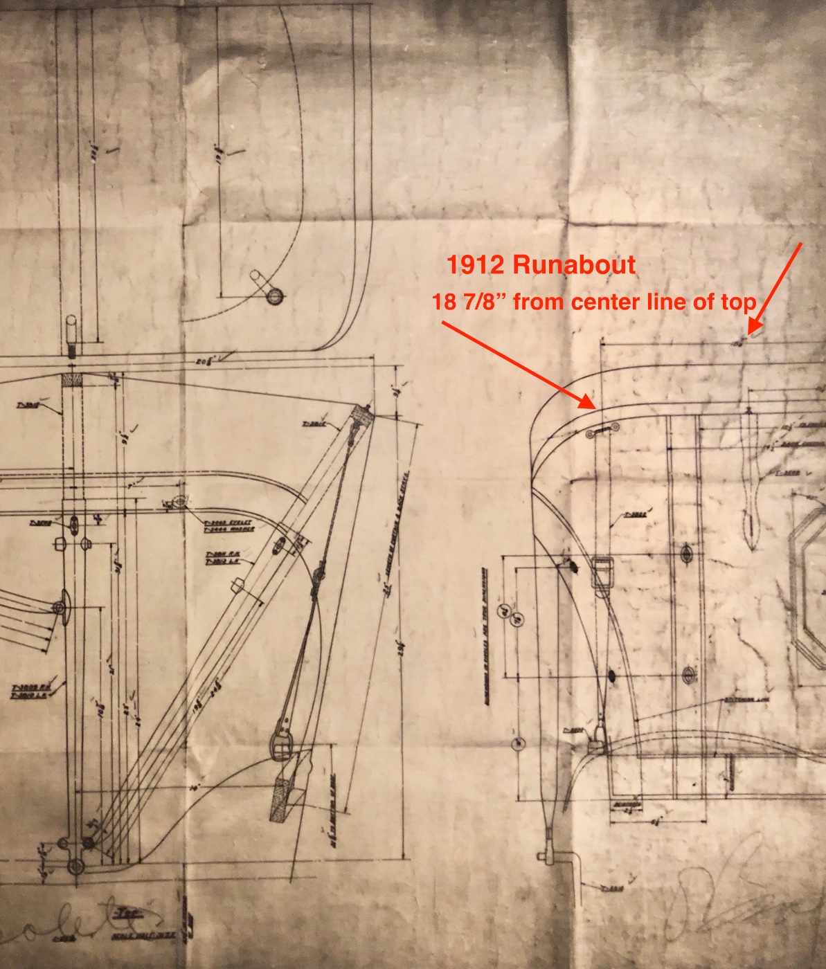

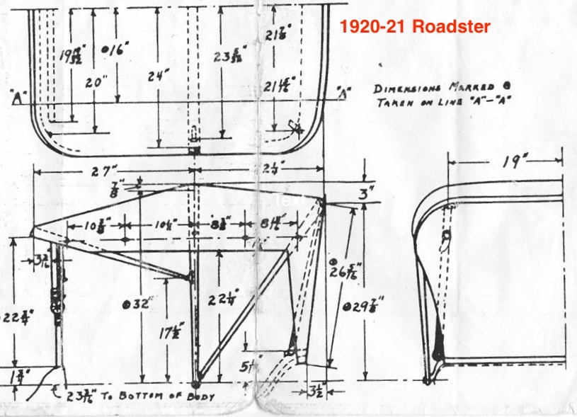

These may help.
The 1912 runabout footman loops are 18 7/8" spaced from centerline of the top.
And this is the later 1920-1921 with footman loops 19" from centerline of top.
