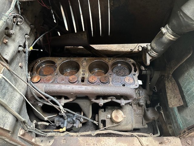

This was brought to me today to get running. The ninety year old owner said it was running when he shut it off. He shut it off in 1983. The engine is free but It has three stuck exhaust valves. I am soaking the valves and tops of pistons with KROIL. I will also try some 50/50 acetone and Automatic trans oil. I saw an old post by RV Anderson saying instead of tapping on top of the valve to turn the engine until the cam lobe is pointing down on the stuck valve and put a washer or a dime under the valve stem and turn the crank in order to push the valve up. The coils have been sent to be rebuilt, the carb and fuel tank have been cleaned. Whats the chance of the rings being stuck? I'm letting it all soak for a few days.

Rings are probably stuck. I'd keep soaking everything for a few more days, then rock the car back a forth in high gear to loosen the engine. Move it a little in each direction, and soak another day or two. Tap on the stuck valves with a screwdriver handle and keep soaking. Avoid forcing anything.

I would like to recommend for the valves any good penetrant and maybe a little touch from the torch to loosen them up. i'd go torch then penetrant. i used this method on a stuck A exhaust valve and it works well. just don't melt it. a little heat in the valve guide will work wonders in getting it loosened up. take the valve spring off to make it easier to get the valve to move. I'd also lap and adjust the valves if it has adjustable lifters.
- Posts: 4456
Re: stuck valves
I really would not do that. I can't see how a coin or a washer changes anything.Art Ebeling wrote: ↑Sun Jun 15, 2025 8:53 pmI saw an old post by RV Anderson saying instead of tapping on top of the valve to turn the engine until the cam lobe is pointing down on the stuck valve and put a washer or a dime on the cam and turn the crank in order to push the valve up.
For one thing, you have 3 stuck valves. Chances are, you won't be able to turn the cam until the lobe is pointing down on any one of them because one of the other 2 stuck valves will most likely prevent it.

Since the head is off, the valves are stuck, and they are original two-piece valves. This looks like a perfect opportunity to grind the seats and lap in a new set of valves.

The engine is not stuck, it turns over but of course there is no compression with the three stuck valves. I changed my description of what was posted about freeing a valve. ArtTXGOAT2 wrote: ↑Sun Jun 15, 2025 8:59 pmRings are probably stuck. I'd keep soaking everything for a few more days, then rock the car back a forth in high gear to loosen the engine. Move it a little in each direction, and soak another day or two. Tap on the stuck valves with a screwdriver handle and keep soaking. Avoid forcing anything.
- Posts: 8632
Re: stuck valves
Rocking the engine a few degrees forward and backward will tend to loosen stuck rings.

First as always I'll preface by saying/admitting I'm no mechanic but I do my best to learn from others. That said, if the engine "turns free", then how can there be "stuck rings" and yet have the engine turn freely....i.e. the pistons would move up and down? If rings are truly stuck, do you mean as in "stuck to the cylinder walls"? The engine wouldn't turn free then in my simple mind! Looking at the pic with the head off, and given the age, frankly I don't know why this poor tired engine isn't just a candidate for a full rebuild anyway. Looks to me like at least one water circulation port is plugged up also. Why piss around with beating on valves, etc. on an engine which is truly crying for a LOT of help!?!

Keith makes a valid point. If they are two piece valves they should be replaced. That means you can get rough with them. A pair of multt-grip pliers on the head will allow you to screw them about and let any penetrant work better. Just don't get so rough that you turn the head on the valve stem. I have had success using a side valve V8 valve lifter to lever out stuck, never to be used again T valves.
- Posts: 5246
Re: stuck valves
Rings can be stuck in the pistons. The way to know is to pull the pistons. Its a crap shoot as to if & when the rings will free themselves after running. I see rusty valve & piston tops. How do the bores look? What does the Babbitt look like? If you tear it down you will find other problems in the transmission. Is the oil funnel open?

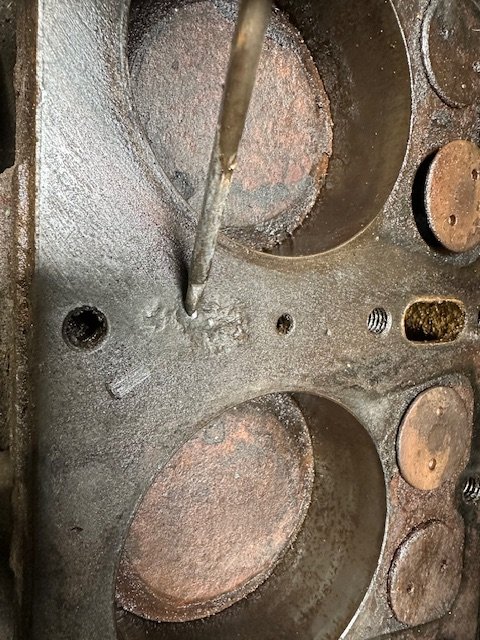

Concerning that clogged water passage I started to see if I could break it loose and started to drill a small hole thru it but stopped when what I was drilling appeared hard and shiny. Would corrosion be that hard and have shiny metal shavings? It almost looks like a weld. I did get the valves unstuck, the two center ones by tapping and the rear one under the firewall that I could not straight down on the center by putting a penney on the lifter and turning the crank. That popped it up and then I could push it down. I did that about five times until the valve moved freely. I do plan on removing the oil pan inspection pan and pushing the pistons to check the rings out and checking the babbett.
- Posts: 6789
Re: stuck valves
Art
stop it
there is no hole there
stop it

Re: stuck valves
I did stop, just made a scratch and thought it wasn't right. Thanks

I think the first question is what is the expected result of this operation? To just get it running or is the owner wanting to start touring again?
Did the engine turn free? or did you have to force it to turn, can you see rust rings in the cylinder were the rings were stuck? Take the tappet
cover off & try prying up on the valves with a screw-driver? Gently of coarse. Try installing a short bolt in the block & use it for a lever to pry
down when there is space between the valve & the tappet. I have taken tappet covers off to find a mud-dobber city in the valley.
I had a call on a 14 ( engine seized ) Turns out the clutch was stuck together & 3 valves were stuck. Engine turned with the rear wheels off the
floor. Freed up the valves with lube & prying them up & down with a brake spoon ( through the plug hole & between the valve & tappet). Fired up & after running for 10 minutes the clutch freed up. Still running 2 years later.

The Owner just wants it to run again. I will suggest new valves and inspect the rod babbit and pistons for stuck rings.

Art, while you have the plate off the bottom, remove the two threaded horse shoes too. You may be amazed by the amount of crud that can accumulate between them and the sides of the pan.
