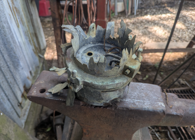

Did this carbide generator blow up?
Herb Iffrig
Topic author - Posts: 1769
- First Name: Herb
- Last Name: Iffrig
- Location: St. Peters, MO
I recently came across these remnants of a carbide generator.
It is a side mount type of generator. Holy cow, what happened to it?
Is it just showing the effects of age and brass cracking from the spinning process? I have seen other pieces of brass get this way, but not to the extent this one has suffered. It looks shredded.

Herb-
I believe that is the effect of 100+ year old spun brass that has been exposed to the elements.
The upper chamber is the water reservoir. The lower chamber would have had the acetylene gas.
Keith

Notice the presence of a valve where the hose would connect to the generator. I suspect that the generator was "shut off" by stopping the water drip and immediately closing the valve, which would bottle-up the gas still being generated by the still-wet carbide. The generator probably burst, not exploded.
Doesn't explain burst top tank, though.

It's all due to stress corrosion cracking in cold worked brass.Greg Griffin wrote: ↑Fri Jun 20, 2025 2:53 pmNotice the presence of a valve where the hose would connect to the generator. I suspect that the generator was "shut off" by stopping the water drip and immediately closing the valve, which would bottle-up the gas still being generated by the still-wet carbide. The generator probably burst, not exploded.

I don't know what brand of acetylene generator is pictured, but on the E&J generator for my 1911, when the water valve is turned to the "off" position, it opens a port to vent the acetylene in the bottom of the tank to the outside.

Herb I think you have what is left of an early Jno Brown generator judging by the wing nut locks.

I would go with Keith's response. Too little cold working in spun brass dents easily. Too much cold working in spun brass invites significant cracking with time. For my 2 cylinder Buick I managed to buy new spinnings a number of years ago but needed the hardware (They are Gray and Davis bullet lights). I purchased a set of lights properly represented as only good for hardware. When I opened the shipped lights in a box I just laughed and exclaimed that they looked like cherry bombs had been set off inside each light looking much like the pictured generator.KWTownsend wrote: ↑Fri Jun 20, 2025 10:11 amHerb-
