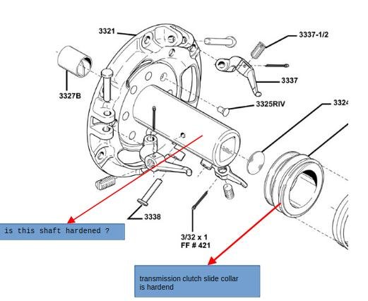

Re: clearance transmission clutch slide collar
Hi Allan,
thanks for the answer.
Are you sure that this shaft is surface hardened? I didn't feel anything there. The transmission clutch slide collar is hardened.
It would make sense if the shaft was hardened. But I didn't feel any of it.
Markus
Markus

- Posts: 4481
It's not uncommon to turn down the output shaft to true it up and remove wear. However, I believe it's usually only done in the area that runs in the fourth main, (requiring an undersized fourth main). If the shaft is heat treated at all, it's most likely through hardened and not surface hardened. I've turned down a few and never noticed any surface hardness.
Honestly, while .016 is a very sloppy fit, the sliding collar is usually either being pushed forward against the clutch fingers, or pushed back against the clutch spring 99% of the time. It's ability to rattle around loose would very limited. I'm not sure if .016 would even be a problem. It's not a heavy part, so running .008 off center probably would not create a balance issue either. I suppose the .008 runout could play havoc with the throwout collar, hovwever. I'd be more concerned about the ability of making a proper, undersized replacement. (Not doubting your abilities, but it's a task above and beyond a lot of folks. But, not impossible of course.)
Perhaps bore the collar out slightly to make room for a thin bushing? Yes, the collars are hardened for wear resistance. I believe the tail shafts may have been carburized- hard on the outside with a soft core. I know the OD near the square can be quite tough. The square bore is hard where the u joint goes and the hardness on the OD may just be an artifact of the bore heat treat. Anyone have a factory drawing??

- Posts: 5273
The subject got me to thinking about hardness on areas of the drive plate. My testing method isn't to sophisticated. I do a file test.
I found the output plate shaft is not hard on the outer surface or inside the square drive hole. File cuts.
Dimensions are consistently 1.560" OD on unworn areas.
Several throw out collars measure 1.570" ID.
The throwout collar is harder than the hubs of ....
