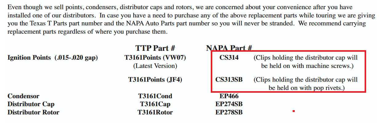

I was working on a friends car and i started it and it quit right away. Getting spark at the points but nothing at the plugs. Do i need a new cap or rotor or condenser? Can i get these parts at an auto parts store? I had heard they were vw. Thanks.
From their instruction sheet....Parts are available at auto parts stores. They have NAPA numbers so can be cross reference as well
Always take the old parts to ensure a match

Was thinking that ust buying parts to & replacing to see what worked might be the easyway. Then the NAPA reference in the TEXAS T instructions for the condenser threw me....
Since you observed spark at the points then likely the Rotor (Test for continuity from tip to center contact.)
Proformer Napa EP278SB Distributor Rotor $8.49
Proformer Napa EP274SB Distributor Cap $8.49
Ignition Points (.015-.020 gap) T3161Points (VW07) latest version CS314 $9.49
Ignition Points (.015-.020 gap) T3161Points (JF4) CS313SB CS314 $7.99
