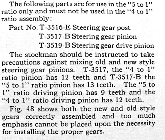

I think there is a Service Bulletin that covers this.
- Posts: 4084
Re: 5 to 1 steering

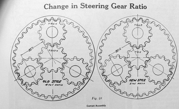

Here's the info:
The important item is the steering post, that has to be the late 5:1 post, as the pinion pins are different center lines than the 4:1 post, that will make it impossible to fit 5:1 gear set.

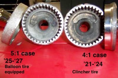

Another difference not mentioned because of tire width.
- Attachments
- late and early case with groove .jpg (28.89 KiB) Viewed 1800 times
