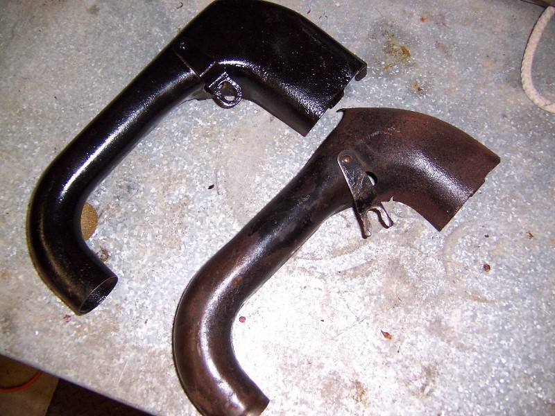

Where would be the best place to access engine vacuum?
I have a spare intake heat exchanger and was wondering if I could harness enough vacuum just ahead of the carburetor.
The only other place I can think of is on the intake manifold, but that would be post carb and would possibly interfere with combustion/fuel/air mixture etc…

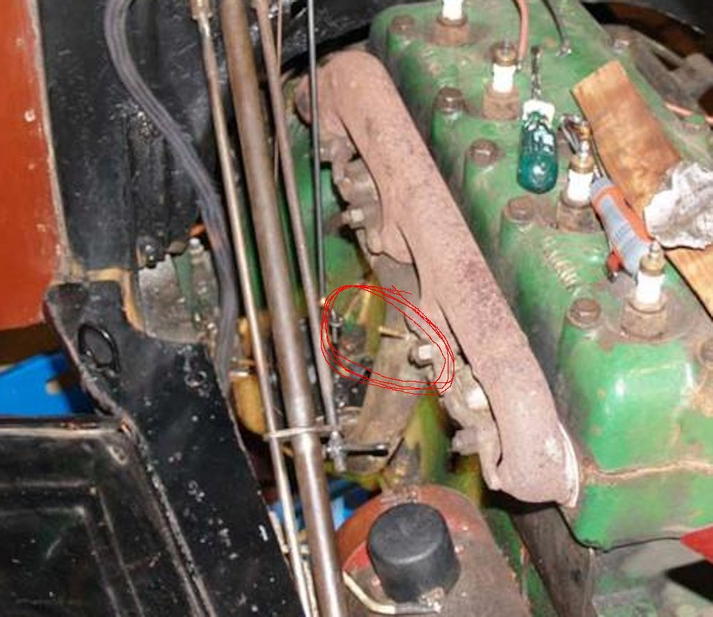

I actually stole this picture from this site, I would put the line as close to the carburetor as I could.

Post carburettor is the way it is done on my 1924 Tarrant Special tourer which has the fuel tank under the spare tyre carrier at the rear of the car. This is needed for a Stewart vacuum tank for fuel delivery. The same applies to another car modified by Duncan and Fraser to accommodate a dropped fuel tank under the front seat.
You will not get much vacuum from an ill fitting heat shield on a T carburettor.

I have vacuum taken off the inlet manifold after the carburetor. This is used to power my Trico vacuum windscreen wiper. It is by way of a brass tube fitted into a hole drilled in the inlet. This is the usual location used locally and gives no impact on combustion as it does not alter the mixture as such and barely affects the volume of flow into the engine.

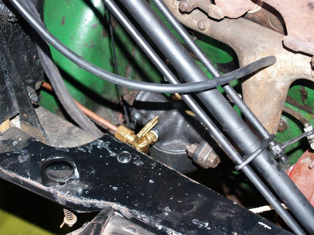

I ended up putting a 90* on the backside of the intake.
It's not visible except for the vacuum hose, if I were to plug it, at the 90 or with the 90 removed. it would not be visible at all.
