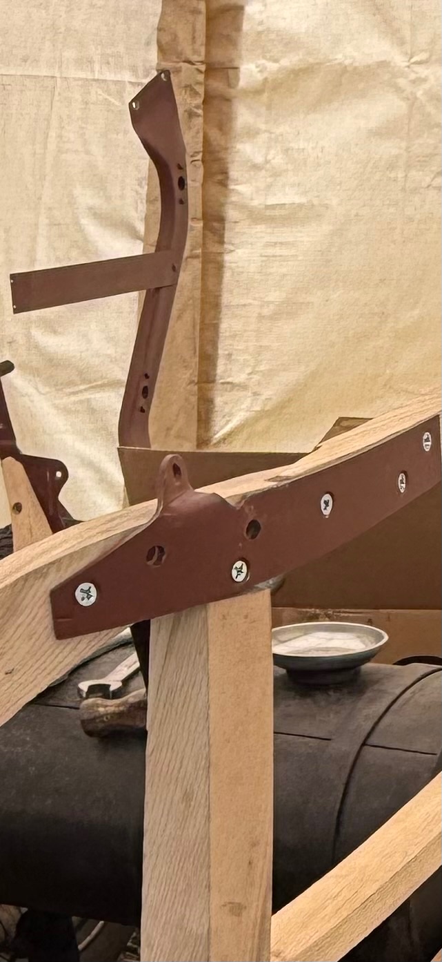

I’m making some serious progress in rewooding my Touring. I’m to the point where I’m fitting body panels and am looking ahead for supplies. Does anyone know a source for the rivets that attach the cowl above the #2 pillars? I don’t see them specifically listed in any of the vendor catalogs. Would they pull double duty somewhere else on the car? Or is there a source somewhere else that doesn’t require you to buy them by the pound? Any help is appreciated.

Try typing the size you want in the search box. They would be called flat head rivet. Don't get stainless steel. I would have to check the hole size so just did a quick search of 3/16 diameter flathead rivet and good number of listings. I am working on a 1925 too but am not going down that far, just enough to take the cowl top off and remove the pressed steel door hinge support pillar so I can do a quick wood replacement.

Just an FYI, I believe that the use of Phillips head screws in a Model T is prohibited under Federal law, punishable by imprisonment in a shuttered, former Ford assembly plant in your state for not more than four hours.
But seriously folks, since Big Flats Rivet Co. went away, the only place I know of that MAY have them is McMaster-Carr.

Perhaps Robinson screws with the square hole would keep one from detention. The Canadians used them in their T's. They are actually better than Philips heads, but Henry wouldn't pay the royalties for their use.

Thanks for the suggestions, guys. I think I may have found what I am looking for. Open car door hinge pins are 3/16” with truss heads. I’ve got some bent ones that I kept from a previous car. I doubt they’re hardened, so I should be able to cut them to length and use them. If that doesn’t work, I’ll reach back out. Either way, I’ll update here for future searches. I am also starting think that the rivets used to attach the windshield clamps to the front bow are the same size and head, just longer than needed.
Another double-duty fastener that isn’t explicitly listed by the vendors are the 1/4” bolts, 3/8” across the flats, with a tall head, used to attach the rear quarter panels to the rear center panel. They’re the same ones used to attach the Model A fuel tank to the firewall.
