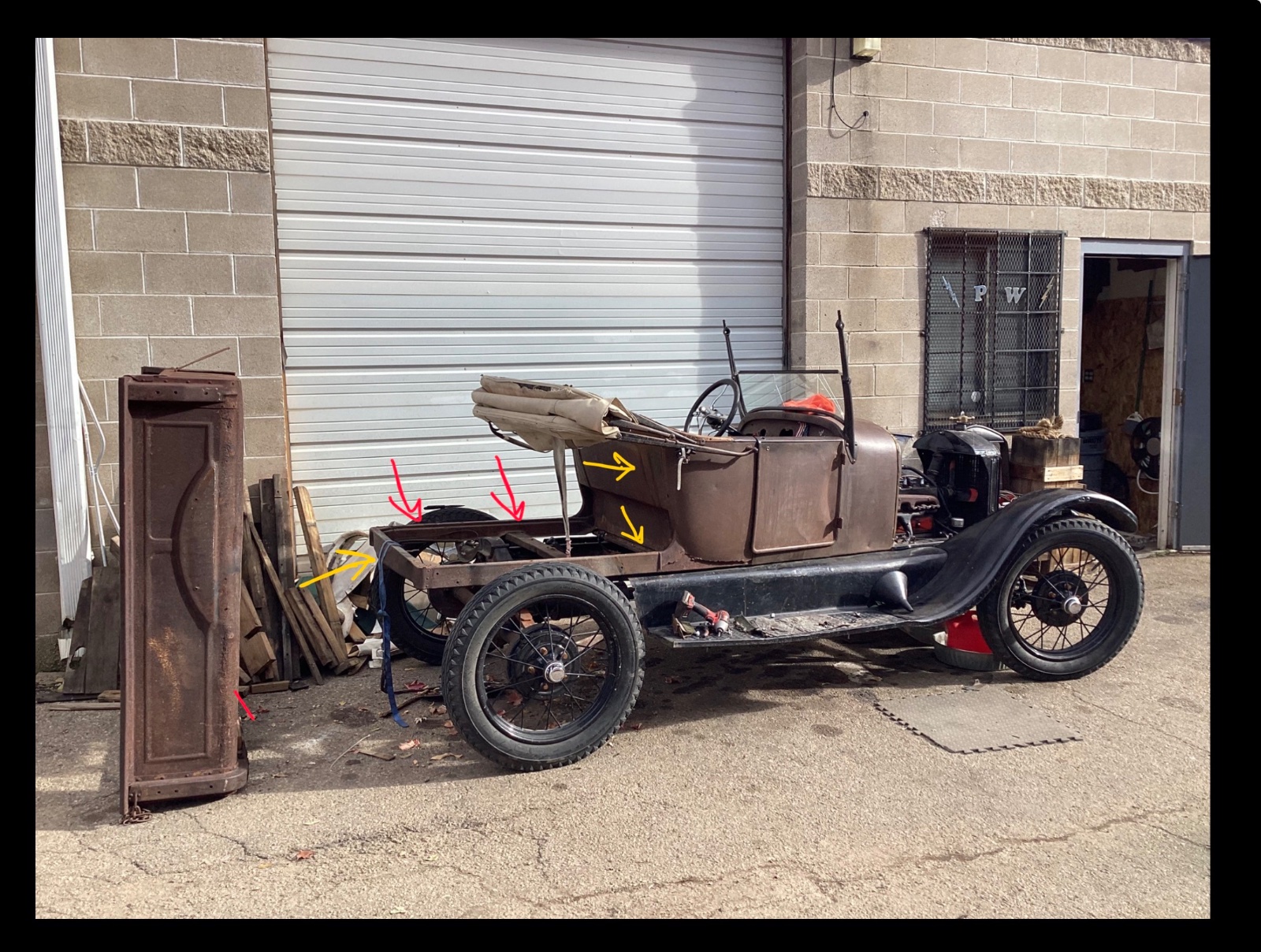

If you don’t have help you can gently pry it up, slide some lumber under it, lift the whole car on stands then string the turtle or the bed up to the rafters in a garage. Once you drop the car out from under it it can be rolled clear and a cart (which I’d recommend having ready to move and store the turtle) or stands can go underneath. Or course two or three extra helpers makes it a lot easier. I’m sure the slip in bed will have its own instructions or logic for mounting but the turtle deck is really only held on by a series of bolts. I’m also not sure how the rear fenders mount on a wood bed, but it should be fairly straightforward…
Good luck, have fun and please post up some pics for us! -Chris, in Boulder

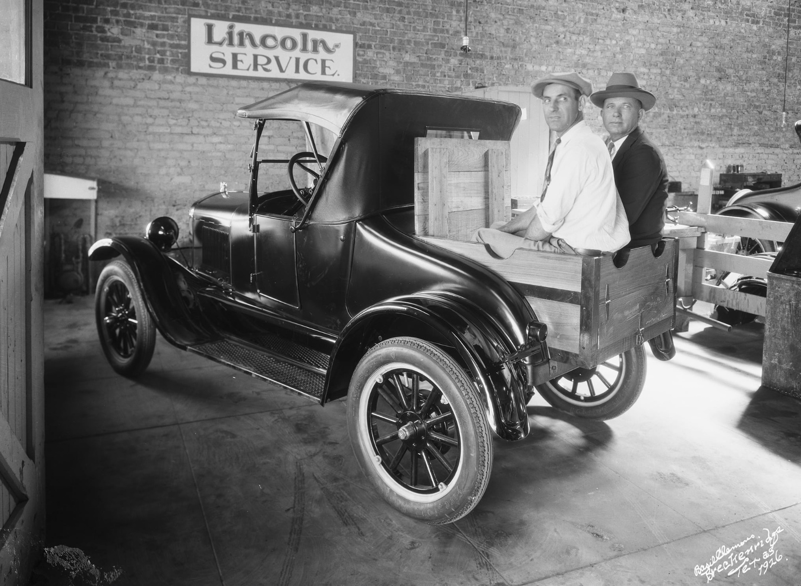

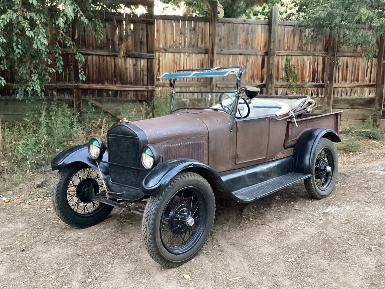

Or......just leave the turtle deck on, remove the lid and rear deck panel. Then make a slide in box ;)
Box with rear fenders bolted to the bed sides.

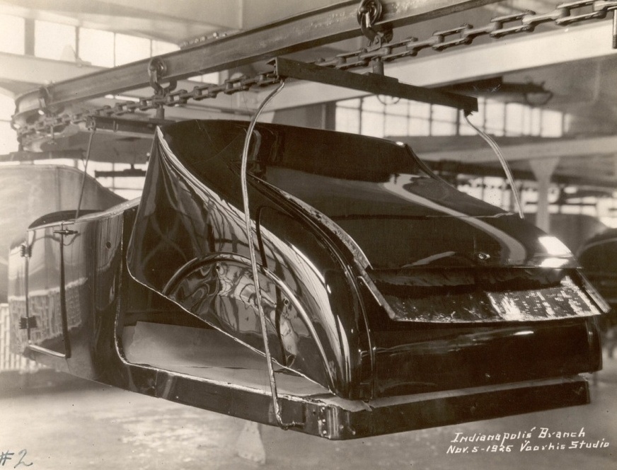

Factory painting the deck before it gets bolted to the runabout subframe.

Thanks for the information and especially the pictures. I found that it was simply attached with 6 bolts. After the bolts were removed it took just a little prying at the back to release it and slide it off. I really appreciate the help.
