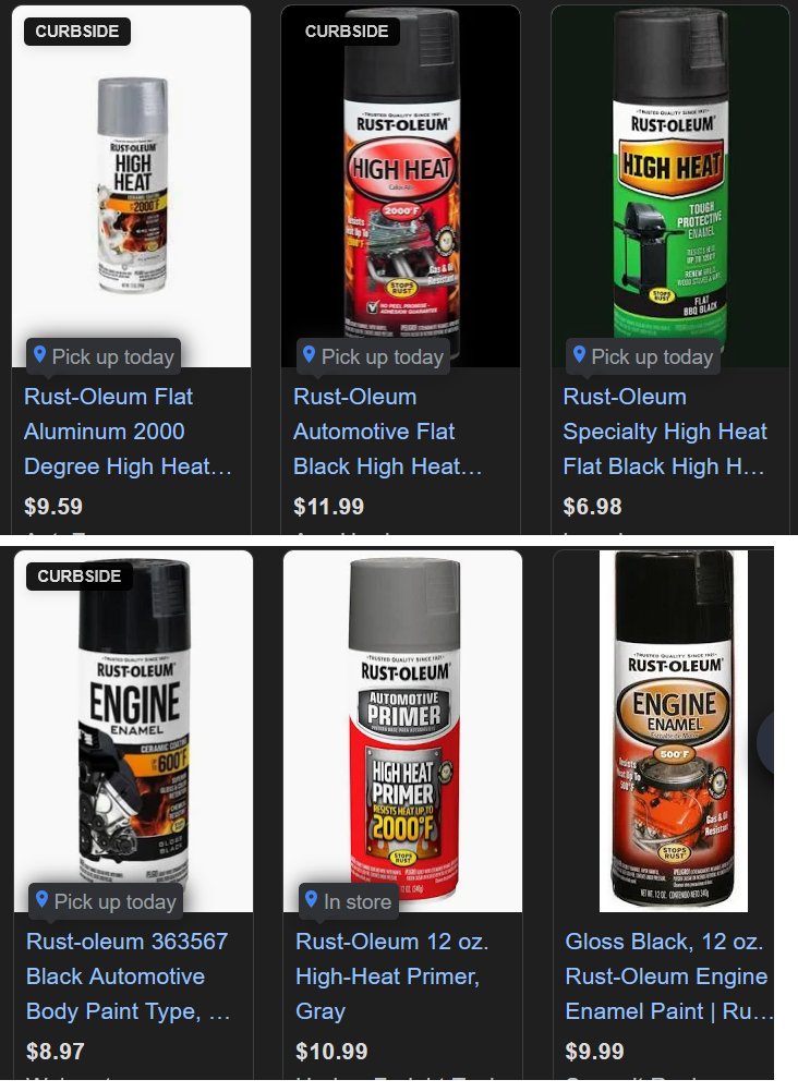

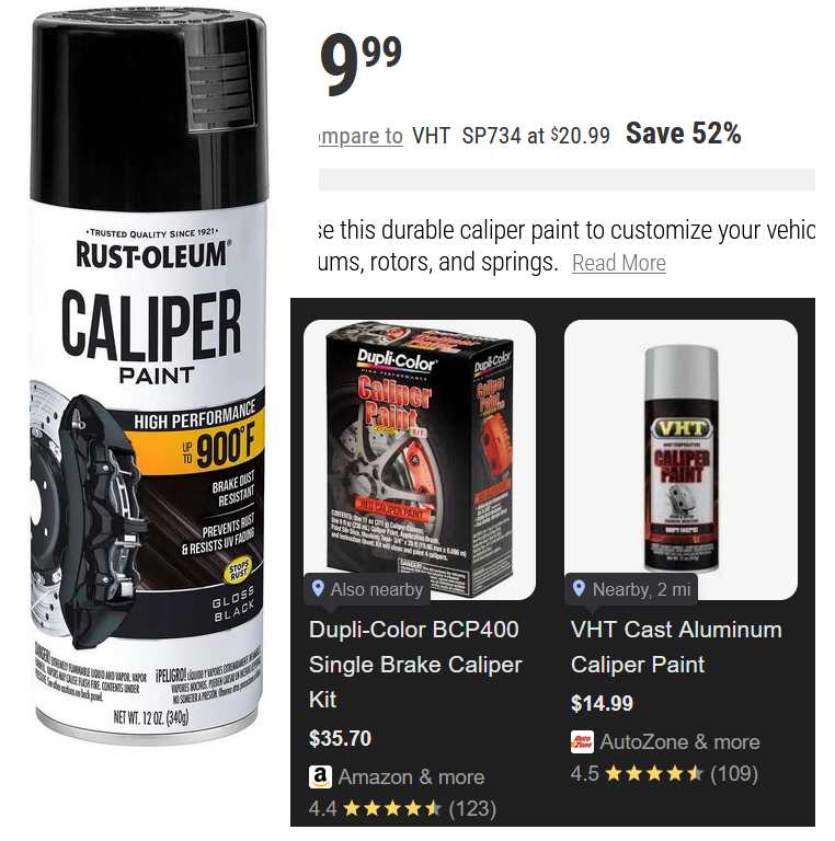

Re: Tips on paint for brake drums?
If your worried about heat Caliper Paint, engine paint or High Temp paint. Otherwise same as frame or jazz up the speedster with color
I used the Duplicolor as it was only type available in 2009 on my daily driver.

I paint drums with ordinary Rustoleum, like the rest of the wheel. It's no problem.

Hi Morgan,
I'll go out on a limb guessing you have Auxiliary outside brakes? Frank is spot on Rust-Oleum makes the High Heat 2000* F in gloss black black.
I use tractor paint on my T's & have A-C & Rockies on them & have never had the paint blister & burn off. I have seen over adjusted Rockies
catch fire but after that new paint can be put on the drums when they & the linings are replaced.

We used the VHT caliper/drum paint.
