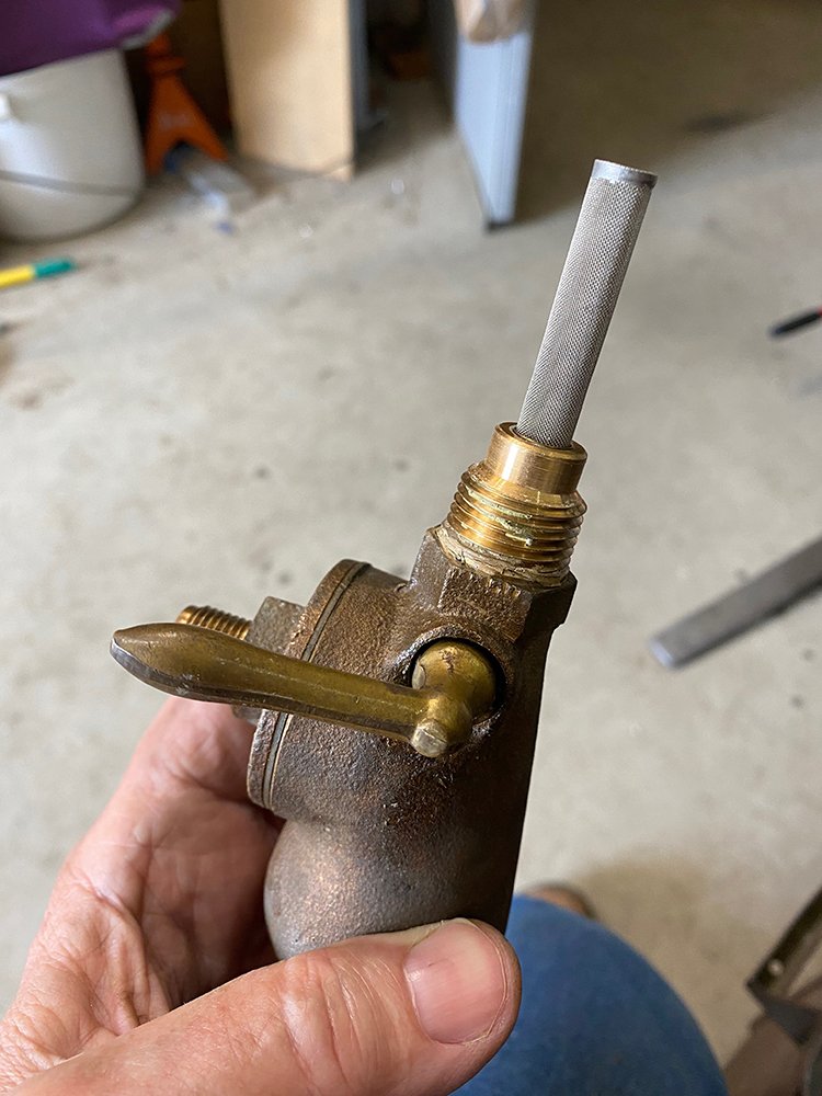

I recently had to replace my original 1916 round gas tank. the left end had been cut open by a previous owner and poorly repaired. When it started to leak last year I attempted a repair with JB Weld's Tank weld. It held a year but I pulled on a loose end last week and it pulled right off. Due to time constraints I ordered a new tank from Kevin Prus with the idea of eventually repairing the original.
Back in 2018 I had cleaned the tank using the POR 15 system. I was very careful to follow the instructions completely and made sure it was perfectly dry inside before pouring in the resin. It seemed to be holding up well.

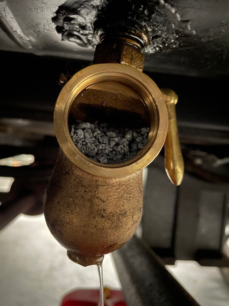

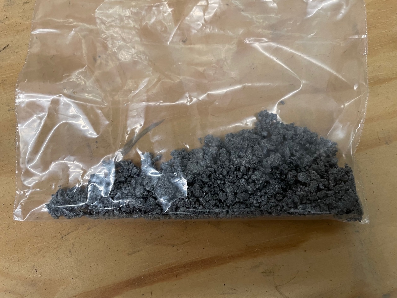

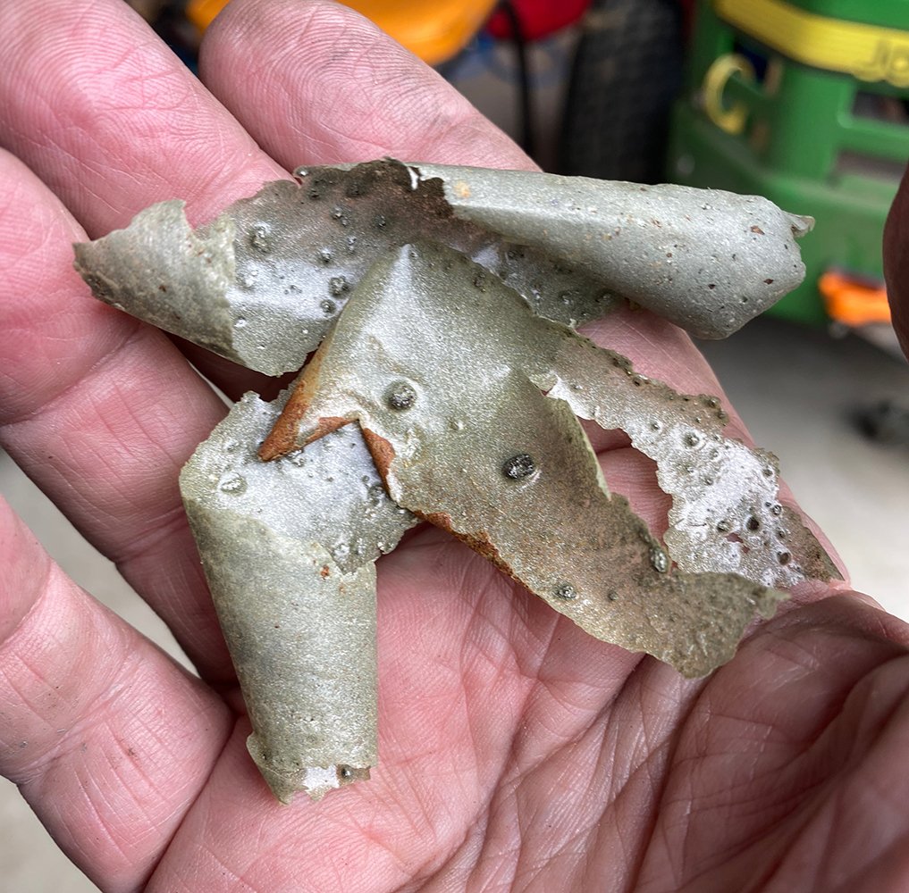

Without going into details, I noticed the lining of the tank coming loose. Using a tool, I fished out several good-sized pieces of the lining (pix 1) which tells me it is coming loose within the tank. Fortunately I had modified my sediment bowl to accept a finger screen from a Model A (pix 2) or some of the lining might have drifted over the drain opening and cut off the fuel to the carb.
Perhaps others have had better luck but I won't be using the resin again.
Pix 1 Pix 2
Pix 1 Pix 2

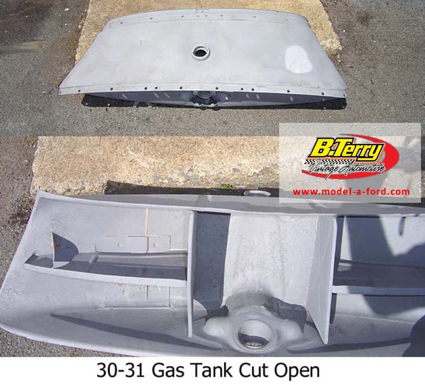

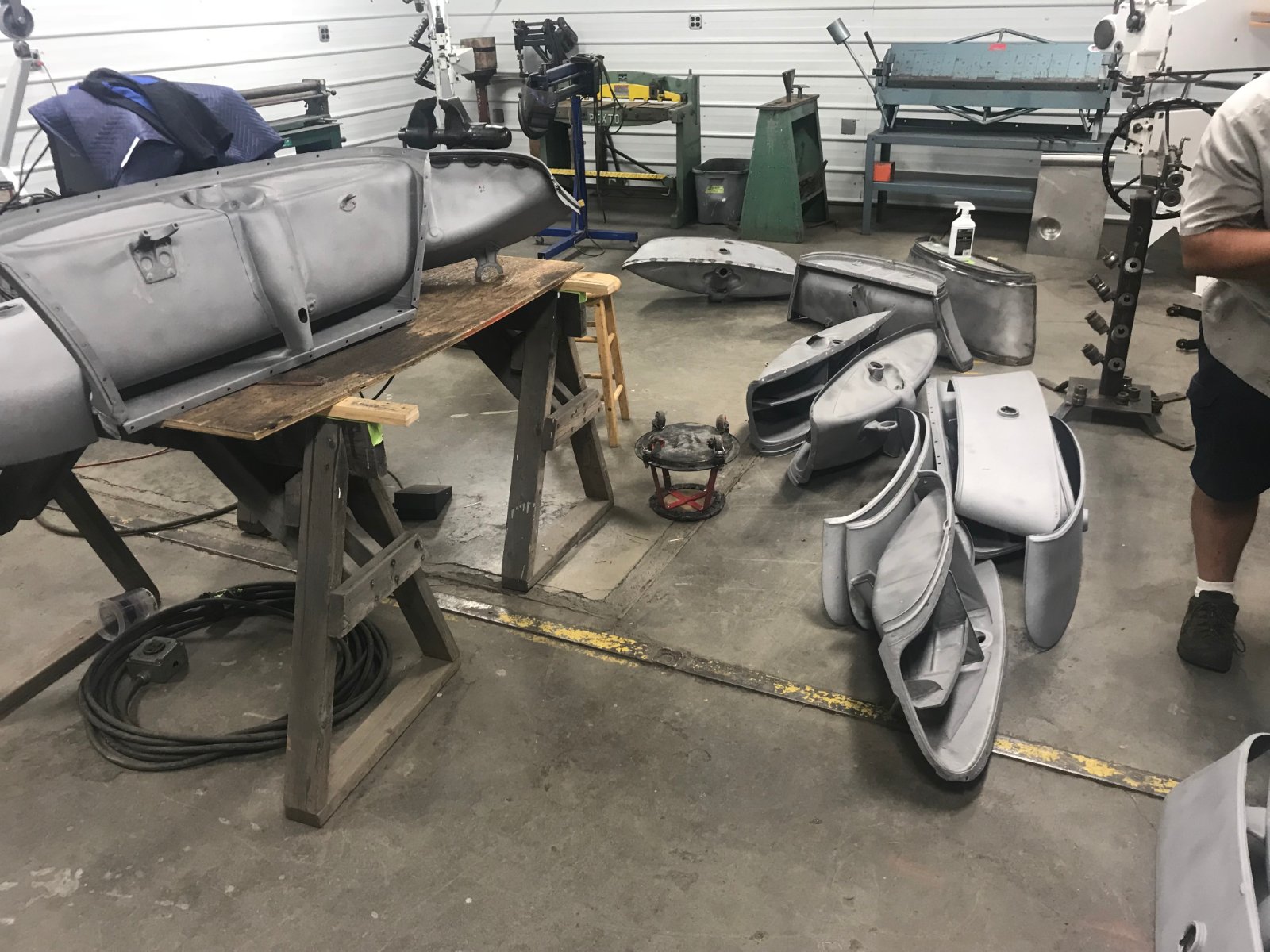

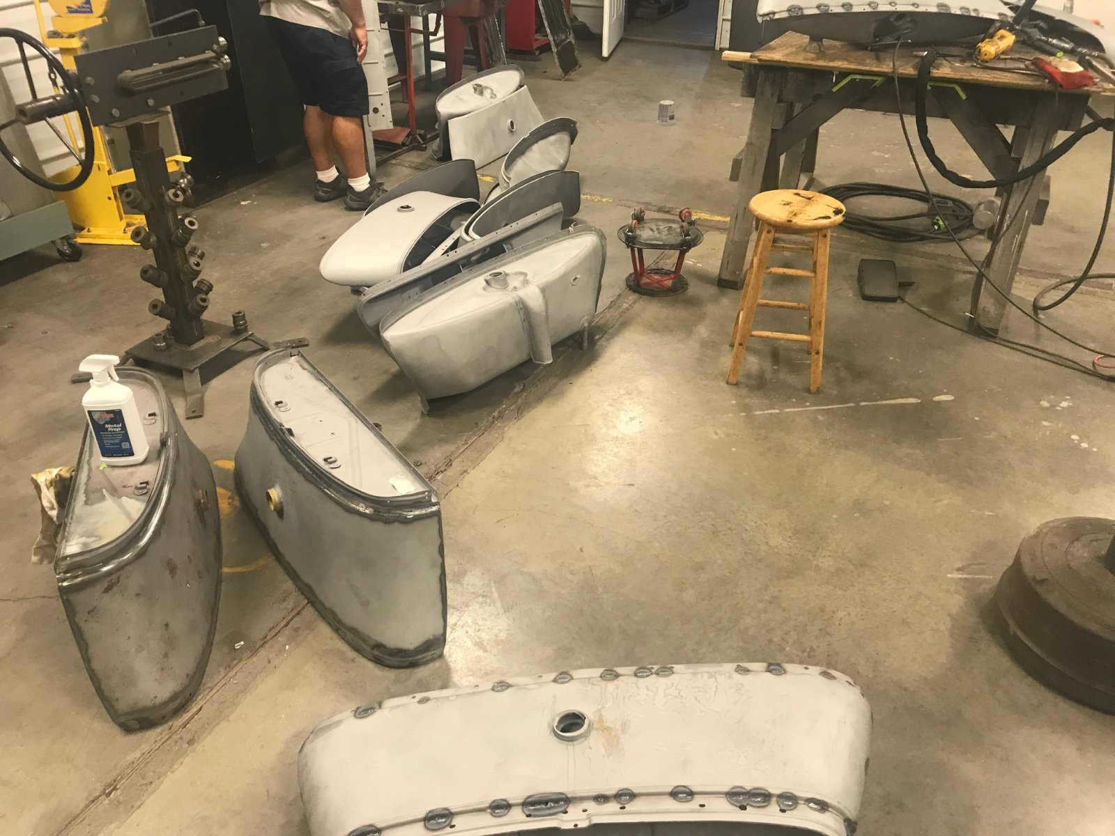

Tim, we are the largest restorer of Model-A Gas Tanks, and the only thing that we have found that will partially dissolve the coating is a 15% mixture of hot Sodium Hydroxide and water. Generally we soak the tank for a minimum of 12 hours in around 210° Sodium Hydroxide solution. Sometimes it softens it enough where it flakes off, -and sometimes it only softens it where it will need to be scraped out and then the remaining sealer can be eroded with media.
In all instances, when the urethane is found to be releasing from the tank wall(s), the issue is/was dirty metal underneath. Since we cut the Model-A tanks apart in the factory weld, we are able to access the entire inside of the tank. We generally use aluminum oxide to clean the metal and also apply a light texture in which the urethane sealer has something to easily make a mechanic bond. While I do like (-and use) the POR Sealer, we do not like their Tank Etch product as it does not provide adequate abrasion of the metal to create that mechanical bond for the sealer.

I'm sure you are correct....the most likely culprit is the preparation. I followed the instructions as best I could but could see only a small area of the cleaned tank through the filler hole.
Opening the tank as you describe sounds like the best approach....it certainly gives you the access needed to do a good job. There are commercial operations that restore gas tanks and in retrospect I should have availed myself of their services.
