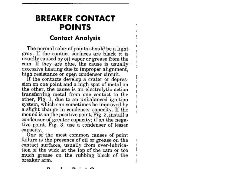

I drew in an optional shunt to bypass the ballasts at start, in case the starter draws the voltage too low for a quick start. I run a 6 volt system, and have not had a n issue, but with dual it may be an issue.
I have also shown a condenser diagnostic chart in case we need to change the condenser value.
Be advised with dual propagation, your peak cylinder pressure will occur sooner, so you will have to retard the advance to adjust for this.
