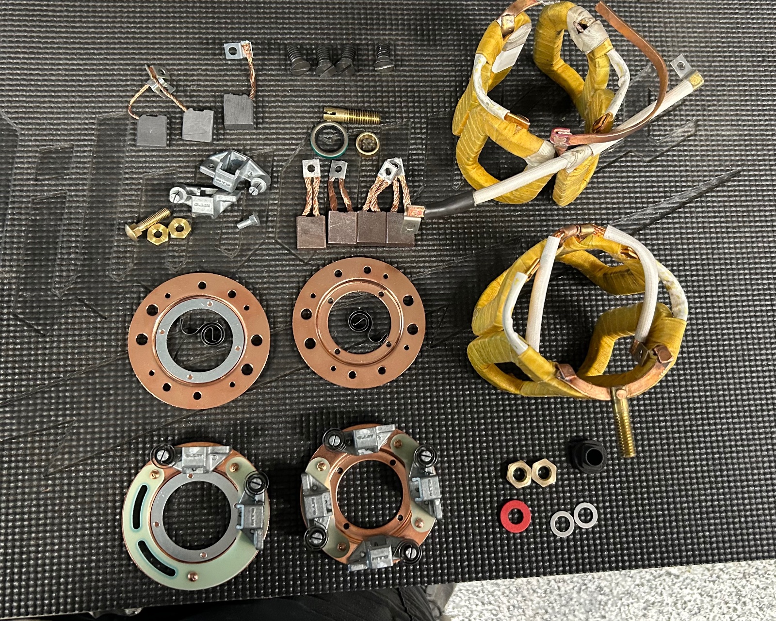

Was so excited to get our new starter that I installed it last month and tested it out - problem solved.
This month, I removed the starter, made a gasket and installed it again - still starts.
