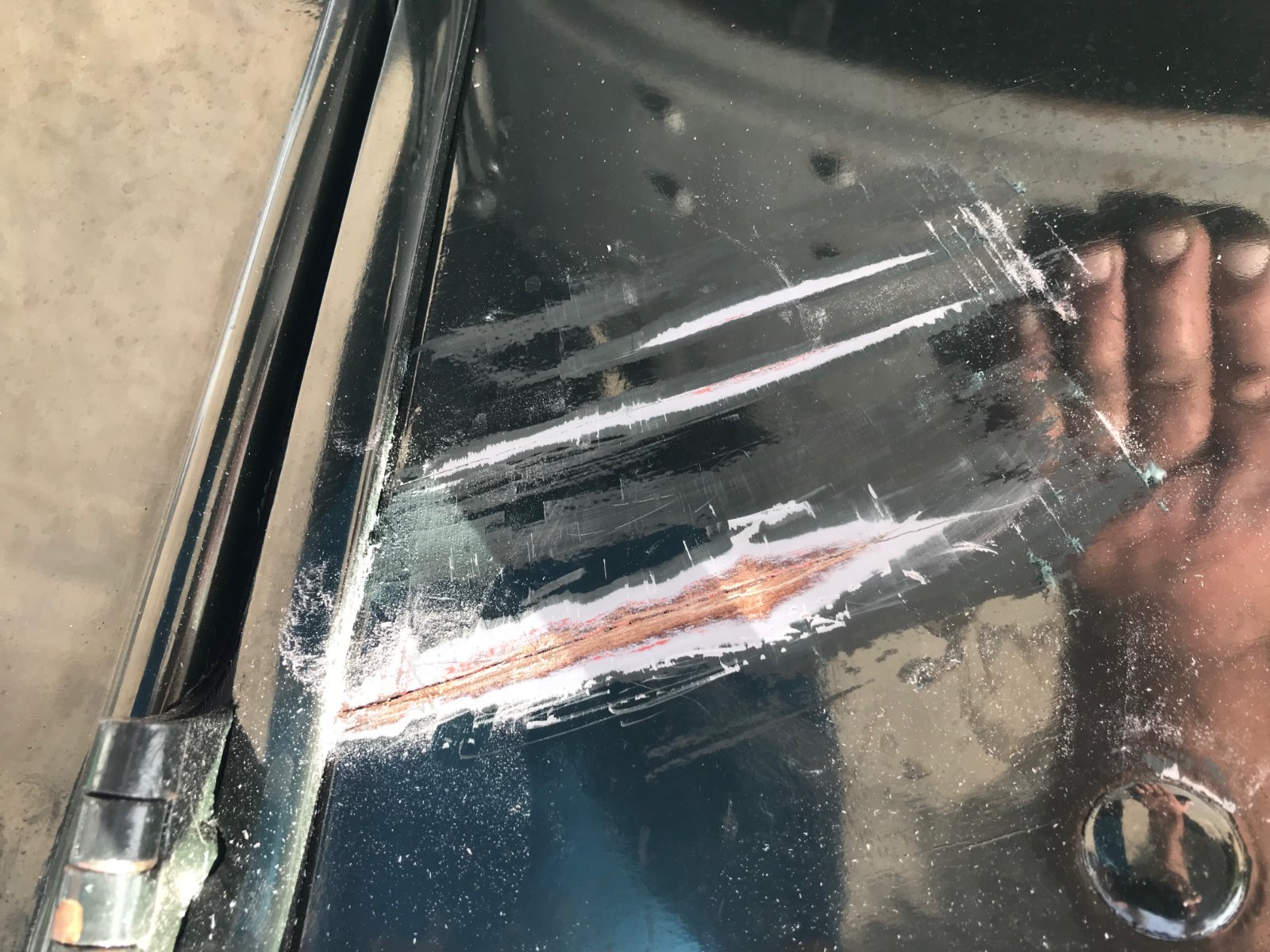

I have the same problem with the body I just purchased. It has a crack in the rear door caused by mishandling. Because the crack was not caused by the body twisting as when the car is driven over on uneven surface I have no problem using a wood filler. I am tempted to hunt down someone who restores horse-drawn carriages to see what they recommend, however.

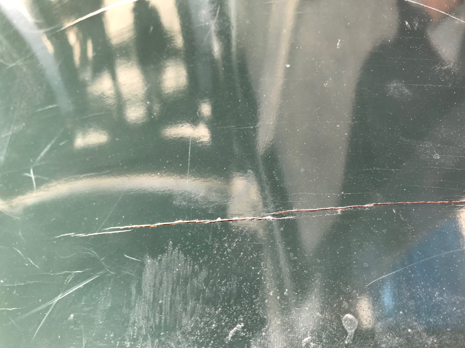

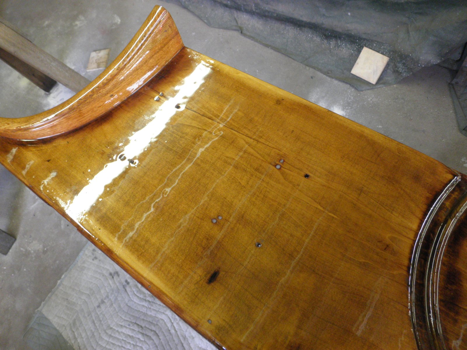

Strip to bare wood (I prefer a heat gun / scraping followed by hand sanding) and then coat, sand, recoat as needed with West System to block to your desired level of flatness. No need to V-out the crack. Over time with the different rates of expansion you will faintly see the crack line telegraph through and there is nothing you can do about that, but if you V it out you will see a line the width of the V where the epoxy is more dense.
This was one of several cracks in this body fixed in such a way and none have come back and cracked the paint. The second photo is the same area eight years later. If you catch the light just right you can just barely see it and the other cracks on that panel. I've had success using this process on another body much worse than this. It's a bunch of work but prep is everything if you want it to last.

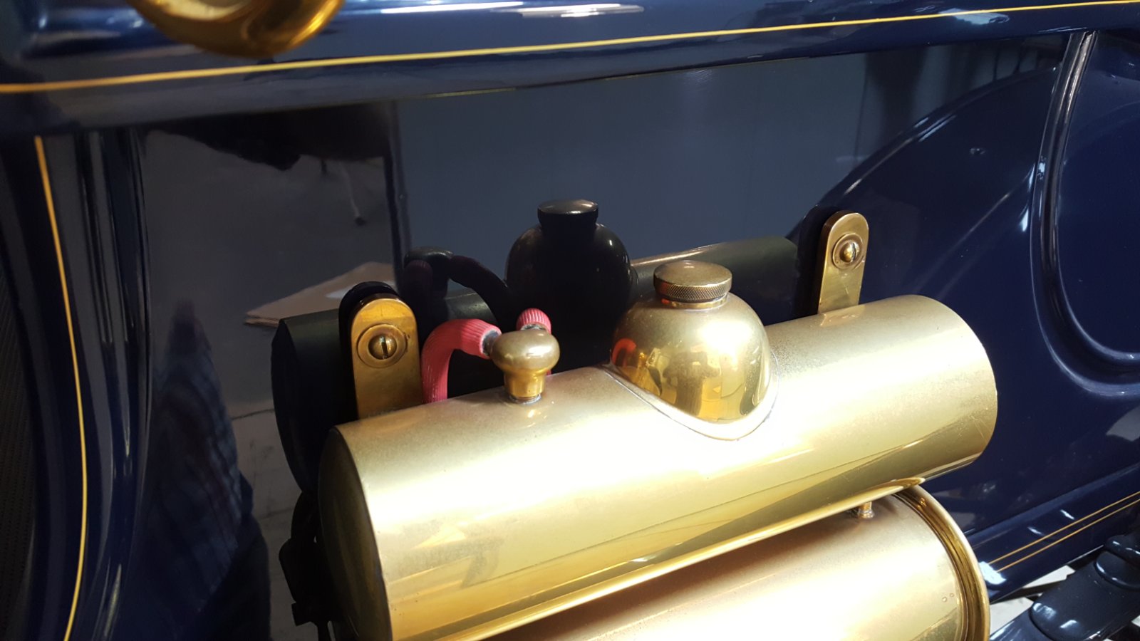

I used the West System on the 1909 I am restoring. I had many cracks and some complete loss of wood especially around the rear fenders. The only problem I found was that it works better if it’s horizontal, that’s why some of pictures show the body balanced on its nose...
I refrained from responding earlier as I don’t know how it will hold up, but the guys tell me to expect 20-40 years, by which time I doubt I’ll be around to care.
I painted the body by hand using enamel paint and covered it all with Spar varnish which has help up on the boat for close to thirty years.
