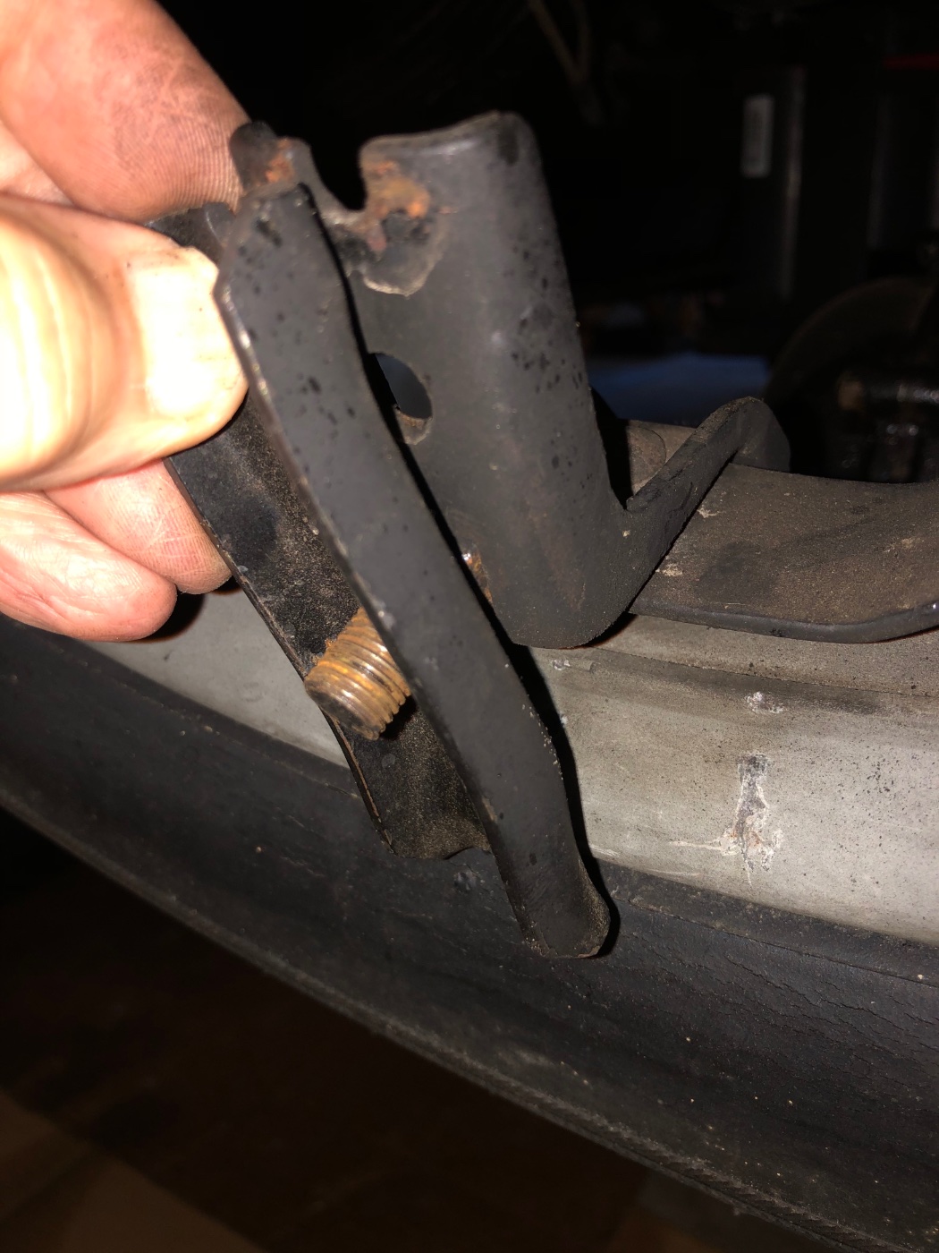

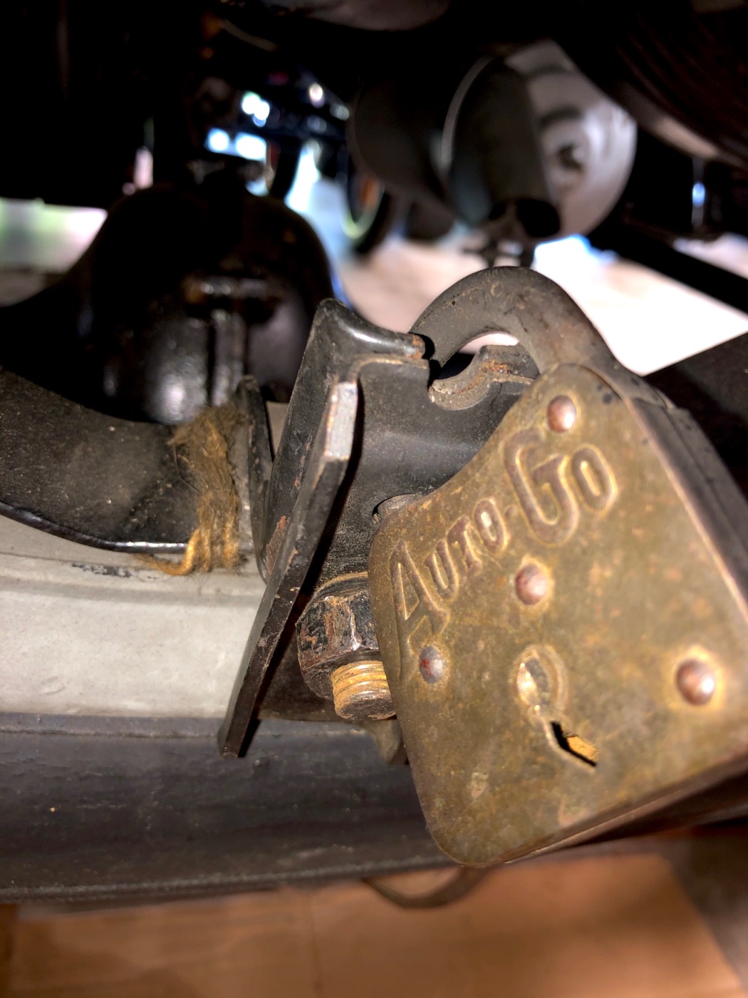

Here you are:
And you can add a padlock to the clamp to prevent rim and tire theft

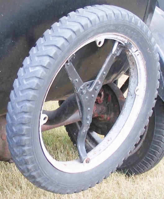

- Posts: 5587
Re: Y spare tire carrier and 2849D
He was asking about a "Y" carrier - mine has just has a stud - either goes into the rim tab or into one of the wire wheel holes.

Missed that, was thinking only of the 2849D clincher 30" tire clamp used 1921 to 1925.
The Y bracket is for the '26-'27 mounts that are on the body. The Y 2873 is for balloon tires, 21".
The lower stud fits to a rim lug nut to secure the rim and tire. There is a flanged rim nut with holes to also chain the tire and rim with a padlock
