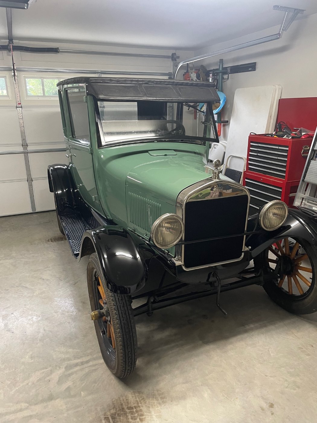

The car looks great. You might want to check the car's glass to see if it is, or is not, safety glass. The original glass, windshield and windows, was plate glass, which can be very hazardous in even a minor accident. Plate glass may not be road-legal in some jurisdictions.
