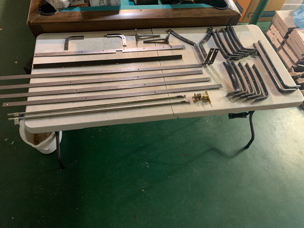

Well after about 10 years of collecting parts and research I've officially started on building my delivery car body. I do this kind of stuff when I have time and $. Thought you all would like to see the progress so far.
Here is all my body irons made up I ordered some Ash wood from the local Amish mill for the sills and the rest of the platform.
I started with a square straight frame and it's great to see everything lining up where it should be. Once I finish the platform I'll move the platform to the body dolly I made to move it around easier to finish the construction.

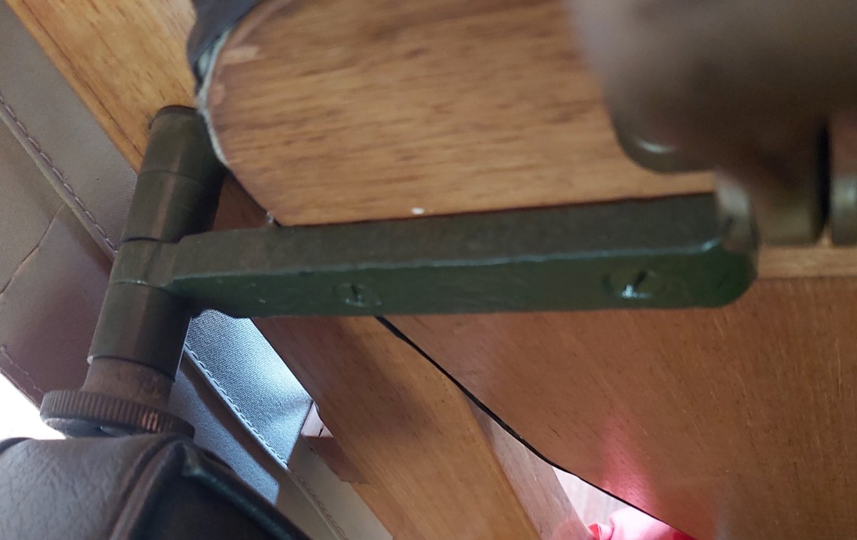

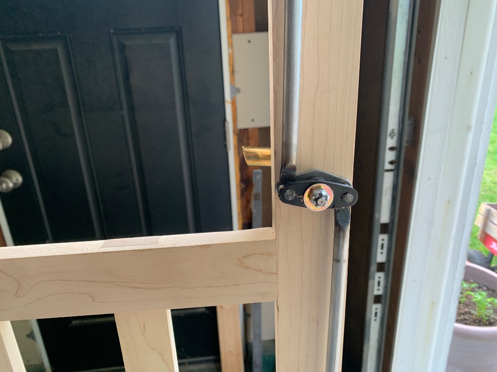

Here you go Mike. The seat back has a frame, and thinner boards are rebated into it from the front. The seat springs are attached directly to the boards. I set the hinge into the base board so the seat cushion does not foul on it.
The rake adjuster bolt goes through the pillar from the front. 3 x 1/2" spacers go over the bolt so multiple take angles are available. The knurled nut allows easy adjustment, although I have not needed to shift it from the initial setting. I made all the bits for this, smithing the iron bits from old iron, and using alloy rod for the spacers. The knorled nuts were in my cache of stuff.
Hope this helps.
Hope this helps.

Very intrigued! From the looks of it the adjuster is underneath so you can’t see it. Here is what I’m running up against if I were to do something like this. The seat risers and seat frame pieces have two brackets bolted on top of the seat frame that in turn bolt to the ribs on the side of the body and onto the structure that makes up the seat. Also the seat back has two pieces of wood that is at a slant that is bolted to the rear seat riser on the top and bottom. I also thought of moving the seat risers back about a couple inches but because the seat risers are placed by the pillars if I were to move the side pillars back it would throw off the way the sides are shaped. Photos are from the delivery body that Bill Brommer (RIP) made for Craig Beek.

Mike, the timber through which the adjuster bolt passes is the vertical body pillar at the back of the front seat. The bracket is at the top of the adjustable seat back, behind the seat.. I took the photo from behind the seat, looking forward.
On the framework of that build you show, the equivalent vertical timber is the first full height one from the front. The flat steel piece is fixed to the seat back, with the piece extending out behind the vertical body member. The only modification you might need to make is to delete the vertical seat back timbers, and maybe make the frame which sits on the seat risers a couple of inches wider at the back.
Let me know if this is not clear.

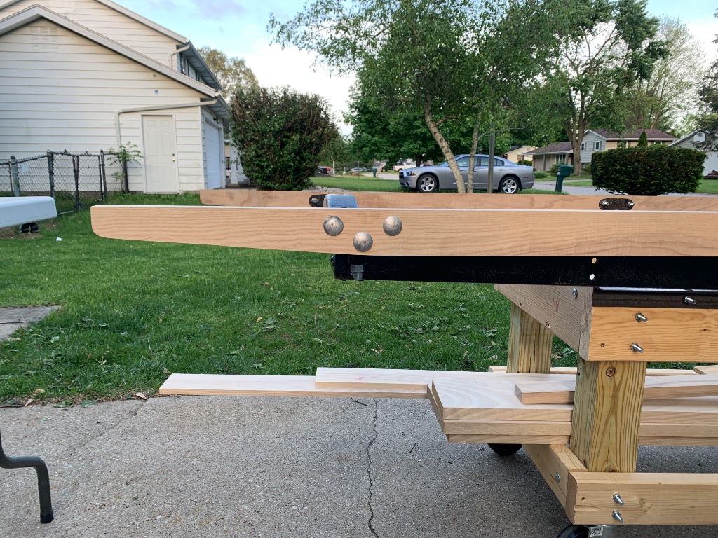

Well I spent most of the day cutting the wood for the floors. The floor runners are pretty complex with the amount of cuts needed. The floor runners go from the front of the firewall to the rear floor board. They involve bevel cuts on the outside part way up to the front seat riser then a tapered cut that you can see I made a pattern for in the picture below. The floor runners also have a rabbet that runs part way up to the rear seat riser. This build has really stretched me in my carpentry skills. I still have to cut the other rabbet and my tapers and then I can fasten the floor runners to the sill runners and install the rest of the floor.

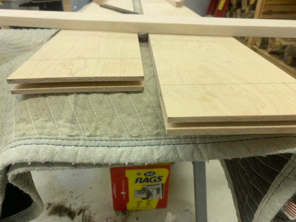

Worked on a few little details today. I got my seat riser floor boards done and started to mock up the front floor board firewall risers. Hope to have the platform completed this week but we’ll see…

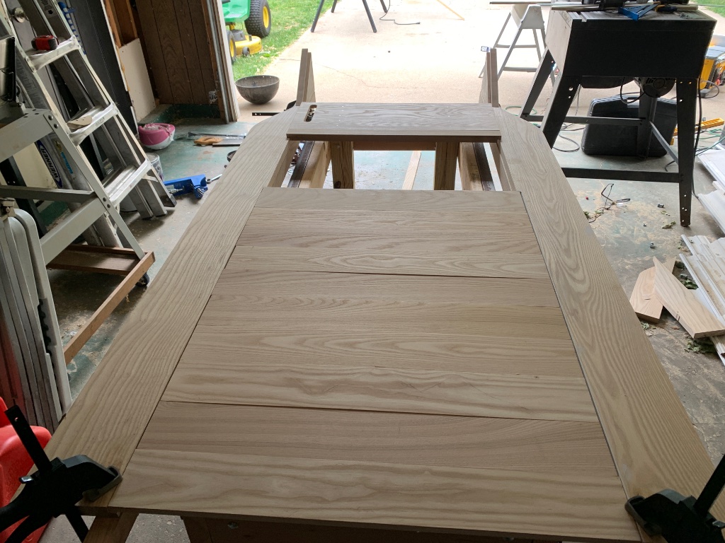

Did a little more work on the Delivery car floor. I had to make several patterns of the area where the floor runners swoop into the firewall. Looking at several pictures I’ve settled on what I wanted it to look like, I think I’ve come really close to what looks correct. The floor runners are very complex with the amount of cuts and details needed to complete the platform. I’m not finished yet with the platform but getting closer…

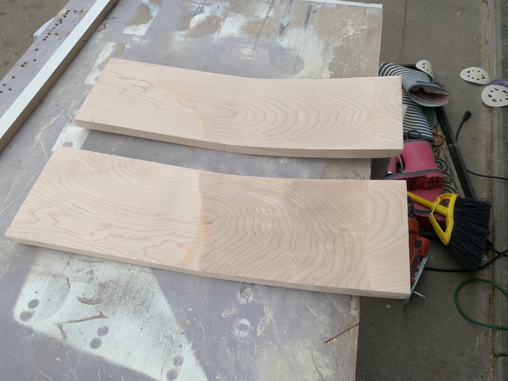

It was a week of setbacks this past week. I Got all my floor runners mounted to the sill runners and all the floorboards are falling into place where they should be, but then I was working last week on the pieces known as "Bar C" that runs under the body and ties the floor boards together and my bandsaw blade broke... I tried to get one locally but of course out of stock, so I ordered one and should be in later today. I've drawn up some patterns for the side ribs based off of dimensions on the blueprints and the body irons that I have, hopefully I will be able to get to those next week. I also was in the process of mounting my butterfly brackets to the body and found out I forgot to get the step bolts for those. I had the step bolts for the butterfly brackets to the firewall but not the body a quick call to Langs and hopefully those will be in this week as well. However I did have an interesting surprise. I was in need of #18 flat head wood screws for my taillight bracket and all I could find was 1 1/4" which is too long. Last summer I picked up a free square grand piano from the 1860's that is going to be used in our kitchen as an island. The piano was beyond restorable but an excellent candidate for a unique kitchen piece. I was removing the hardware for the piano guts and there I found #18 7/8" flat head wood screws! So not a total loss..

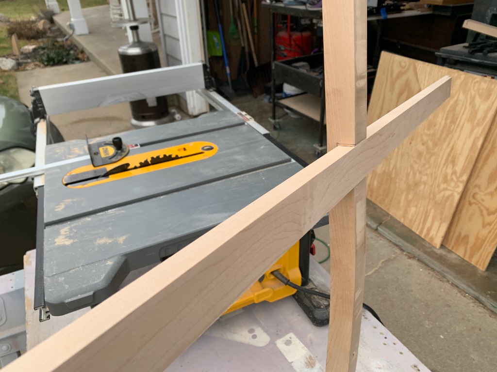

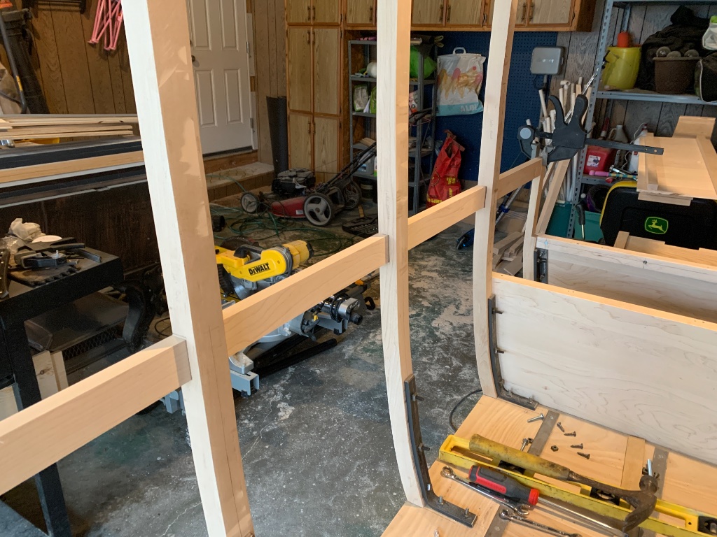

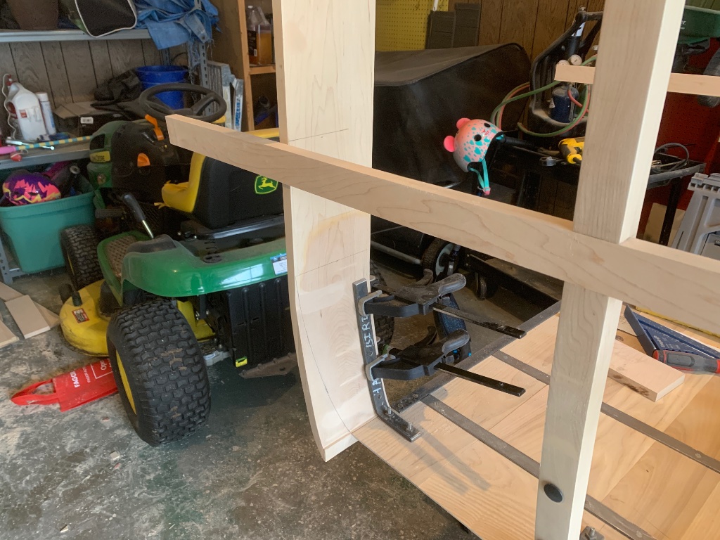

I began cutting my pillars for the sides of the body. The pillars are made from 1 1/2" thick Hard Maple. There is a lot of joinery steps to form the finished sides of the pillars. I have been covering the build quite extensively on YouTube if you'd like to follow along.

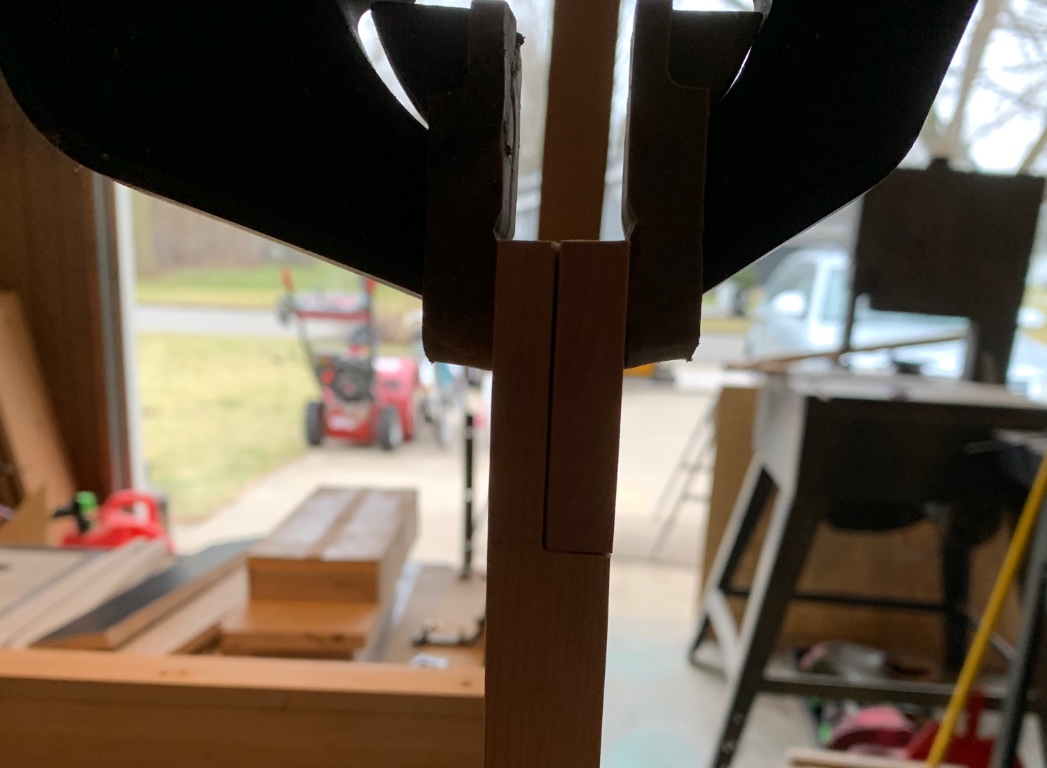

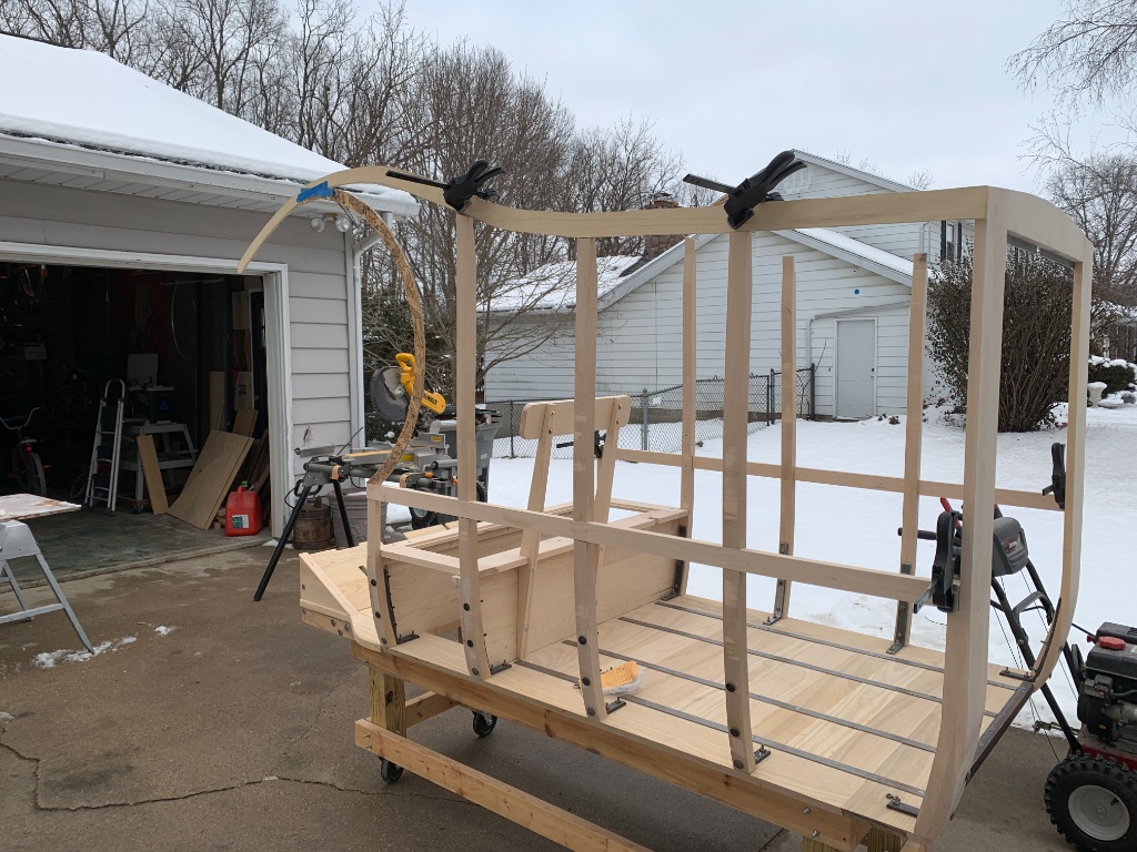

Finished up the pillars today for the Delivery car. The pillars are all different heights and have tapers, notches, and angle cuts on them. Will be mounting them hopefully this weekend.

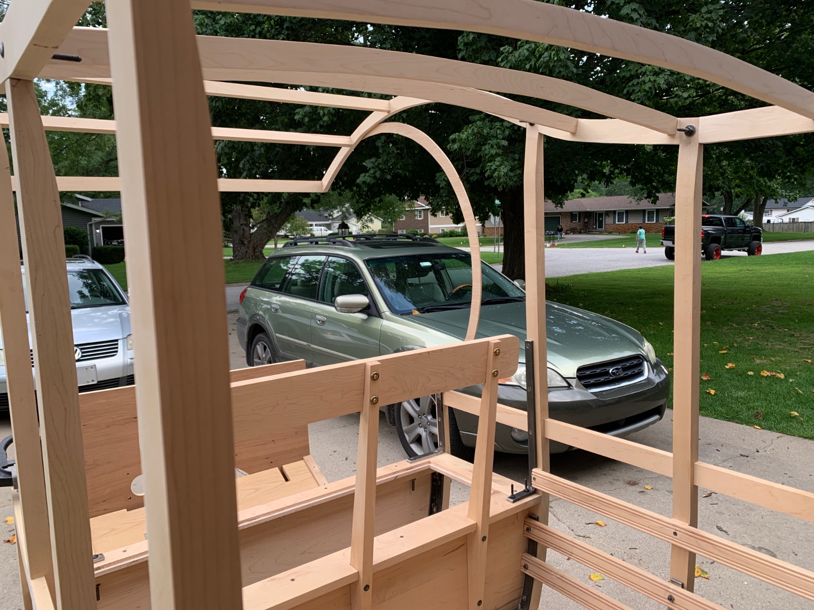

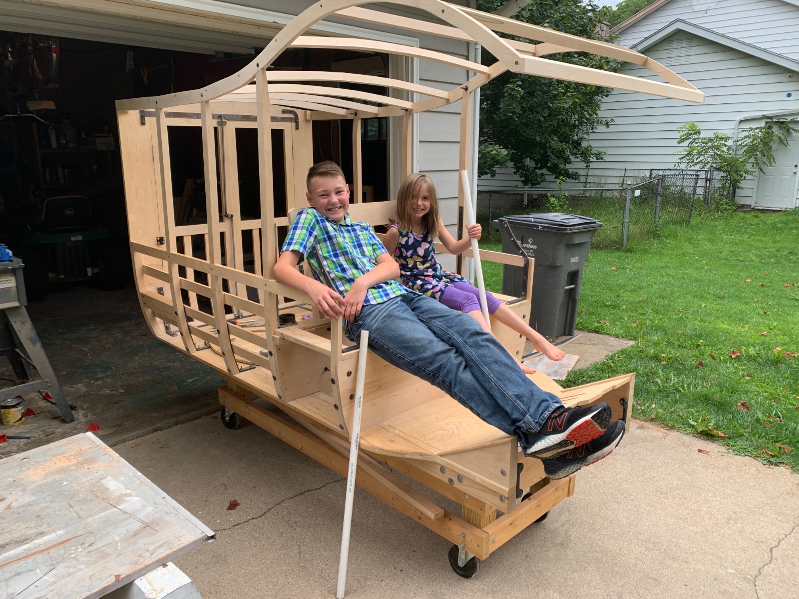

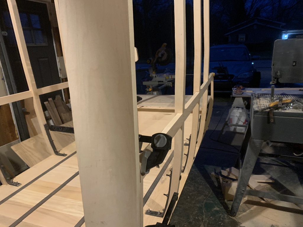

Took advantage of the warmer weather this week and made some more progress. Got the side pillar brackets mounted in place. You can start to see the body taking shape. I positioned the pillars in place but not have mounted them yet. Currently I’m working on the rear door jambs. I had to face glue several pieces of maple together so I could cut out the curved door jambs. The front pillars are not that long, they need to be cut down but I will not do so until the horizontal rib is put in.

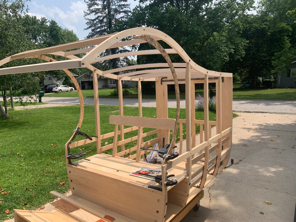

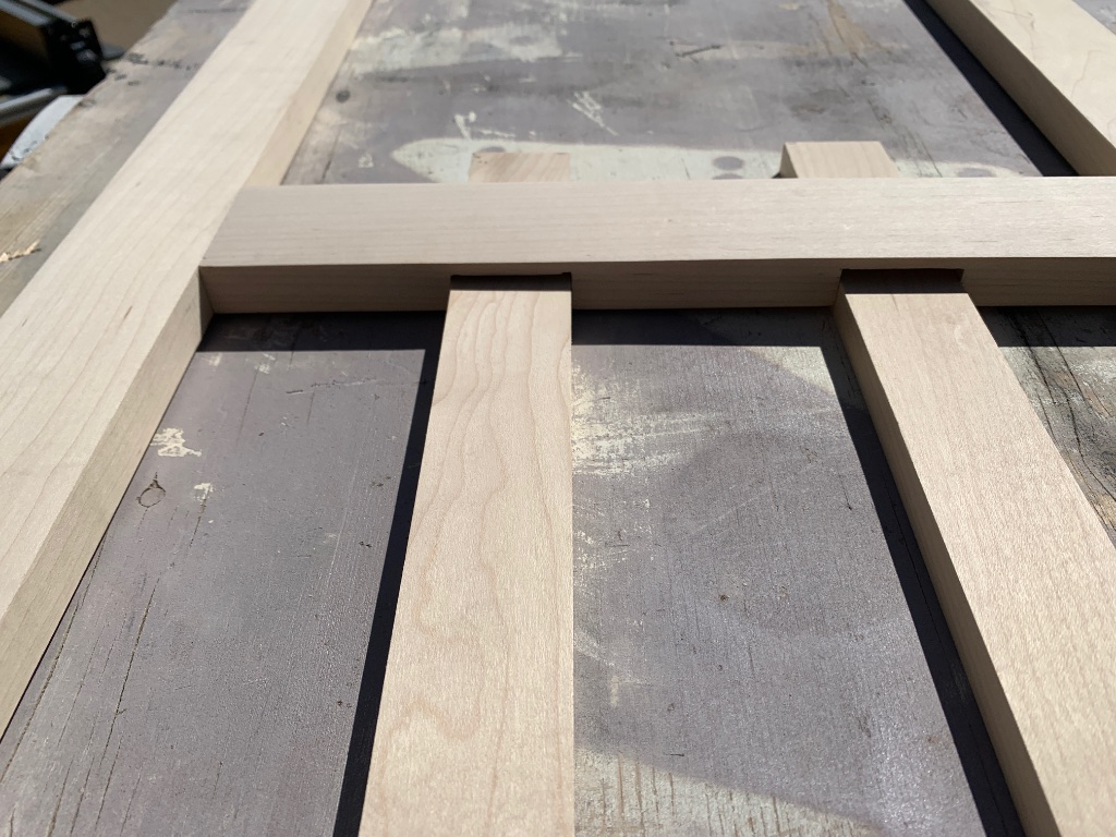

It’s been unusually warm here in northern Indiana and had several days to be able to work outside. Making some more progress on the rear door jambs and got the top of the jambs cut out and shaped. These pieces will allow me to make the rear doors and the top bows.

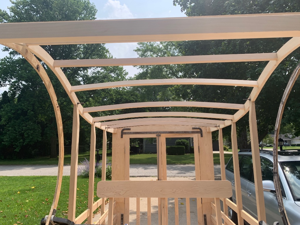

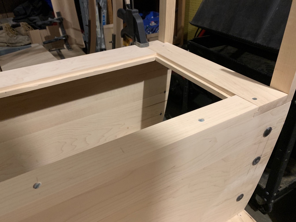

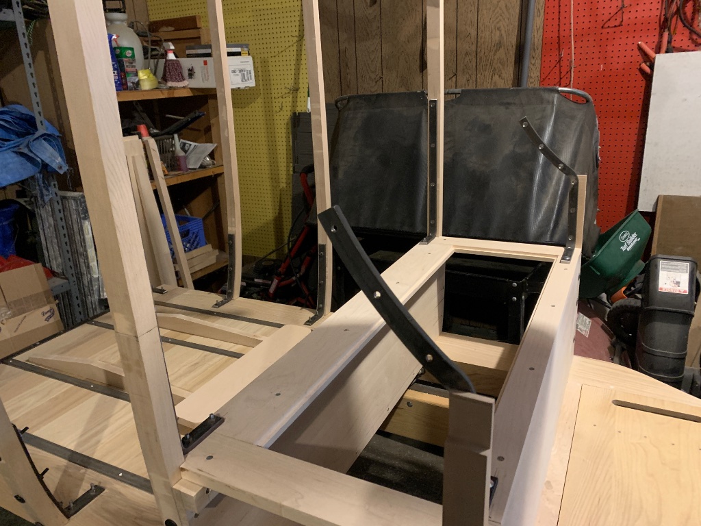

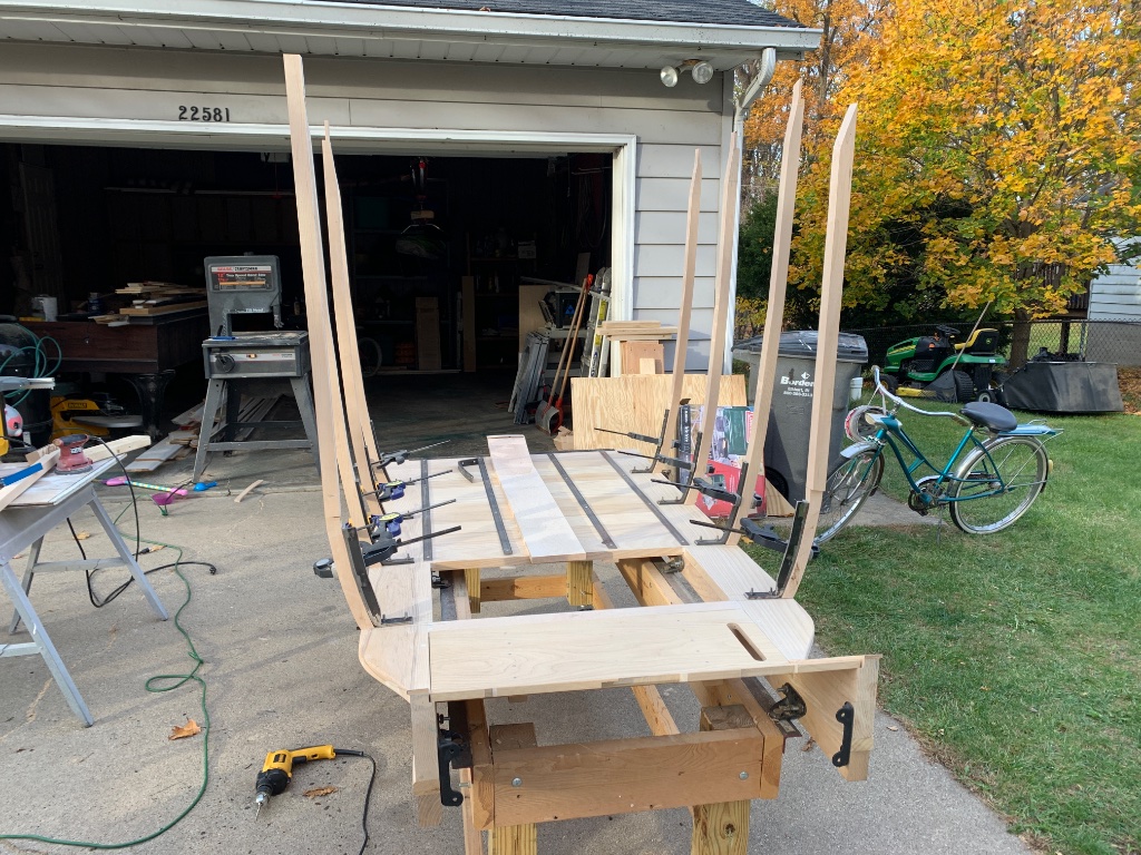

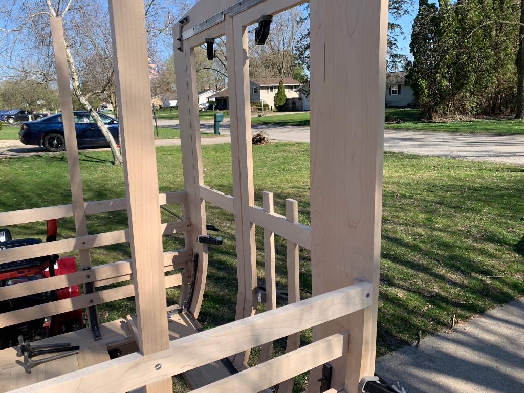

Making some more progress this week. I was able to complete the seat risers, and seat frame pieces. I also was able to get some more pieces ready for the joinery that will be mounting the C section to the roof and the horizontal rib that runs down the middle of the delivery car. I finished up this week with mounting more body irons and lots and lots of slotted screws!
- Posts: 7269
Re: Delivery Car Project Build
Lovely work Mike. It is great to see it come together. How does the seat base accommodate the brackets and bolt heads that attach the irons to the side pillars? They make seating the seat base somewhat more difficult.
From the photos of the almost complete body you posted earlier, there appear to be only two vertical timbers for its seat backrest. Does that indicate that the seatback is only for the driver and the other side is left open to accommodate longer items? Those same two risers are inset into the seat riser base by an inch or so bringing the seatback forward by at least that much. I would be checking your seating position before going much further. I know I keep on about this, but having a comfortable driving position makes it so much more enjoyable to use your T, and now is the time to do it.

Allan, so the seat frame/base is simply attached to the risers with wood screws, there are two long brackets on either side of the seat frame that mount to the seat frame and side post. Those long brackets are mounted with two carriage bolts that come up from the bottom of the rear seat frame piece that is overhanging from the back of the rear seat riser. The rest of the iron mounts to the pillar using #10 1" wood screws. You would be correct in noting that there are only two vertical timbers for the seat back rest. The back rest timers are 2" wide at the top of the seat frame and then taper to 5/8" at the bottom and the top to make for a angled back rest. Those seat back timbers are attached to the seat riser with two carriage bolts on each side of the timbers. I Could make the seat back at a greater angle by making them wider at the top of the seat riser 3-4" and then tapering them down to 5/8".Allan wrote: ↑Sun Nov 20, 2022 1:19 amLovely work Mike. It is great to see it come together. How does the seat base accommodate the brackets and bolt heads that attach the irons to the side pillars? They make seating the seat base somewhat more difficult.

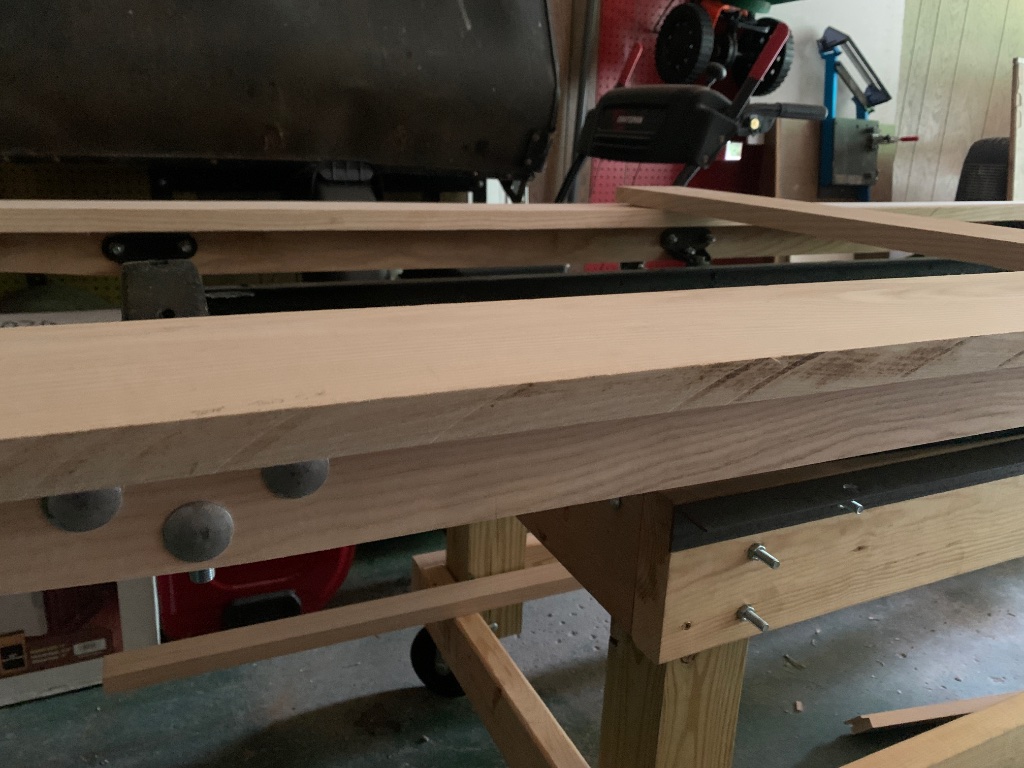

Mike,
Beautiful work! I've got to ask however, are you planning to trim the lengths of these bolts at some point? It would make these joints look as neat and professional as everything else you've done.

Jerry,Jerry VanOoteghem wrote: ↑Mon Nov 21, 2022 12:23 pmMike,
Yes all the bolts will be trimmed to final length. I will not trim them until I do final assembly of the body. Everything can be taken apart still with exception of a few pieces. I still have to prep the wood so it can be painted/stained and areas I want to make sure are prepared with a waterproofing/sealer on the underside. All the bolts after the body skin is in place will then receive final trimming.

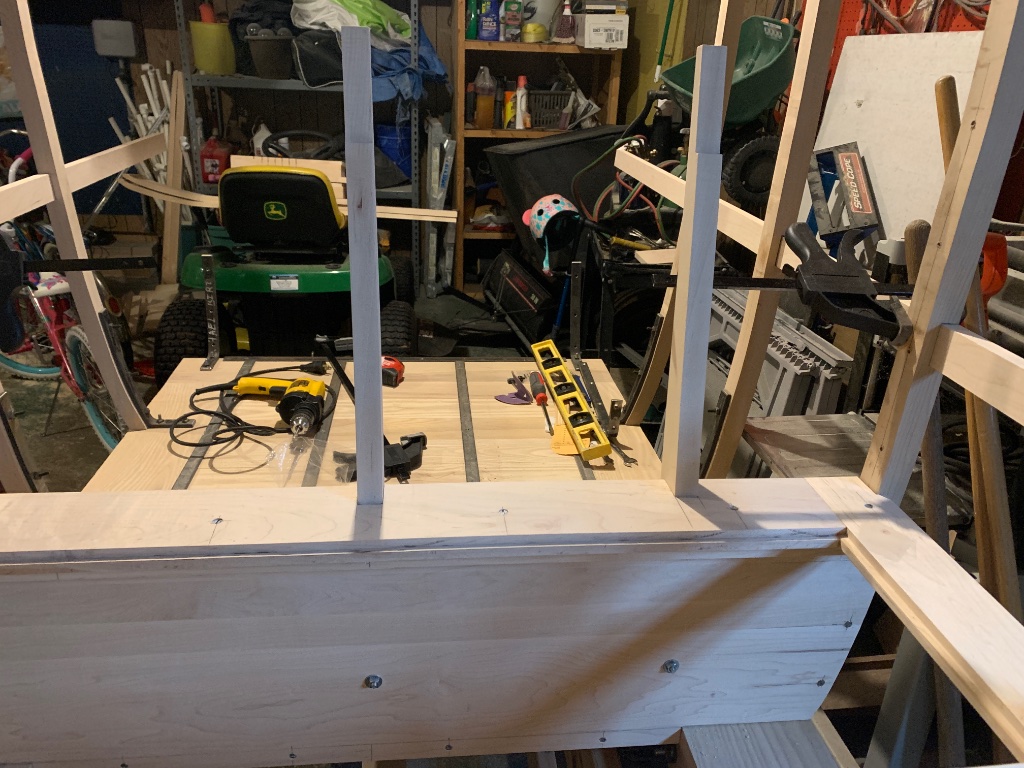

Making some more progress. Working on the horizontal piece that attaches to the side pillars. This piece is what will allow the metal skin to be attached to in two sections. The seam will be hidden by a piece of round moulding down the middle.
That is beautiful work. I'm glad you are taking those pictures. The wood is so much fun to see.
Mike, I see the side timbers fully rebated into the vertical members. Is that how the original bodies were constructed? To preserve strength in the uprights, my gut feeling would have the side timbers relieved and set into shallower cut-outs in the verticals. Perhaps it doesn't matter. You do lovely woodwork. Do you find it difficult to buy stock timber which reflects the heavier spec timbers of old? There's no way I can buy planks of old 1" [22mm]
boards. Everything these days is 19mm.
Tbird
Topic author - Posts: 1339
- First Name: Mike
- Last Name: Bird
- Location: Goshen IN
Allan,
Yes the drawings from Benson Ford clearly show that the side ribs are notched out to receive the horizontal piece that runs the length of the Delivery car. The side pillars are mounted to the floor with the metal braces and a screw from underneath the floor runners. There will be two more horizontal supports on the inside of the delivery car on the bottom section of the pillars, they were more for protection from cargo rolling around the back. I can get lumber if any width and thickness here where I live in northern Indiana up in Amish country.

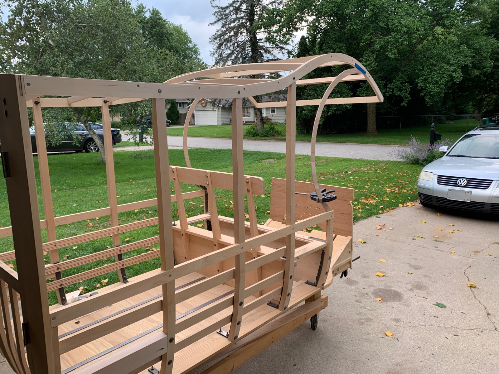

Things are starting to take shape! Got the seat back all done. I mocked up where the steering column would be and pedals, both my wife and I were very comfortable. My wife asked where her seat was... lol I told her I'd be making a wider seat back that would stretch to the other side... Got the door jambs cut to follow the profile of the sides of the body along with the rear door jamb post section to finish the horizontal rib. To end out the evening tonight I was able to join the top header/roof section to the rear door jambs. I was pretty excited to get that piece done.
Some exciting things happening!
Made a cardboard template for the roof rails. I can’t believe this thing is in my garage!
I hope it clears the door opening or it will be in your garage a loooong time!Tbird wrote: ↑Mon Jan 23, 2023 9:38 pmSome exciting things happening!

The roof and the rear doors are probably the most challenging sections of this build. I’ve went through several templates to try to get the C section and the curve of the roof just to mate up correctly. I’m almost there… thanks for your encouragement!
- Posts: 7269
Mike, I made a much shallower compound roof curve when building my shooting brake. The key to making it uniform lay in the straight, consistent grain in the western red cedar laths. Each bends at the same rate when fitted over the rials across the body. I used brass crews at the ends of the laths, and at the bottom of the downwards curve behind the cab. Elsewhere, brass tacks were used to hold them in place.

Mike, do you know if the original door vertical timbers were cut back to back from solid timbers? I can understand why you chose to make them the way you did. It would require a very solid piece of lumber to start with if they were to be made in one piece.
When I built my two shooting brakes, one 1927 and my later on a 1917 model, I cut the top side planks to their curved profile from flat planks.To get them to bend in at the front to align with the windscreen i used a trick an old timer suggested. I passed the front end of the boards over my sawbench, making a cut in the middle of the board, feeding it through until the cut no longer came out on the other side. Then I made a filler piece from the same timber and fitted it in the sawcut.
To make a 3"bend required a 3" timber to clamp the side boards to on my workbench. The filler was glued on each side and inserted in the sawcut. Then, with the board clamped to the 3" spacer, the front of the cut end with the spacer was clamped down to the bench until the glue dried. In effect, the front of the board was laminated. This eliminates any cross grain weakness in cutting curves from solid timbers. No_one has ever picked how the bends were made, but some have been intrigued when it is pointed out to them.
I mention this only because it may be of use to others where a bend in timbers would lead to a more pleasing, less boxy design.
I look forward to the paneling of your piecart, even though it will hide much of your craftsmanship.

From talking with John Regan the curved pieces were face glued blocks of wood. What you're saying though about cutting the wood totally makes sense, I just found it easier to face glue them and cut out the curve. I'm not too sure the body makers would have taken the time to do as your describing (I could be wrong thought) since the delivery cars were painted the red body color inside and out so you would not see the difference in the grain in the wood when the wood was painted. However, I will be staining the inside of the body wood and so the difference in the grain will show. I'm going to try my best to have it look really sharp and not stand out as much. I'm planning on using a cherry stain either from Old Masters gel stain or a cherry stain from Laurel Mountain Stain. I saw Frank Seress' Town Car done up in the cherry stain from Old Masters and it looks sweet. I'm planing on painting it the dark midnight blue.Allan wrote: ↑Fri Apr 14, 2023 10:55 pmMike, do you know if the original door vertical timbers were cut back to back from solid timbers? I can understand why you chose to make them the way you did. It would require a very solid piece of lumber to start with if they were to be made in one piece.

Worked on getting the rear door latch assembly put together and mounted. I'm simply amazed at the simplistic mechanical function they used back then.
- Posts: 7269
The rear door latch mechanism works so well, the exact same set-up was used in the 1960's Morris/Austin mini vans. The rods simply pushed through holes in the floor and the top reveal, and when they wear they rattle like all he'll was breaking loose. Yours should not do that!!!

Finally got the roof rails cut out and got the top bows (9 of them) cut out and fastened. Next to finish will be the “C” sections, which will then finish the whole profile of the body. Getting closer!

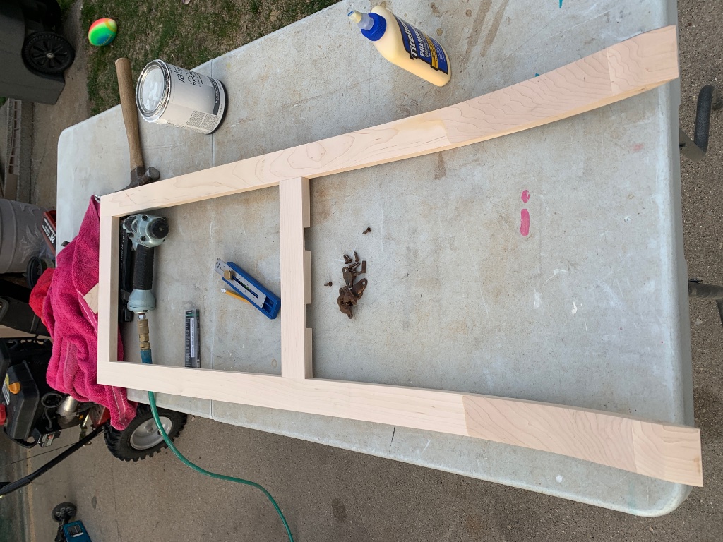

Some more progress...
Made up the templates for the "C" pieces
Put on the leather door straps
Mounted the fender blocks for the rear fender irons to bolt to

Got the “C” sections done. My daughter wanted to lend “dusty ol dad” a hand along with a neighborhood boy who was intrigued with what I was building in the garage. I asked his parents if he could come over for a little bit if he wanted to help. He was pretty excited to help do some sanding.

Its going to be a pity to cover all that beautiful timber work up. Great progress.
Arbs
- Posts: 216
- Joined: Thu Oct 06, 2022 8:42 pm
- Last Name: A
- Location: Pennsylvania
- Board Member Since: 2022
Beautiful work. Kudos for accomplishing that in your 2 car garage.
