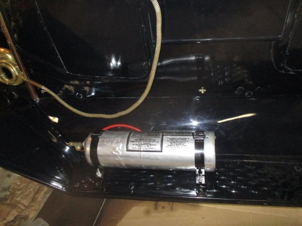

Here is my Prest-O-Lite tank:
It is a B type tank.
Restoration Supply has a decal for the "E style" tank, which is shorter than the B.
I got my "B type" decal from a forum member who had some made.
Keith
