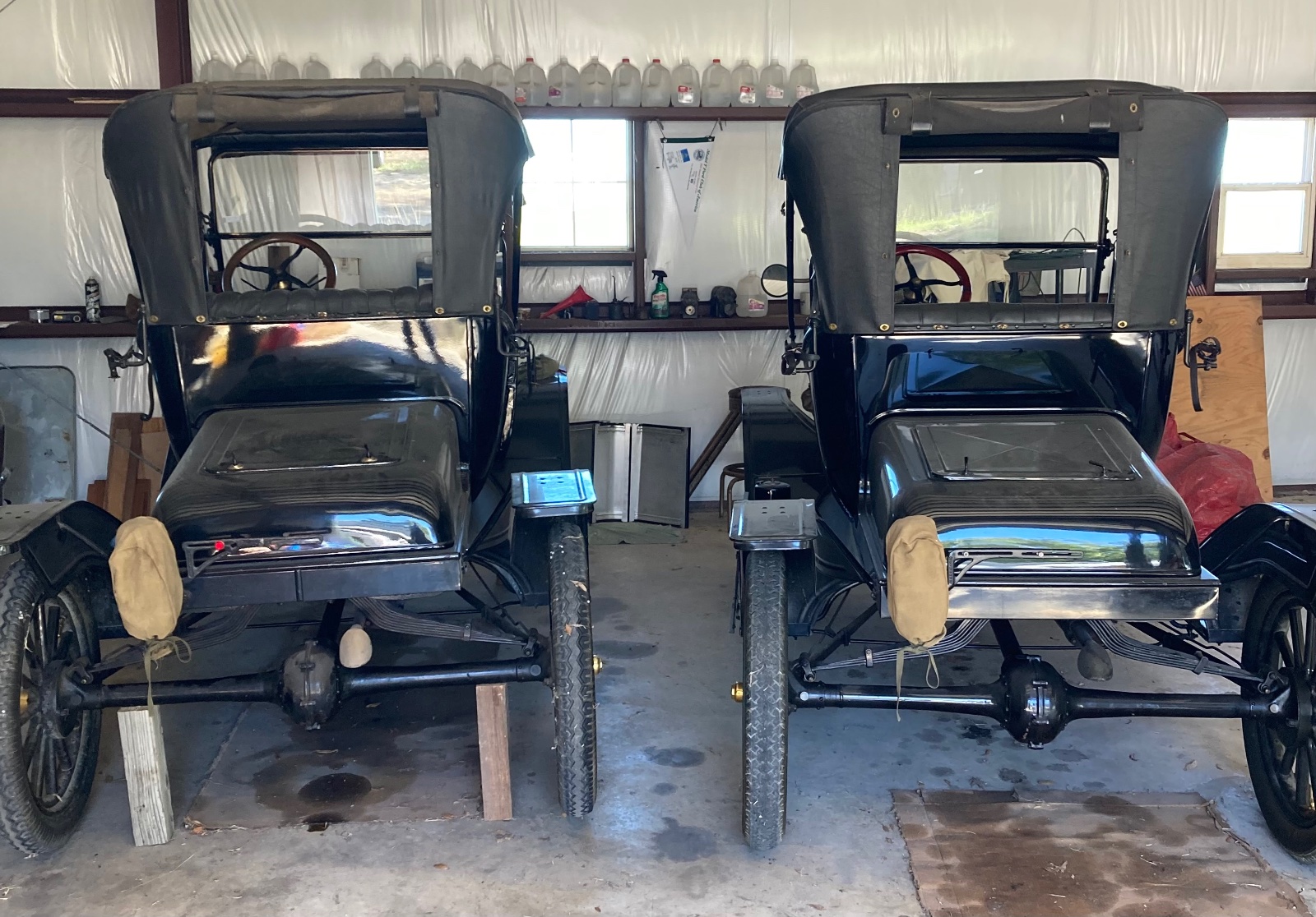

Nope… No seal on either of my ‘14 runabouts either
