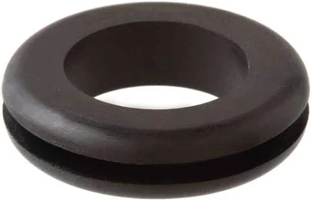

How about rubber grommets inserted into the holes & around the insulators instead of foam ? The size for OD, slot thickness & IDWill wrote: ↑Wed Aug 06, 2025 3:45 pmTo get ready for another assisted living show tomorrow morning I drove the T over to the gas station to fill up, I pulled up in front of the store and went in to pay for my gas and out of nowhere I got one of Florida's famous ten minuet deluge. After it was done I dried out the plug dips and started the car. It idled just great but when I went to move it, it was missing on more than one plug. I babied it home and It took it most of the way home to dry out enough to run on all 4. As long as I didn't give it very much gas it would run kinda smooth. What bugs me is I have a modern coil box kit plus I put neoprene washers on all the contact surfaces between the ceramic tubes and the plastic coil box backing so I'm not sure how the water got in. I do my very best to not get caught in the rain but once in a while its unavoidable. I wonder if I put some spray foam around the ceramic tube and the firewall it would seal out any weather. I wonder if maybe water got inside the timer somehow? Any ideas?

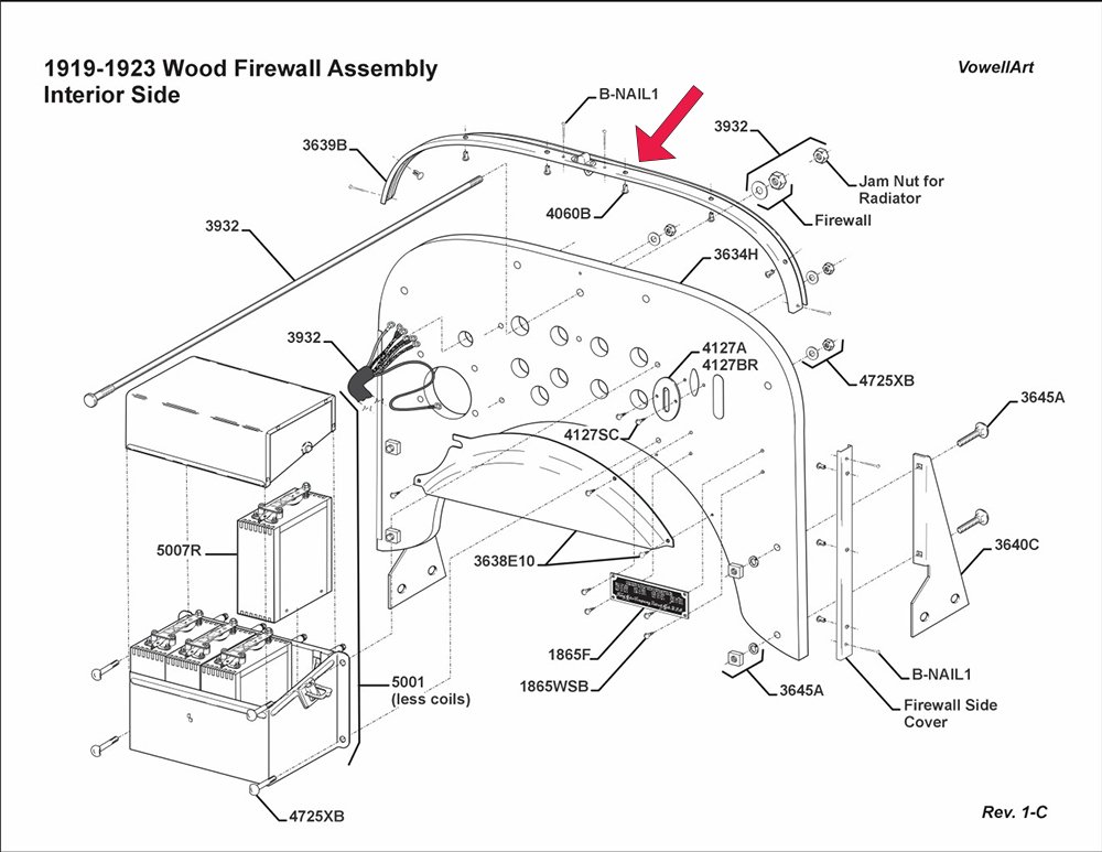

The rain gutters for wood firewalls were not available until 1919...I have a 1917 but installed one anyway. They show up now and then at swap meets. Below is a Vowell drawing showing the arrangement. The arrow points at the gutter.
Originally they used felt to seal between the body and firewall. Any suitable weatherstripping is probably a good idea.
You want to be careful plugging the holes that the ceramic insulators pass through. You will want to be able to remove the coilbox for service.
I did not block the insulator holes at all, but I did install a plastic coilbox kit. I've driven in heavy rain and my engine has never missed a lick. I suppose you might put some sealant on the seams between the box and the plastic back board. It would seal it but not be visible.
