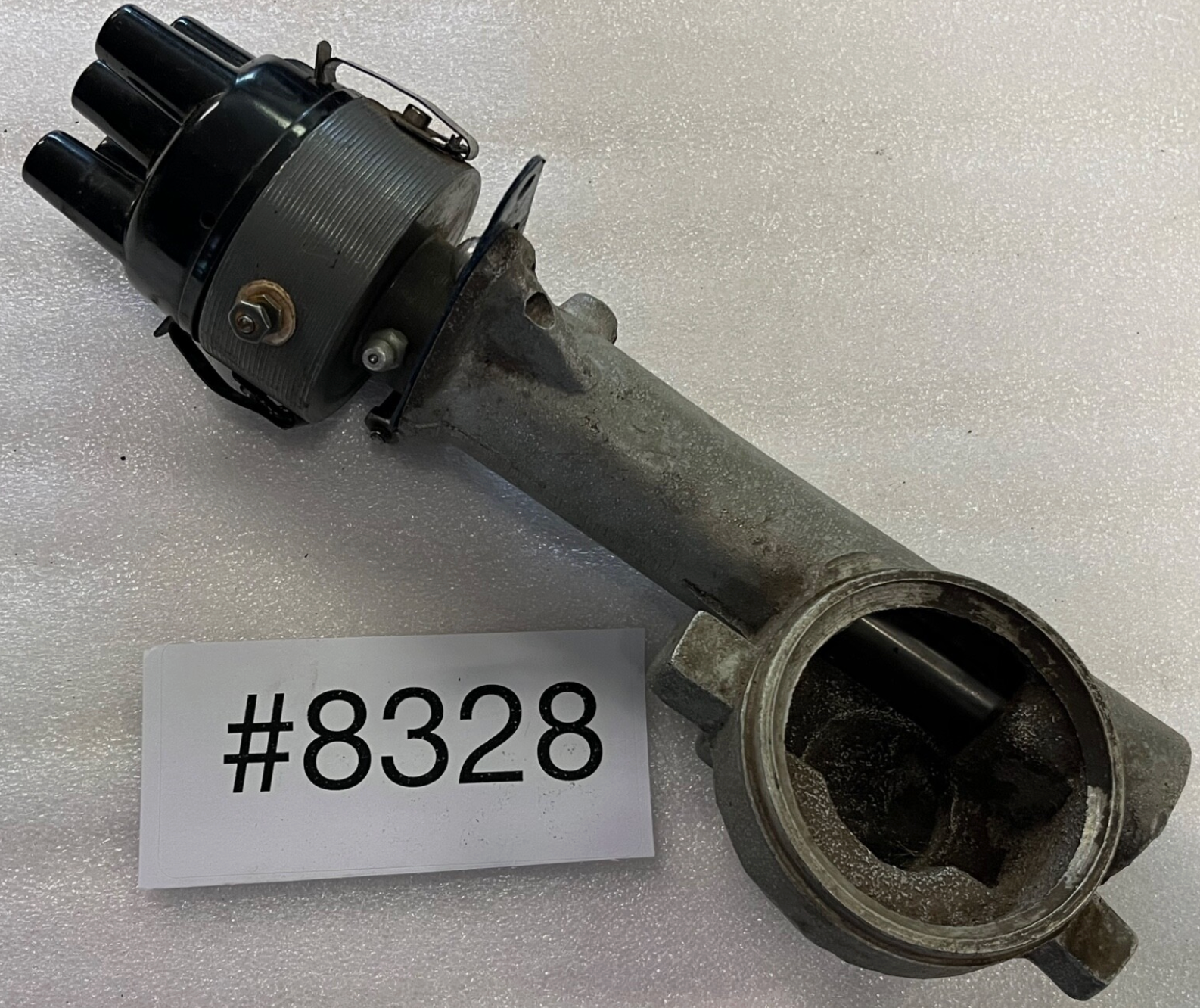

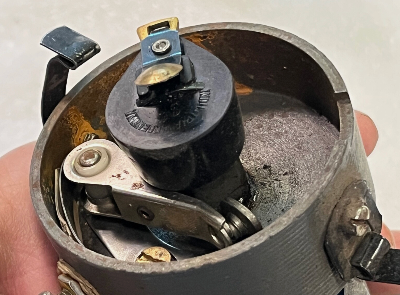

What make and model distributor is this?
Post by JZSlenker » Wed Aug 06, 2025 9:08 pm
Trying to figure out exactly what distributor this is.

Post by speedytinc » Wed Aug 06, 2025 9:53 pm
Looks like the cheap argentina unit from the 70's. Had one on my first T. I believe pinto points fit.
