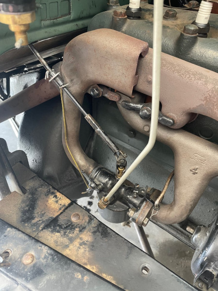

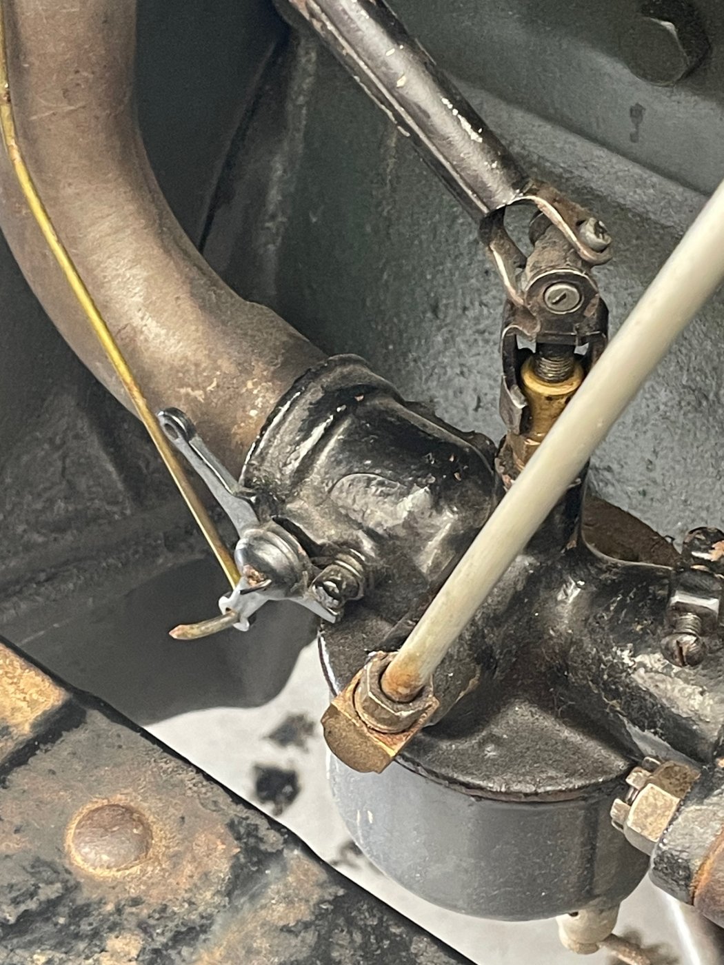

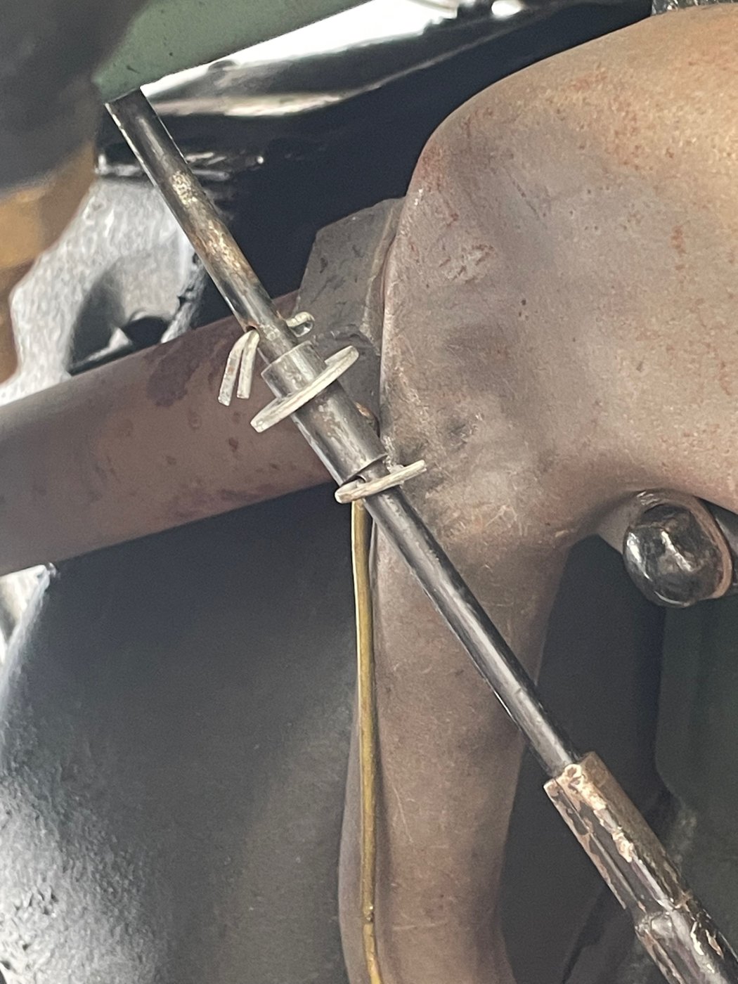

Okay, I am a newbie, but does anyone have a photo of an installed Holley NH, later model with the universal joint type mixture adjustment on their car? Mine doesn't fit well and I have another (new) rod that is supposed to fit that carb. I just want to know if what I have is installed correctly. I am most concerned with the point where it connects to the mixture/choke rod.
Thanks!
This is mine that I am trying to get correct.

The carb is pre 23. The throttle lever should be shorter.
The choke lever arms should also be shorter with an offset in 1 arm to clear the choke pull rod.
Fuel line routing is also wrong. Close to the manifold center.
The line runs straight down from the valve & 90 degree horizontal @ the inlet level.

You will need to get a similar set screw choke wire anchor on the rod and position it so it does not interfere with the hot air pipe when you turn the mixture screw... After that's done, just simply measure for another connecting wire between the pull and the carburetor choke lever

There was not a shaft collar originally. A cotter pin, as you have on the bottom is correct.
The pictured fuel line doesn't look correct either. The fuel line fittings are not correct.
The heat pipe (actually an accessory automatic choke) is also incorrect.
Don't use this picture if you want to be correct.
A correct pix will come along.

Those pictures are what are in the car right now. I just want to correct it.

Sorry, I thought that those were my original photos. Thanks!

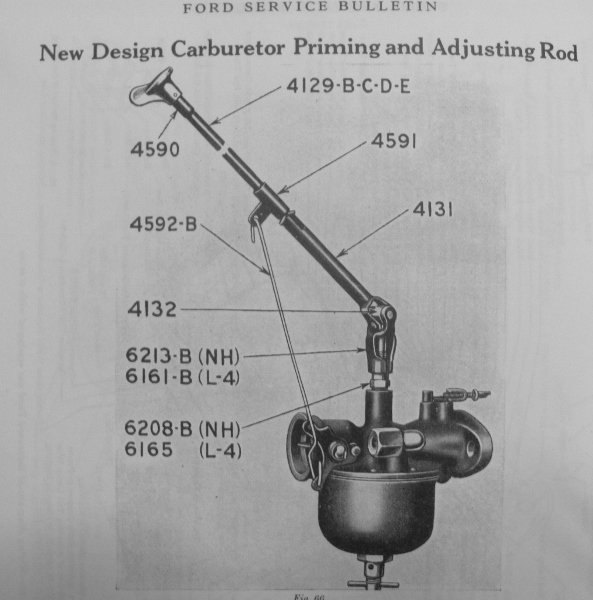

I just googled the following: mtfca model t 1926 carburator linkage.
There are the correct pictures of the improved carb linkage & fuel line run.

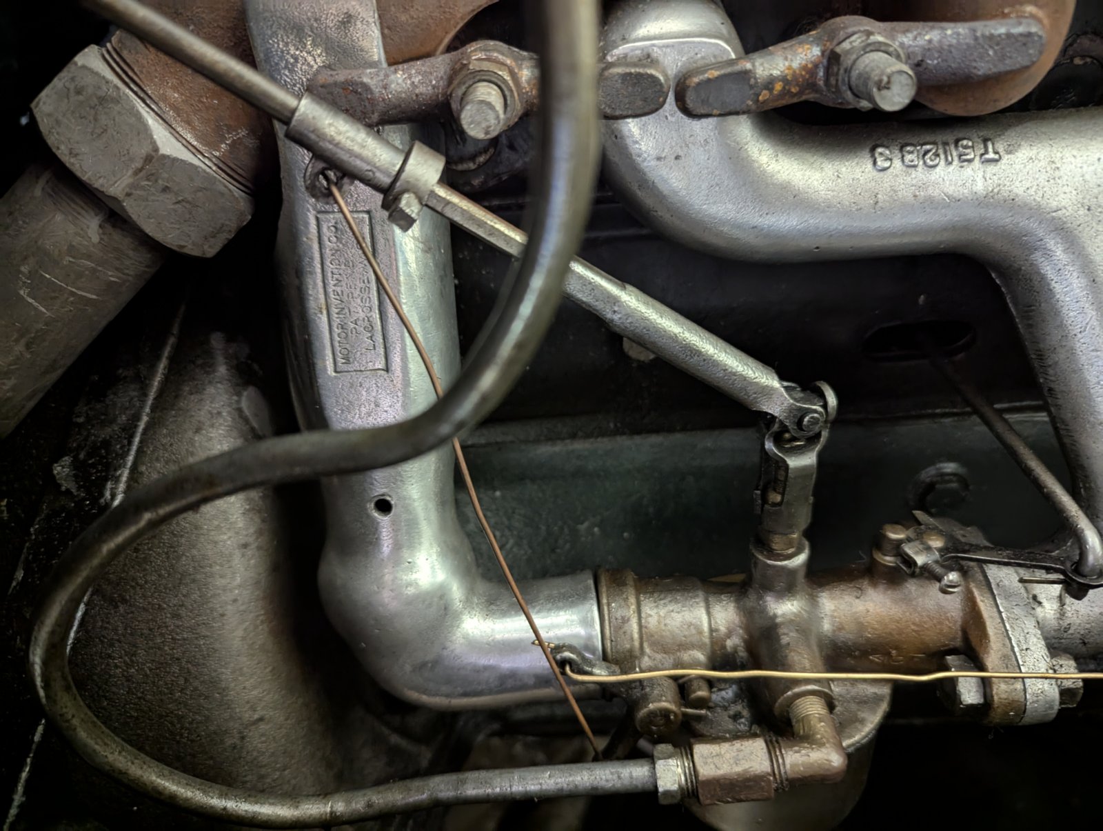

I "oogled" it and found the picture! mtfca model t 1926 carburator linkage and found this:
https://www.mtfca.com/discus/messages/5 ... 1448739372

Re: Holley NH Carb question
Post by Mike S » Thu Aug 07, 2025 6:55 pm
Moxie26 wrote:
Thu Aug 07, 2025 6:53 pm
Share the picture already. I can't stand the suspense

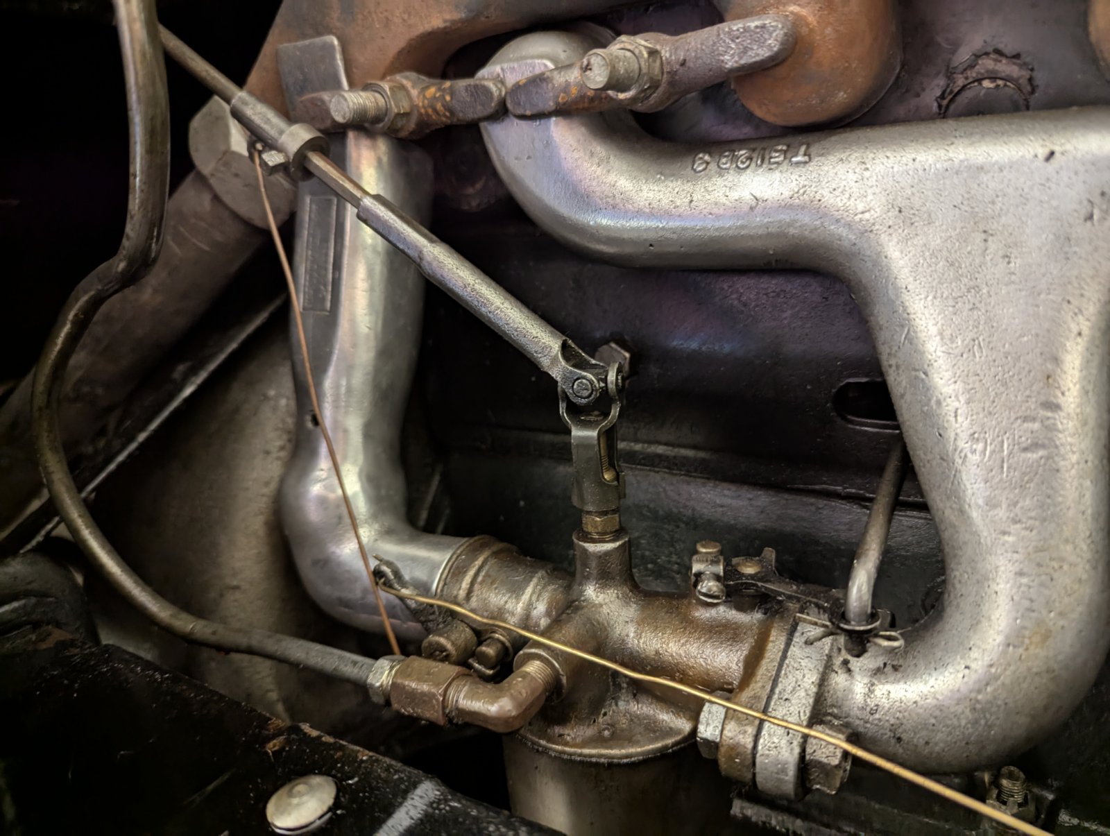

Holley NH.jpg (76.55 KiB) Viewed 2361 times

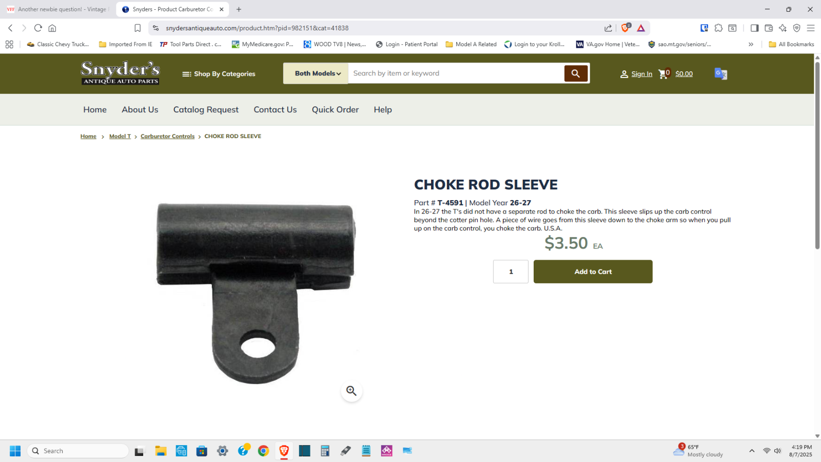

Evidenty I need this.

Looks to me you have that part. Its just turned 90 degrees off & has a washer over it.

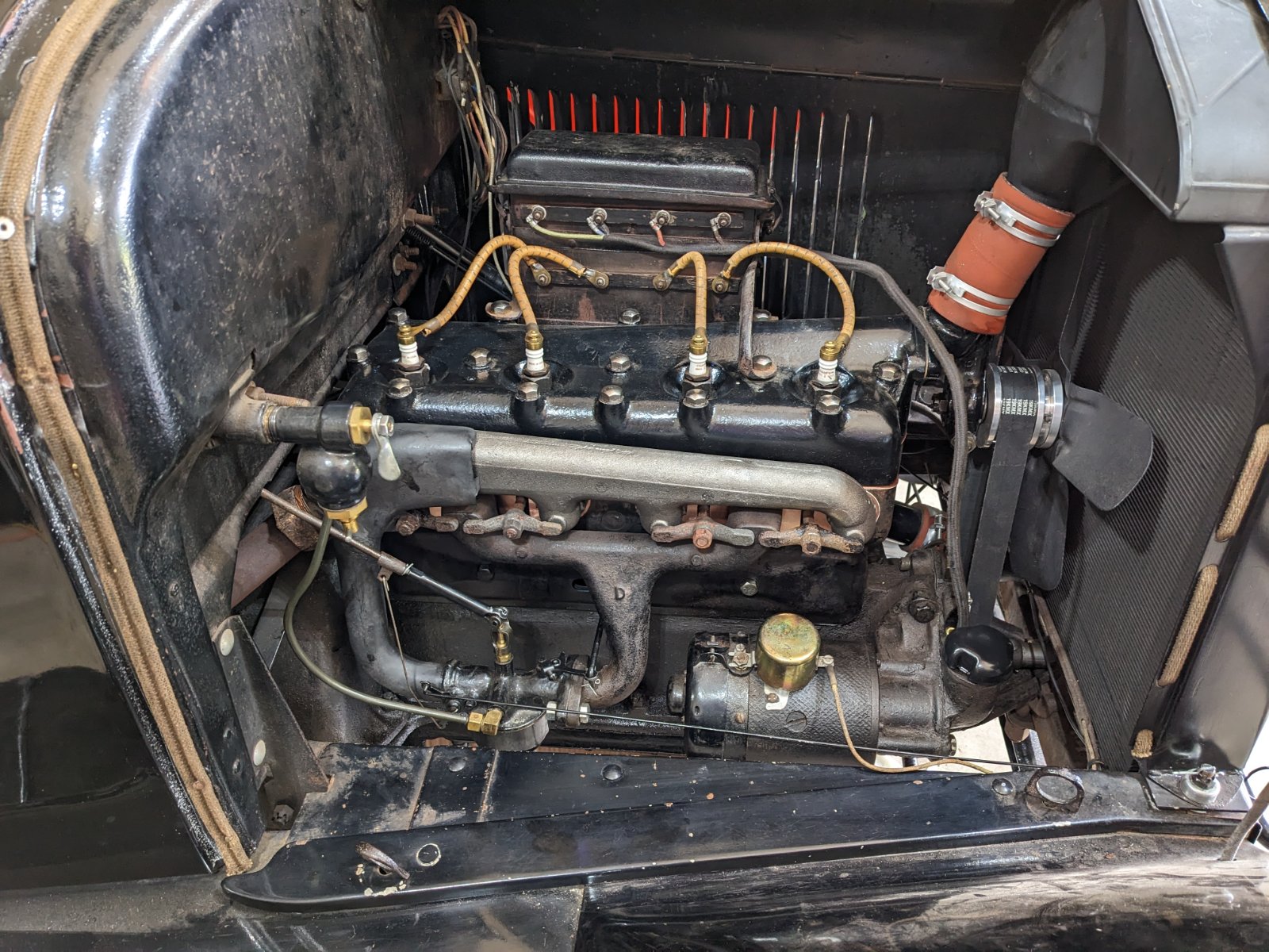

This is how I ran the fuel line.

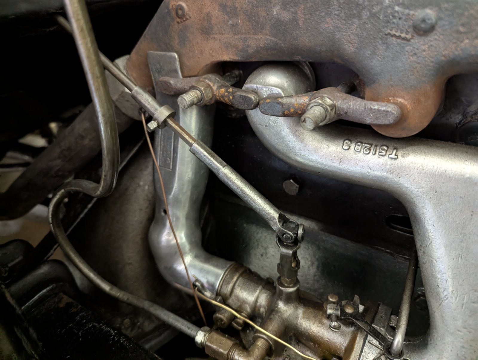

Posts: 5245
First Name: john
Last Name: karvaly
Location: orange, ca

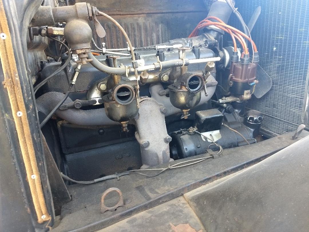

Post by speedytinc » Fri Aug 08, 2025 11:18 am
OP asked to see what's "correct."
I provided a previous post with pictures of the correct carb & fuel line.
Do not use my fuel line connection as an example, It is not correct either.
The difference is, I know it.

Hi John, I absolutely love the manifold, dual carbs, vaporizer exhaust. What is that casting? Allan with all that going on you noticed the
cutout?
Craig.

Apparently Speedytinc doesn't know what a 1920 straight through NH carburetor looks like, neither a 1913 Ford aluminum intake. The aftermarket hot air pipe has two circular vanes inside to start swirling the intake air and the internal valve was removed so it is a straight-through pipe. The gas tubing is one size larger than Ford supplied and can easily be replaced as long as the curvatures are replicated from original..... And thanks goes out to Allan and Craig, also to Mark for posting his picture, appreciated.

The exhaust casting is a mystery part found on tbay.
Fits the hot plate pattern near perfect. no gasket. I speculated it was from a knight sleeve valve motor or tractor.
