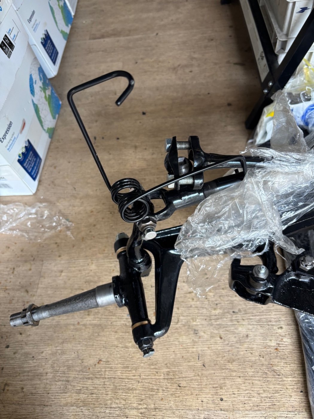

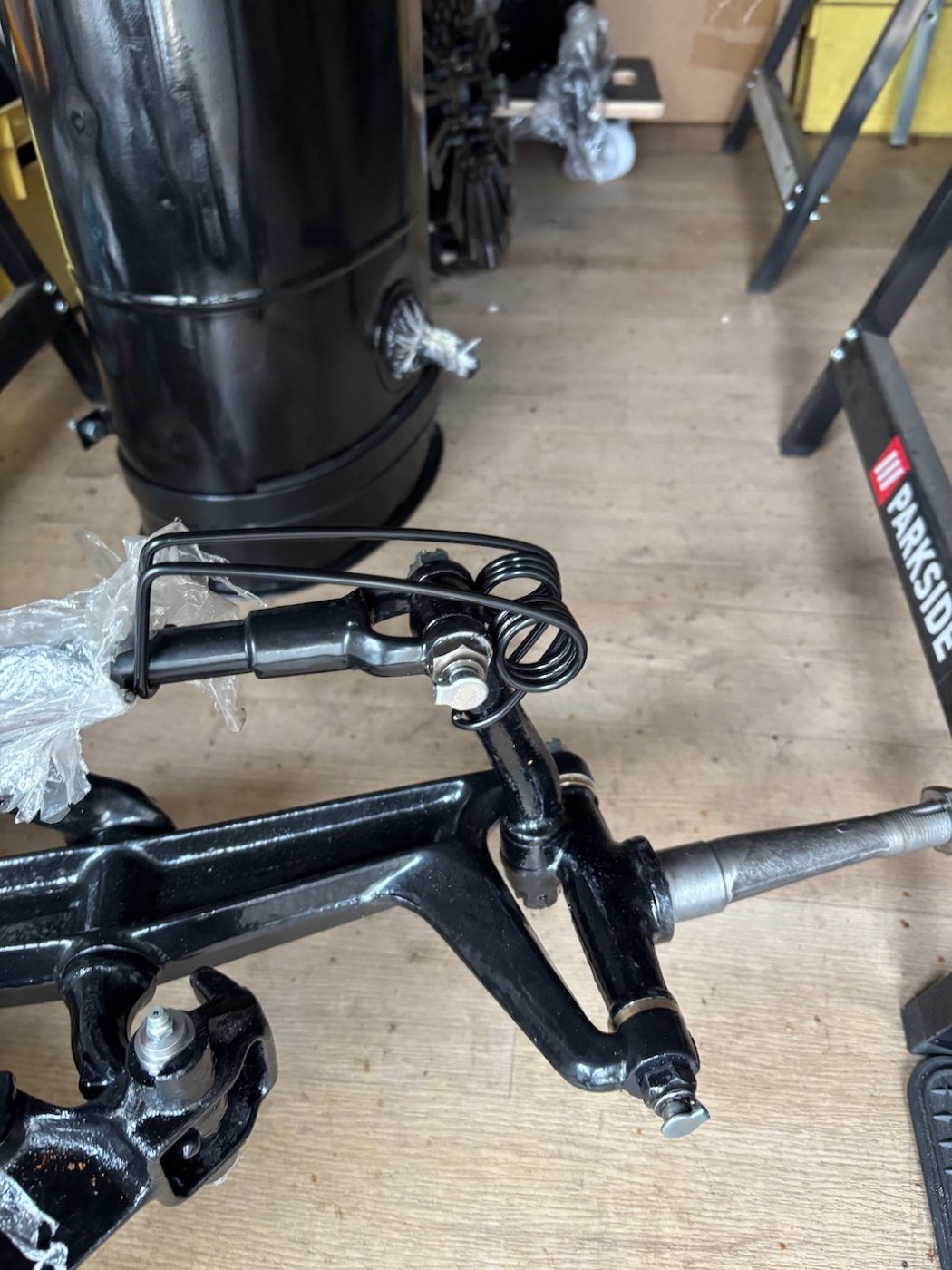

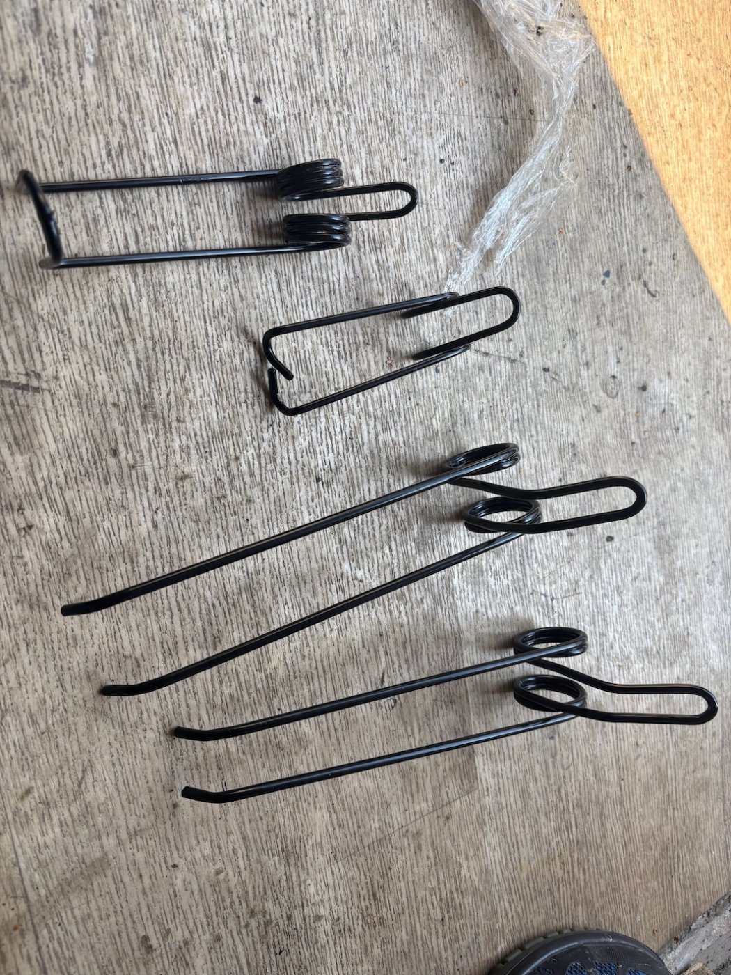

How instal the steering stabilizer spring on the right side on the front axle ? because the axle of steering hinder
Look 2 pictures of my car right and left and 1 picture of my parts

Here's how they did it https://www.mtfca.com/discus/messages/2 ... 1355089979
The "long ones" come in many different ends but install the same way

Those do not actually do very much to help with the steering. Mostly, what they do is if bushings and pins are loose, they reduce the intensity of the rattles. In some cases they might help steady things a little bit.

Not a steering stabilizer. Not a Ford part. Of the 15 million model T's, none left the factory with those installed. It will not improve driving or fix anything. Snake oil.

I agree with those who say that they are a band-aid. If there is something loose enough to cause steering issues, the looseness needs to be addressed, not covered up.

Those are anti-rattlers. They are a band-aid for worn steering components (bushings, tie-rod bolts, kingpins, etc.) but don't actually cure anything other than reducing noise.
They are one of the worst things you can install on the front end of a Model T Ford.
They create wear marks on steering system components, such as the spindle arm and tie rod. Over time, they can create deep grooves.

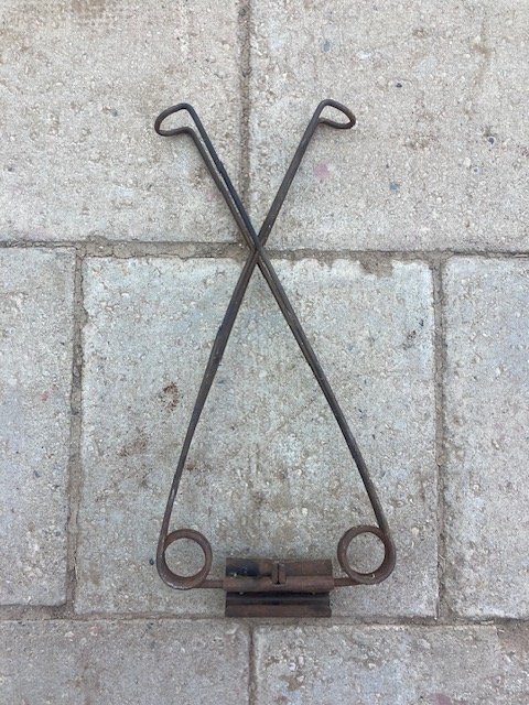

I think twice I have seen front axle assemblies that had grooves worn so deeply that the tie rod broke!
I had a spindle arm that was worn a quarter of the way through one side (less than an inch from the tie rod pin). One of the few original model T parts I sent to the scrap pile.
Yes they are an interesting bit of history. Really best to not use them on the car. They make interesting wall hangers and conversation pieces.
