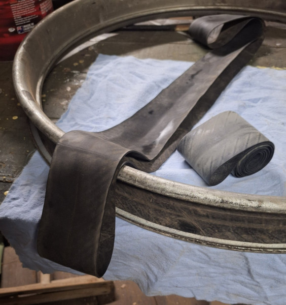

Here you go Steve. Not a $54 flap, snap fit rim liners cut from old 13-14" inner tubes, usually free from any tyre fitter. Give the waiting list a miss, unless of course you are looking for 21" flaps for split rims.

Bang on Steve. A set of five flaps will deplete your wallet to the tune of $270 plus shipping!
They also can make fitting tyres more difficult. I recently helped a friend in cold old Ballarat to fit a new Blockley tyre on his spare rim. Getting the old T driver off was not that bad, but things got a bit more difficult from there. Whatever they use to make flaps these days is not normal rubber. Rather than fexible, It's more like licorice. The flap as removed had moulded itself to the shape of the oversized T driver tyre and when fitted inside the Blockley tyre it presented with a considerable ridge of material protruding between the beads of the Blockley tyre.
This protruding ridge presented problems. We clamped the two beads and the valve stem in place and protruded to lever both beads on as usual. Each time we had to push the ridge of flap in between the bead edges before levering. The closer we got to the finish, the more stuffing we had to do. Thankfully, there were two of us. Warm weather would have helped, but sometimes you just have to do what is necessary.
With a rim liner, none of this would apply.
