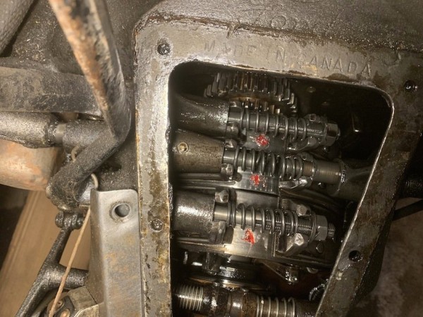

I engaged high with the lever forward and jacked up a rear wheel to rotate the low drum and don't really understand what I found...
Bit of grease on each drum to mark location

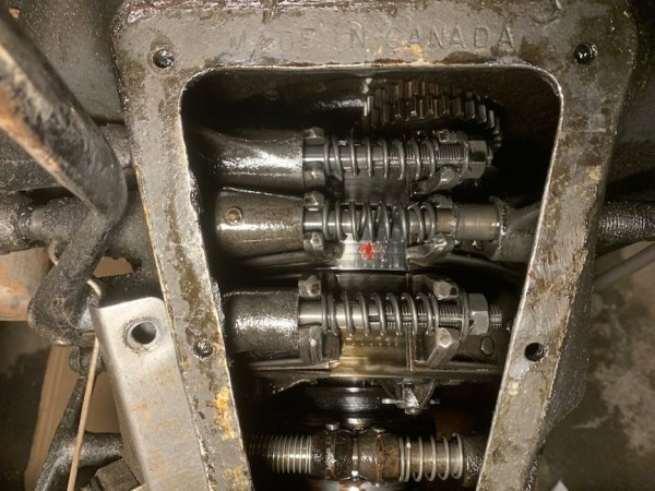

Turned the rear wheel a bit and the reverse and brake drums moved, but not the low speed!
So I just went back to the garage to check and yes, the low drum can be rotated separately from everything else, just by pushing the edge with a screwdriver. There was no obvious noise or roughness.

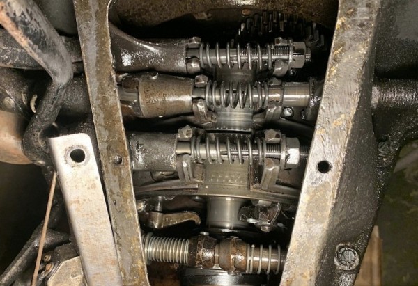

And for reference, this photo shows the low pedal engaged and the band ears clamped together
As near as I can tell, the drum and the gear teeth are no longer connected, That could only be what... all the rivets shearing off? A circumferential failure between the teeth and the drum? Both seem really unlikely, and inconsistent with a zero drama failure. I did re-rivet a low speed drum some years back, but don't remember if it was this car or the speedster.

If the gear teeth had gone bad, you would have a problem with all the gears. The gears would make a bad noise and only work in high, not neutral or reverse. I think either the rivets holding the gear to the drum have sheared, or the webbing on the drum has cracked all the way around.

I agree with Norm in that there is preggy good evidence the rivets have sheared. I doubt anything cracked on the drum, as the drum would both be off axis and would make a devil of a noise (and if it had made noise, I suspect you'd be directed ignore it, and to tear the rear end down...that's a joke).
With the rivets captured in place, the gear is spinning on a nice cushion of oil within the drum's round ID.
All speculation, of course. :?
Mike Bender offers a video that is very good on this subject and his method ensures good contact between gears and drum, ensuring no motion between the two parts can develop. I suspect if it is indeed sheared rivets, there will be some evidence of movement between the two parts that was going on for some time...let's hope nothing is Worn too far that one or both parts cannot be reused. If this is indeed the scenario, some rivets parted ways well prior to the final failure and you will likely have to dress up thrust faces on other drums if the rivets have scored them...let's hope they have not.

Thanks all for your comments, especially yours Scott. I expect it will be sheared rivets. So this likely the low drum I re-riveted some years ago. Oops.
