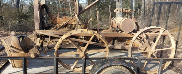

I've posted some pictures in the photo section under James, assuming I did it right. Would love someone to take a look and help me identify this thing. Serial number is so rusted I haven't been able to read it. I believe it's a mid 20's T with the truck conversion. But then there's an extra transmission, and I don't know what that even is. Really trying to find out what wheels and tires I need. It has the Ruckstell rear-end with large axles. Ignore the rear wheels as they are off an International pull type sickle mower.
New to all this, so if there is a better way let me know.

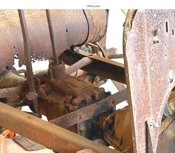

Your T chassis is a mid-1920s, the engine is a 26-27, has wide pedals, cyl head mount water outlet fan, the rear axle is from a TT truck, worm drive with accessory Ruckstell added.
That ton truck axle is hard mounted to a T frame, so it has that spring solo seat to manage the bumps.
In addition the shortened drive line has added transmission, not sure of mfg. , but likely a Warford.

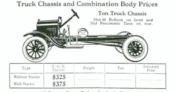

A set of tractor wheels would allow this set up to really pull in the low gears of that custom drive line. A typical TT truck is fitted with wood spoke hard rubber or pneumatic tires on split rims.
I added these close ups of 2 photos.

Thanks so much! I was beginning to think this was some weird collection of various parts, so that's good to know. Those steel wheels were just slapped on there so we could get it out of the shed it was in. Any ideas on what kind of wheels I should be on the lookout for? Found someone on Ebay that has a pair of 20-inch rears. Not sure what would match on the front though.

Depends on your plans for that homemade tractor of T and TT parts.
Original TT would have std for the years T car front wheels. Typical today easy to find front wood spoke 23” dia, with demountable rims using 30” x 3 1/2 “ clincher tires. The front wheel T hubs are easy fit to your axle spindles.
So finding pair fronts in good condition rather easy as lots of T’s around.
TT rear are larger axle hub taper, with spoke wheels in 20” or 32” dia. , (correct me if wrong,) but later TT used larger balloon tires, on demountable split rims.
Finding good TT rear wheels in good wood condition is much harder, and rims are rather pricey in nice shape, not to mention larger tires cost more.

James,… the easiest is to acquire a TT frame and rear springs. They’re fairly inexpensive and your ride will be much more enjoyable.You’re in Mississippi - there’s a lot of T and TT people there with parts. Yes, rear wheels, rims and tires are expensive. Your front hubs and rear hubs are different. I have lots of TT hubs, flanges, powder coated felloes and emergency brake drums I’d sell but then you’d need to have them respoked. Correction from above: TT rear felloes are either 20” or 23”.

Trans is definitely not a Warford. Probably adapted from some other car make.
