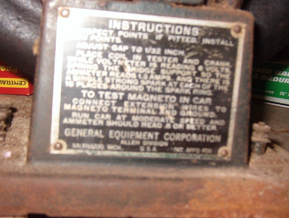

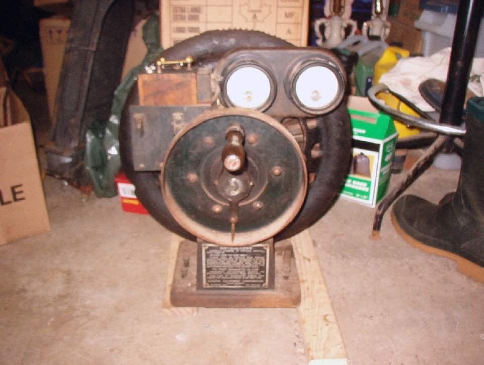

Thank you for all of your hard work and your generosity in making this document available. I have an Allen HCCT which I purchased several years ago (about 1962) from a shop that had been in business for many years and agreed to sell me the tester and some misc. T parts that they still had in stock. It works and I have never had to do anything to it. I will put a copy of your manual with the tester so that whatever family member ends up with my T and the tester will have it as a reference if it needs repair at any time. My youngest grand-son, as a child, was fascinated by the sparks produced and still enjoys demostrating it to his friends. Thanks again.
