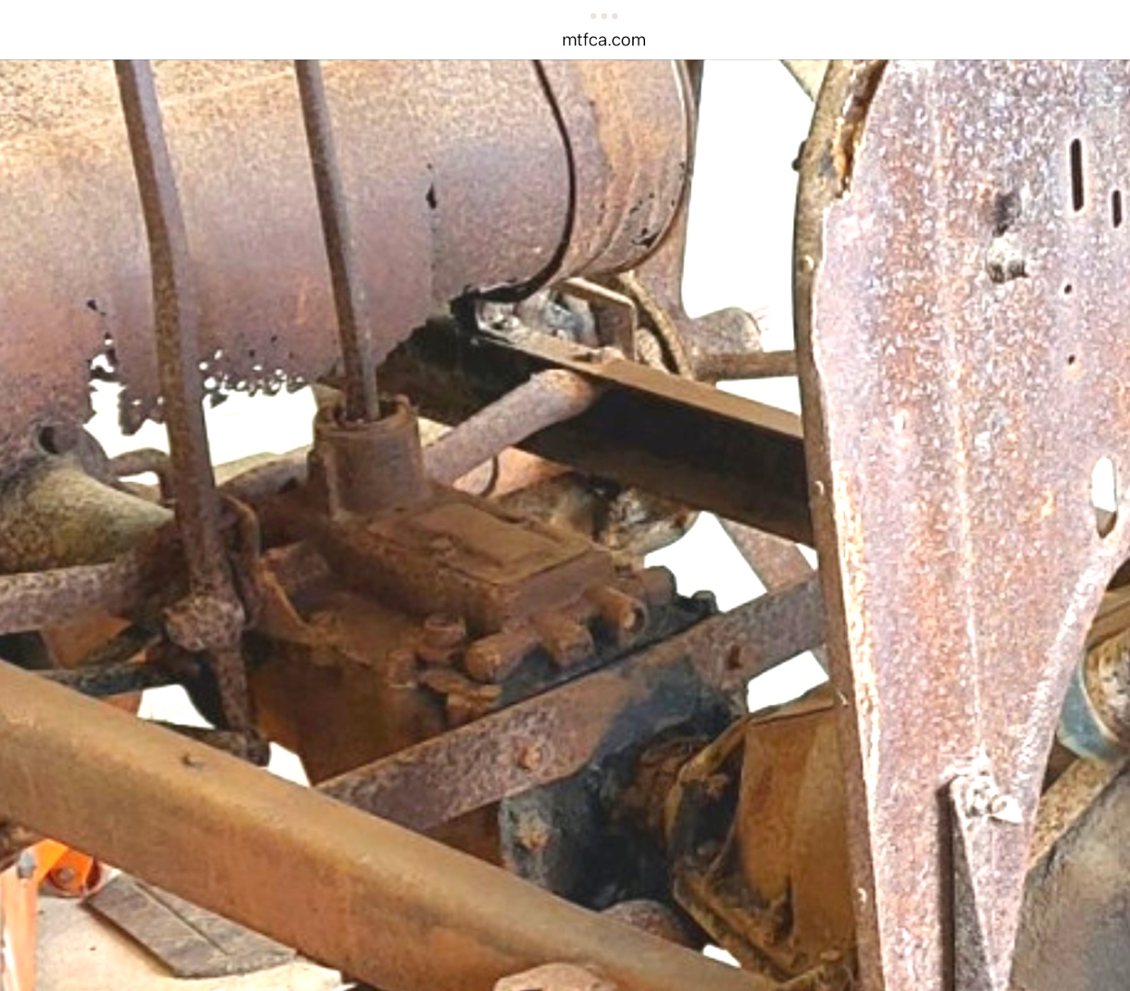

I've posted some pictures in the photo section under James, assuming I did it right. Would love someone to take a look and help me identify this thing. Serial number is so rusted I haven't been able to read it. I believe it's a mid 20's T with the truck conversion. But then there's an extra transmission, and I don't know what that even is. Really trying to find out what wheels and tires I need. It has the Ruckstell rear-end with large axles. Ignore the rear wheels as they are off an International pull type sickle mower.

Your T chassis is a mid-1920s, the engine is a 26-27, has wide pedals, cyl head mount water outlet fan, the rear axle is from a TT truck, worm drive with accessory Ruckstell added.
That ton truck axle is hard mounted to a T frame, so it has that spring solo seat to manage the bumps.
In addition the shortened drive line has added transmission, not sure of mfg. , but likely a Warford.
A set of tractor wheels would allow this set up to really pull in the low gears of that custom drive line. A typical TT truck is fitted with wood spoke hard rubber or pneumatic tires on split rims.
I added these close ups of 2 photos.

Trans is definitely not a Warford. Probably adapted from some other car make.

Its a garden tractor. Car chassis with a TT axle for lower gearing.
The extra transmission for additional lower gearing. It needs iron tractor wheels similar to what you have shown.
Putting T wheels to turn into a TT truck? Its way cooler as a garden tractor.

We were wondering that! Guy that my friend got it from didn't know much of the history. We couldn't really figure out how they pulled anything with it. It will have a lot of reduction with another 3 speed though. He wants to weld the sickle bar wheels to some hubs and use those. I'm not really convinced, but this is a beater project anyway. I'll feel a lot better once it's running.
