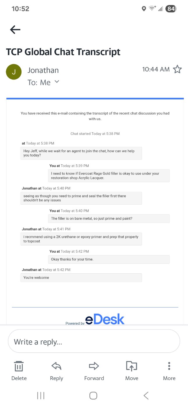

This is what TCP coatings told me
Still digesting all this. I have a few weeks of stuff to do first.

big2bird wrote:
Wed Aug 20, 2025 1:54 pm
Kinda like a Politician's answer, ....huh.??.
Geez, there is not a thing wrong with spraying Epoxy primer over the top of the substrates to act as a Sealer, ....except you just spent many hours blocksanding to 400, -or 600 grit only to find yourself priming with Epoxy that now has left a slight orange-peel texture -thus now that Epoxy sealer has hidden all of your smooth substrates. And you know that won't show in your topcoat providing you add a couple more coats of Lacquer paint to get the topcoat mil thickness up there. Paint is cheap these days, so why not just put enough on where you can spend long hours Colorsanding it back off to get to a flat surface. ;)
