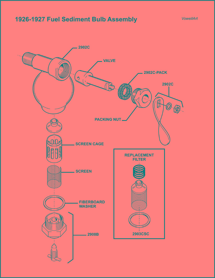

Here is a breakdown of the sediment bowl. It has very fine screens in it that can get blocked up and it will need to be taken apart and cleaned.

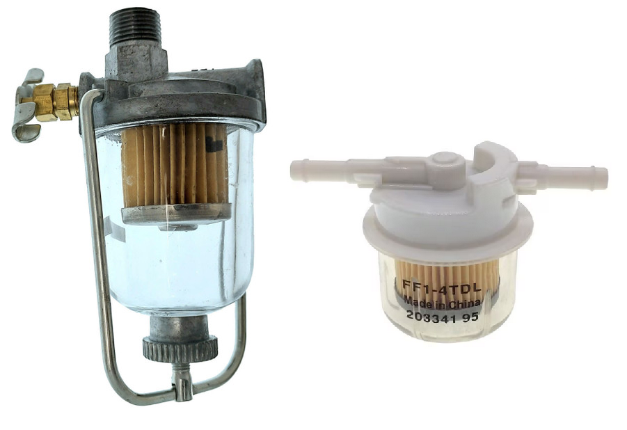

I would consider using one of these. $7.50 at Langs.
Item #2903CSC
Item #2903CSC

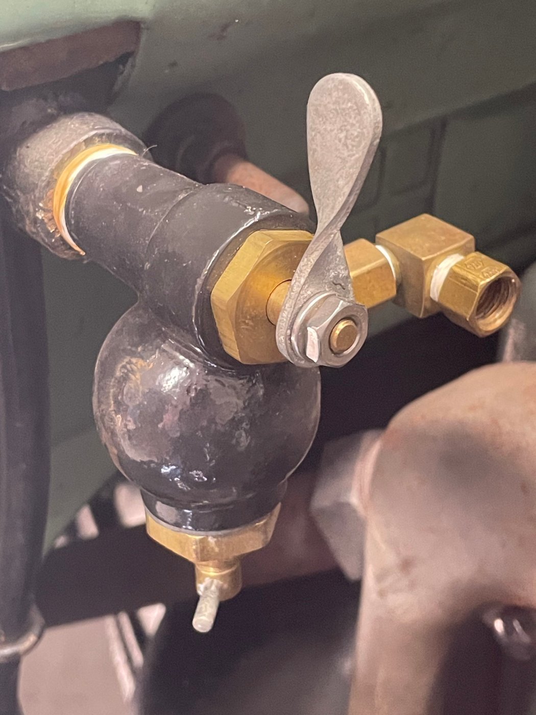

I'll follow the advice to see what I can accomplish. I am assuming that the bottom of the bowl has a gasket. If I remove it, would I need to order a new gasket?
Can I just unscrew the bottom drain plug to see what comes out?

Buy the new sediment screen from Lang’s and a new gasket. Do as mentioned above and hope that takes care of it.
Order tomorrow for peace of mind and do it.
That’s where you start from and see if it helps and if it does you solved your issue.

You might consider using the correct Ford elbow from the sediment bulb too. It would look much better.

Update. I removed the screen from the sediment bulb and oh wow, was it ever clogged with rust. I did a lot of research and advice from OilyBill. After researching the methods of rust removal, I bought 10-gallons of Evapo-Rust and put it in the tank after draining the tank. There was a fair amount of rust while draining the fuel tank but now, hopefully this stuff will clean it. It has been in the tank for roughly24-hours and I will drain it tomorrow.
So, the next question is whether there is a residual film that I should get out of the tank before filling with fuel. OilyBill said to mix alcohol and water and flush it. Since the tank remains installed in the car, I just want to make sure that it is good to go.
By the way, the Evapo-Rust ate all of the rust from the screen without damaging any of the parts. Seems to be a great product, but expensive.
Anyone with any ideas about how is the best method of flushing the fuel tank.
I do not use anything but ethanol free fuel as ethanol attracts water and is horrible for any motor.

Save that 10 gallons to reuse. Mine lasts about a year of dipping parts
Flush evaporust with plenty of water to remove any film.
Just let it air dry outside a few days days. Blow some air thru it.

I believe Evaporust is flushed out with water. Go ahead and flush your tank a few times with water. Then use a can of denatured alcohol to get the water out. A pint should be enough. You do not need a whole gallon. Let it sit an hour and then drain. Then fill with gas.

Do you want it correct? You need the original elbow from the bulb, and need to fashion an upside down question mark gas line to the carburetor.
