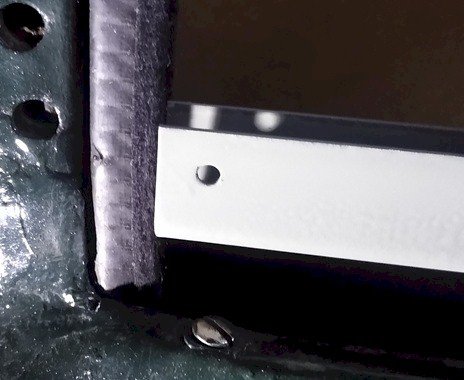

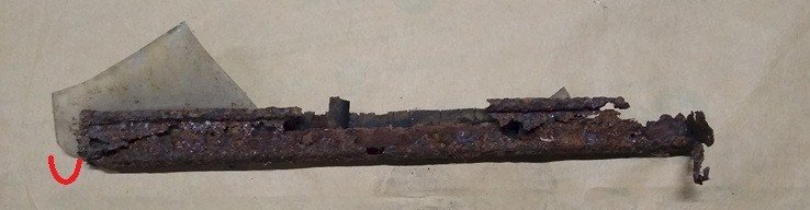

Question 1: First three photos...the lower glass channel is physically too long to fit. My original shows glass protruding past the channel. How long should it be?

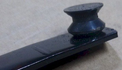

Question 2: Photo 4...the knob on the reproduction regulator does not spin. Is it supposed to roll or merely slide?

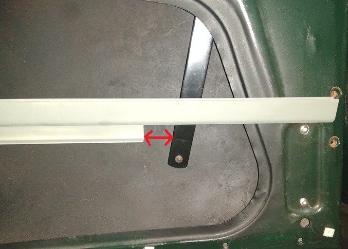

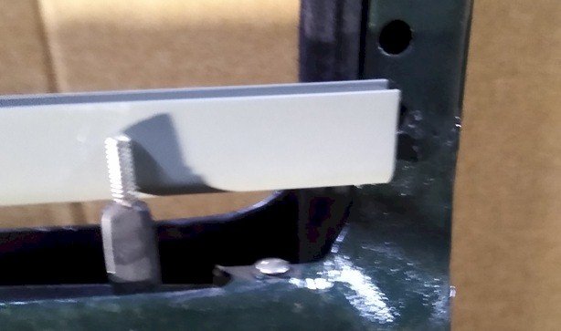

Question 3: Photo 5...the channel for the "roller" (not the channel for the glass) does not extend all the way to support the knob when lowered. When I shorten the channel, should I cut all the excess from the A-pillar side?

From what I can tell from the remnant of the glass in the channel, the glass extends 5/8" passed the end where the glass interacts with the fuzzies. So, both sides combine to 5/4". Original glass is cut to 25-1/2" wide at the base. However our laminate is cut to 25-1/4" to fit the reproduction fuzzies. It follows that the channel should be cut to 24" even. 24" does indeed fit between the front and rear fuzzies without contact.

Last answer, #3. By moving the regulator to the lowest position, it is also closest to the A-pillar and rolling the window up until it is exactly horizontal, gives us the rear most position. In my case, cutting the excess completely from the A-pillar side on both driver and passenger doors, places the channel in support with the roller through out its travel.

I can answer question #2 (picture #4)
Having worked on several original, repro, and repaired ones I have never seen one that rolls.
The rollers were riveted solid to the arm and are supposed to slide in the channel, so add a dab of grease when finished assembling.

The brass roller is supposed to rotate. They do on my Centerdoor.

I have a '22 Coupe and the brass roller turns freely along the track so I would guess that your roller should roll and not be in a fixed position. Sliding a solid metal piece against another solid metal piece would cause one to wear a flat spot or hole in the other.
