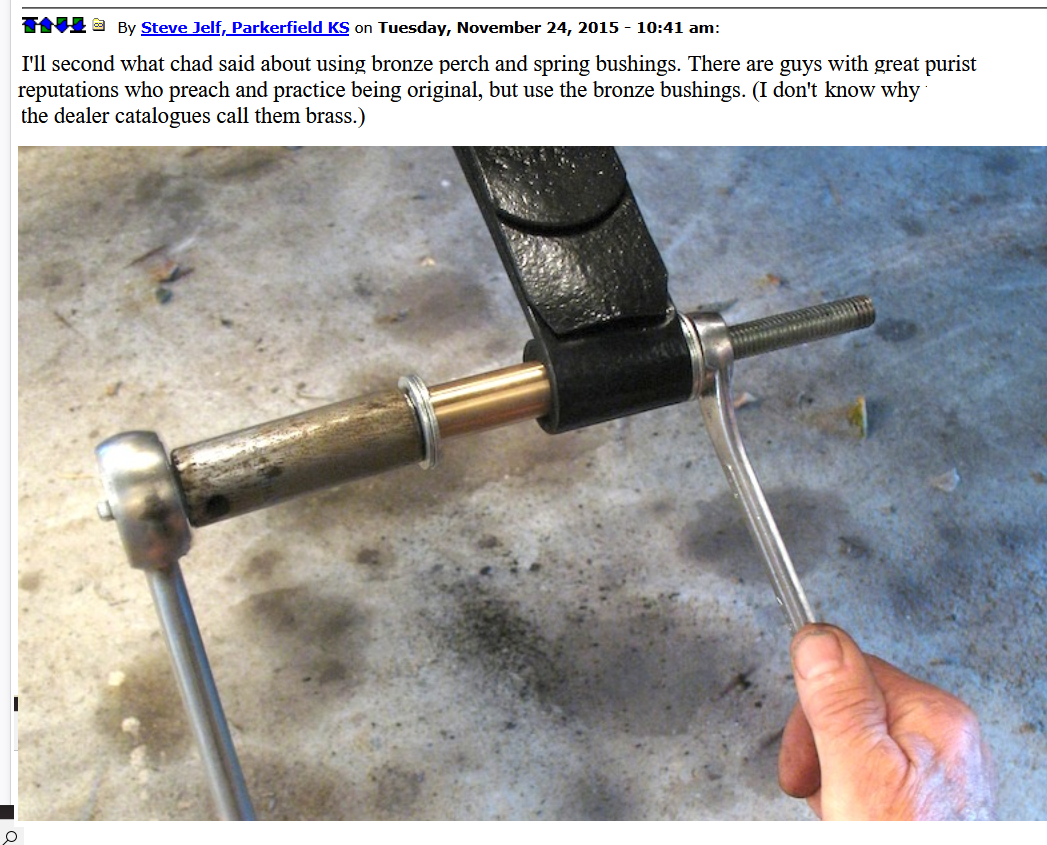

This method works like a charm for removing bushings (even getting them in). The socket just needs to fit the ID of the spring & the OD of the bushing.
Rear spring restore
https://modeltfordfix.com/repairing-the ... ar-spring/
https://mtfca.com/phpBB3/viewtopic.php?t=30689
Rear spring restore

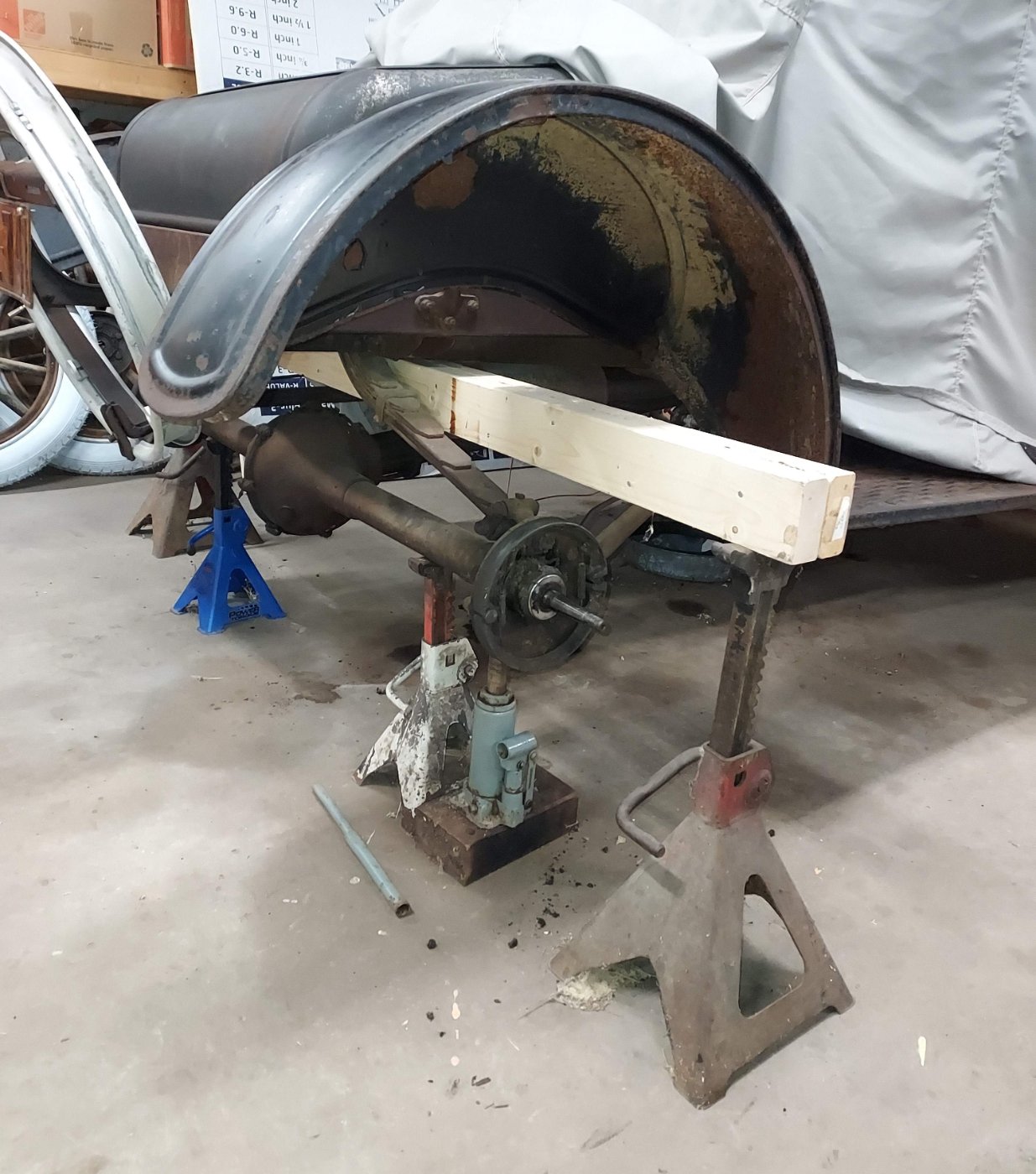

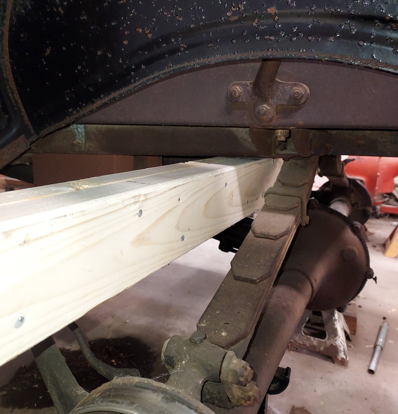

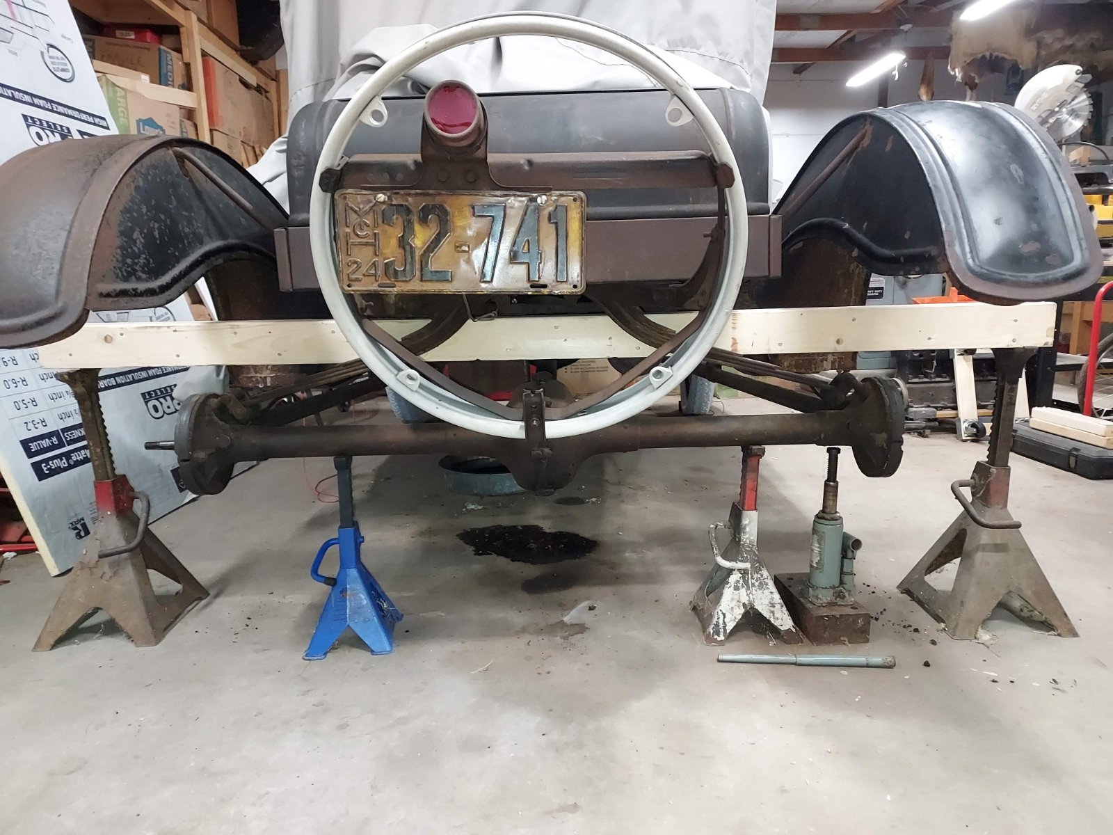

Here is how I jack it up to relieve the spring tension.

A bushing driver works nice. You may need to ream the bushing to fit the shackle. I would suggest brass, not a steel bushing.
