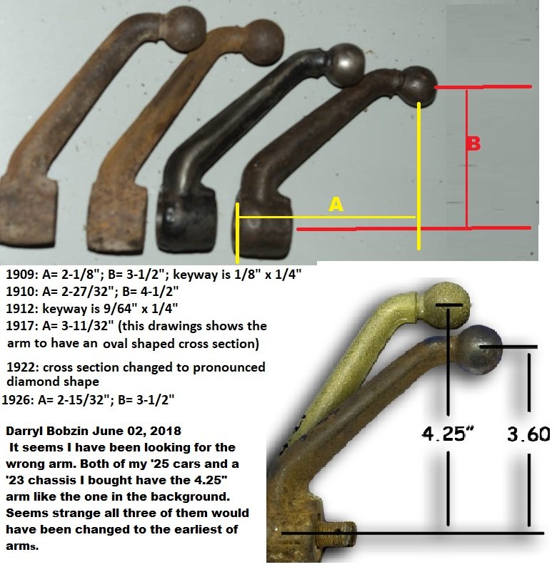

Iam not certain that the cross section observations are definitive. When rebuilding balls on early pitman arms I found differing cross sections depending on the various manufacturers, DB, TW, CH etc

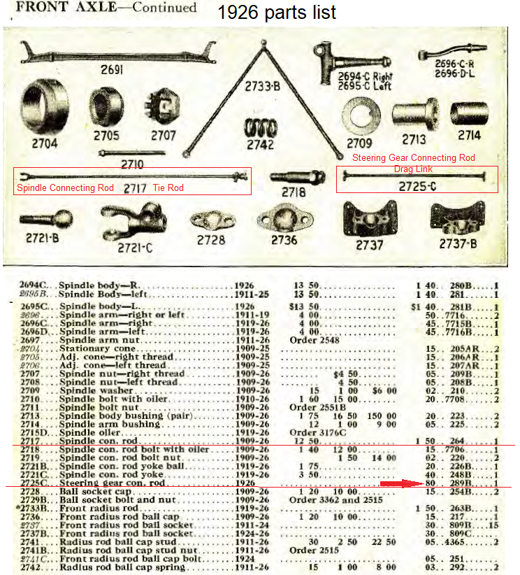

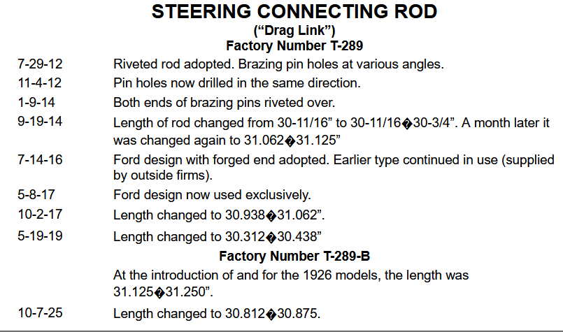

What you are calling "Tie Rod" are the "Drag Link" lengths
From the MTFCA Encyclopdia
From the 1926 Parts List

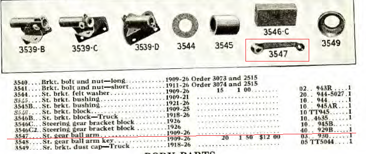

From past discussions about Pitman Arm (Steering Gear Ball Arm)

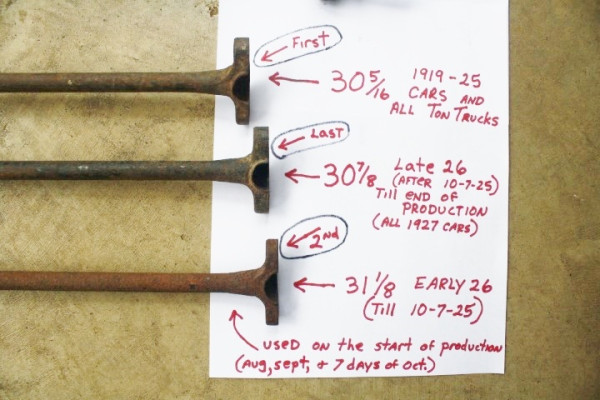

Made this quick chart for the later steering gear connecting rods (drag links).
Helpful for the later Ts. These are all forged ended Ford design.
