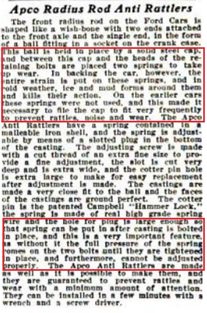

Found an ad for the APCO Radius Rod Anti Rattlers and a few other of their products. I enlarged the Radius Rod text. In reading it is seems to indicate that the springs holding the original cap in place were a cause of wear when backing up .... and their design eliminated them.

Thanks Frank.
That seems to pretty conclusively show that the springs are not to be used.

Post by Mark Gregush » Wed Jul 31, 2019 11:41 am
Yes it sure does, thanks for finding the ad. Murray's book is mum on the subject giving very little info. For now mine is staying the way it is. ;)
