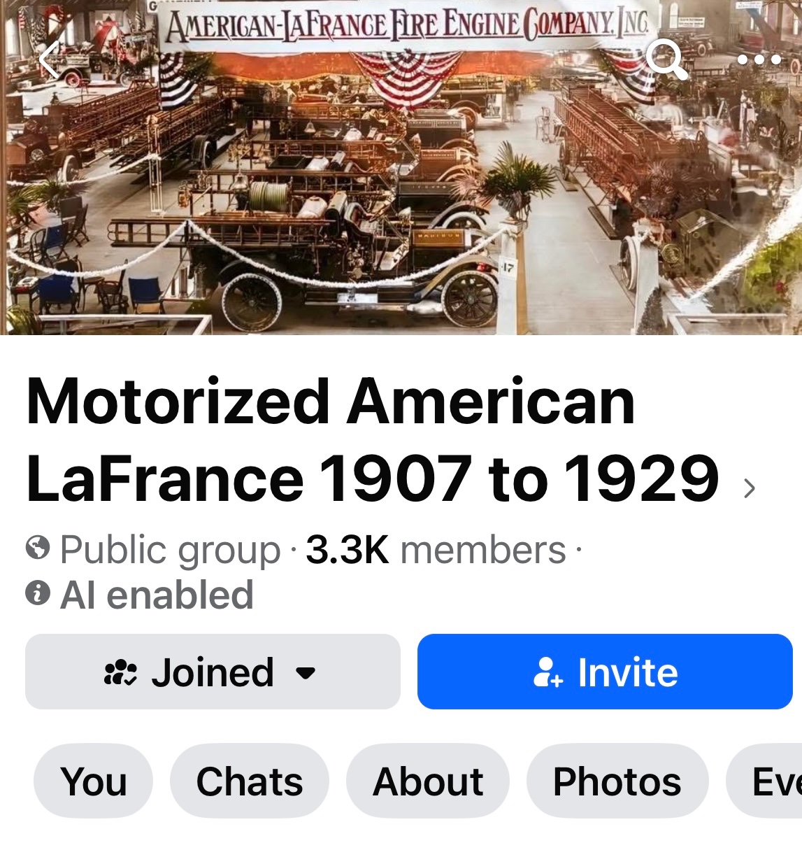

- Posts: 4082
Re: Not a T Model subject but I am hoping...
Might try if you haven't already the Facebook group on ALF fire engines.
Easy to join, and ask questions. If you click on the oval icons shown, one not shown on the right is named FILES.
That has the complete manual on 1924 ALFs in pdf format. Screen shot partial on the starter motor.
