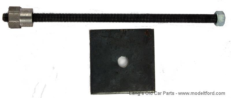

They make a puller for that purpose or you can try to carefully drive it out. I tried to drive it with my drive shaft (which I was replacing) and sheared off some of the rivet heads holding the ball on. I was able to replace them but it made what looked like a simple job much more complicated. Langs sells a puller for $27 - maybe someone on the forum will read this and offer to loan you one. I would but I don't have one.

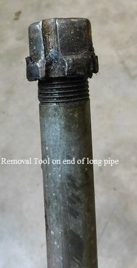

I believe I built mine from a tinkering tips manual. It consists of a 1/2" pipe cap machined a bit to fit into the base of the bushing & 4 wide notches to clear the rivets. The cap is screwed onto a pipe one foot longer than the drive shaft. Carefully align the cap to clear the rivets & hit the end of the pipe. Very effective. Be sure to clear the rivets. If you shear those rivets, you made a whole lot of extra work to fix, to the point of being easier to start over with a second D.S. tube.

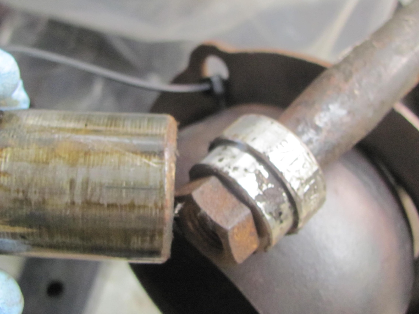

DIY tool https://modeltfordfix.com/rebuilding-the-drive-shaft/
The tool is made from 1/2″ galvanized pipe, a piece that is 60 inches (5 feet) long. 1/2″ water pipe measures .840″ on its outside diameter, the size designation refers to the inside diameter. The cap measures a little less than 1 inch outside diameter at its smallest dimension – perfect for our tool.
The notches need to be deep enough & wide enough to clear the rivets. Insert from the spool end
- Attachments
- Drive-shaft-bushing-remover-tools.jpg (36.22 KiB) Viewed 3002 times

Yea, thats the tool.TRDxB2 wrote: ↑Sun Aug 24, 2025 2:42 pmDIY tool https://modeltfordfix.com/rebuilding-the-drive-shaft/

On my removals, I have an old steering post, the end is tapered, no fear of hitting torque tube rivets. To the threaded end added a std. bushing driver, from a China made set of bushing drivers. Nut fastened to the pitman arm threads.
A whack with my favorite Model T tool takes it out!
